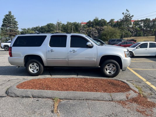

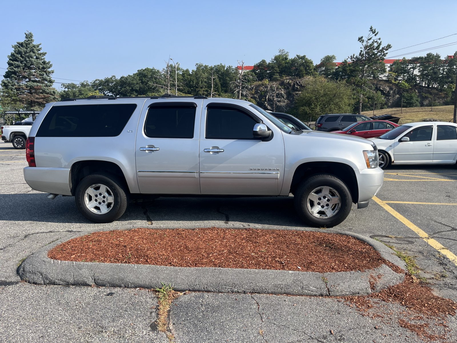

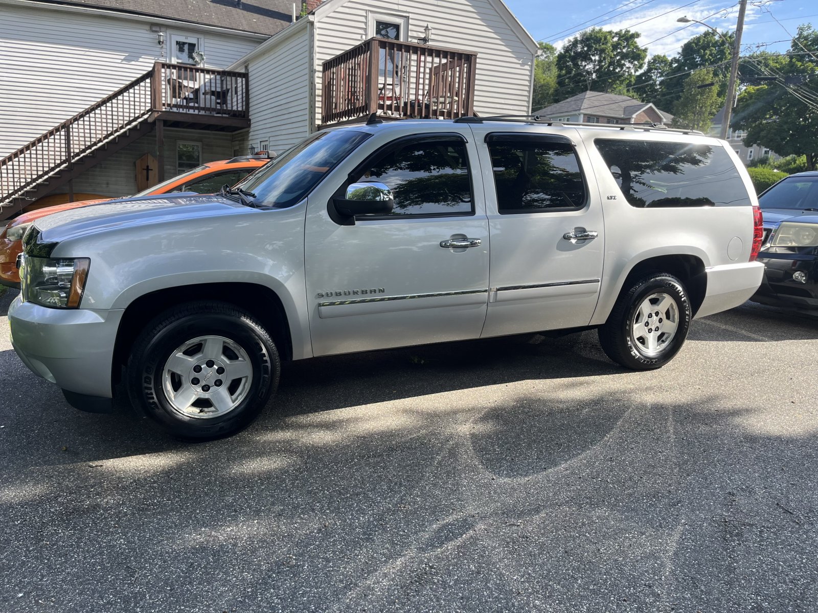

So I finally installed the suspension. 2013 suburban and removed the electric and air suspension and installed Eibach pro truck leveling suspension with moog hd springs. Got about an inch in the rear and 2 in the front. Do we think 285/70/18 (33.7) will fit without major issues or major trimming? Thanks in advance. Pics are from before and after level

I'm going to SWAG it and say that it should fit, based upon my experience with a 305/50x20 tire and your achieved lift.
