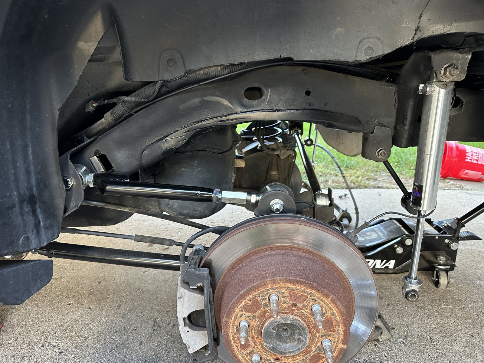

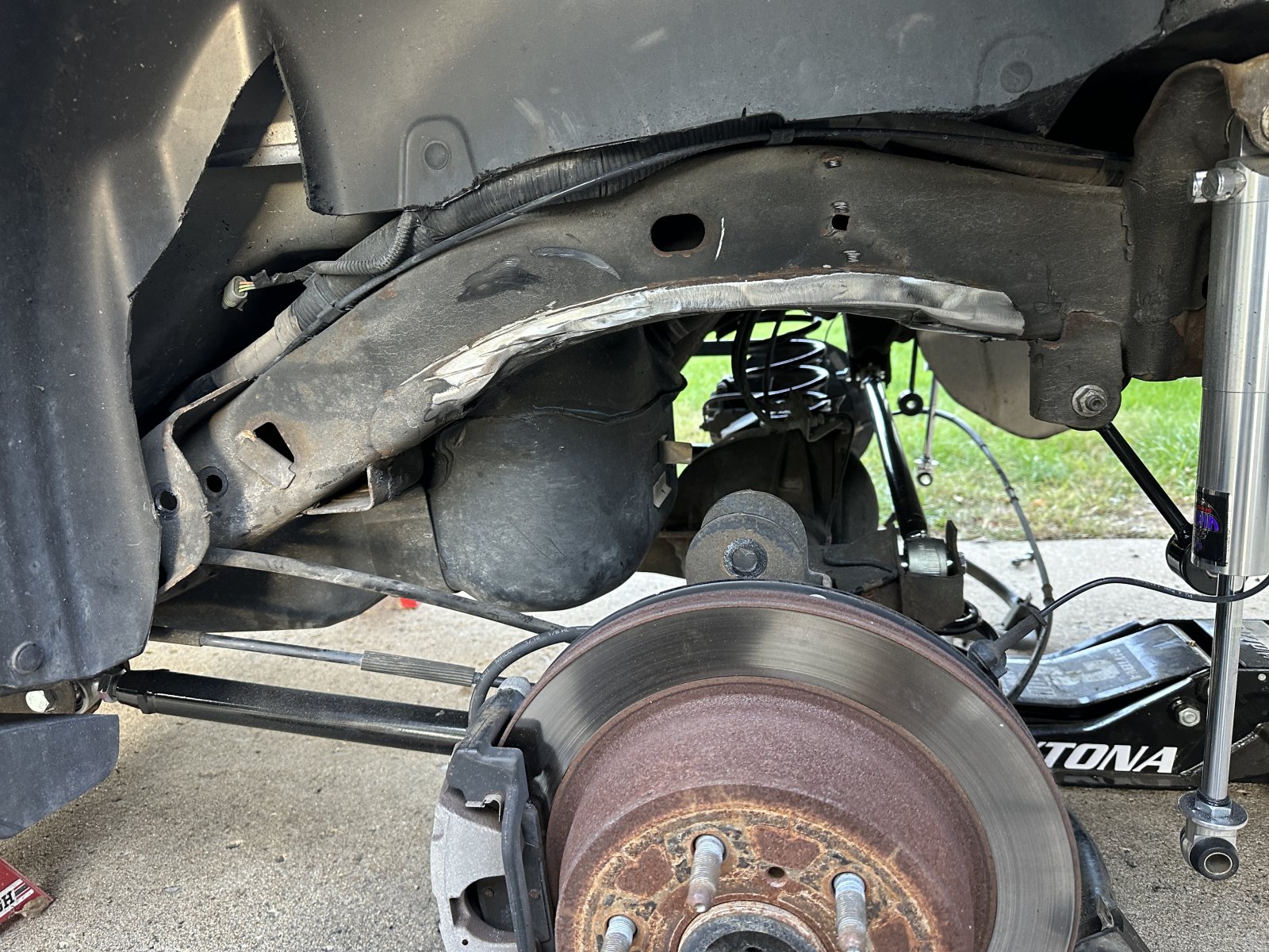

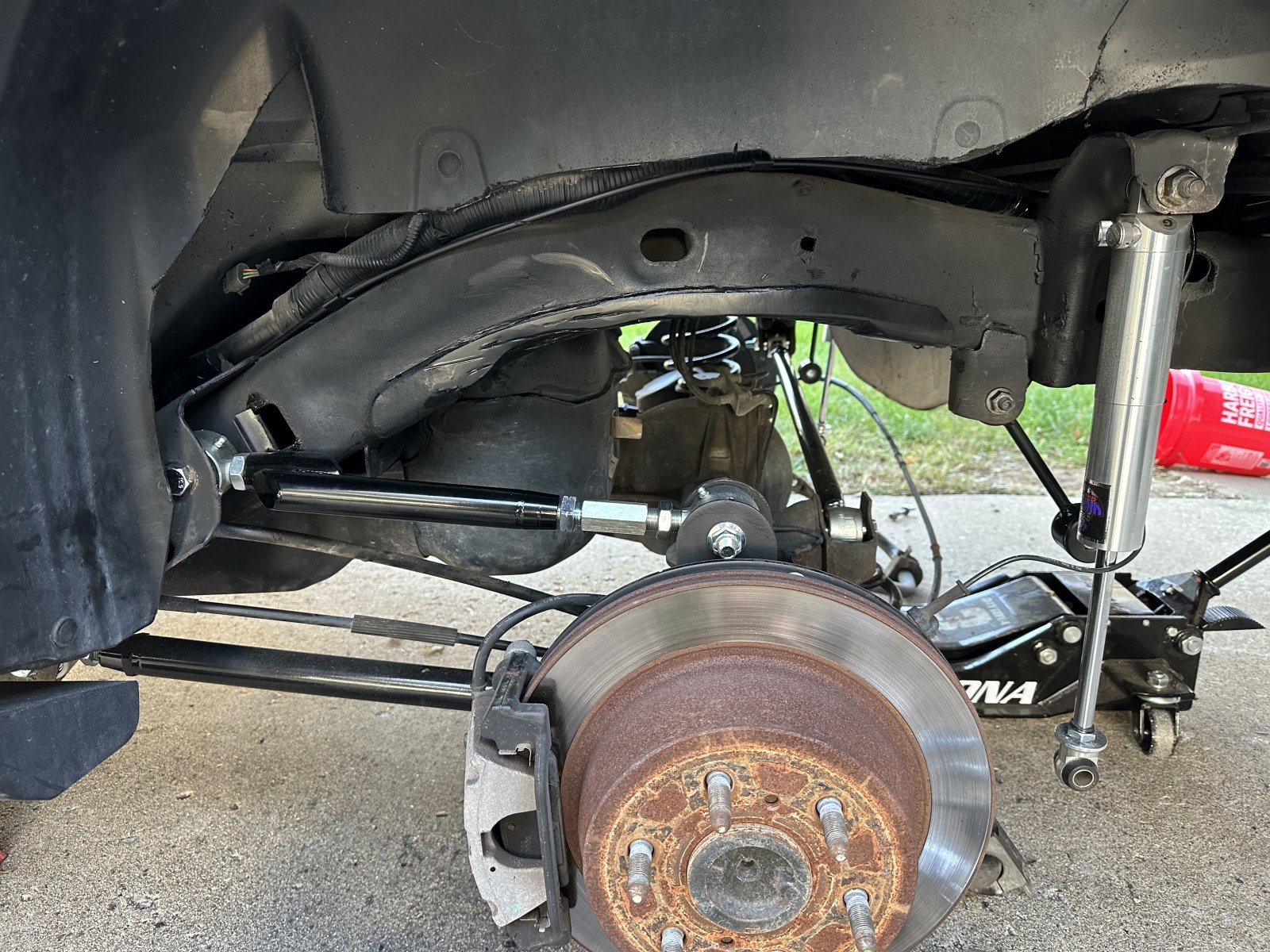

Pics dammit
I can’t imagine how big of a pain it is on a Tahoe. I had my buddy who’s much more precise with a grinder cut mine and I was on stand-by with many fire extinguishers
After cutting and a flap disk:
After paint and Spohn UCA

I knew you had pics! You called my bluff. Good job! Daytona jack FTW. Homer bucket FTW. Damn that thing is clean. Now the rotors REALLY look like chit. >wink<
That’s why I paid what I did for this one. It’s SUPER clean. I actually just took those pics when I posted them, just for you :cheers:
I freakin love this low-profile long-reach. Worth every penny.
That, sir, is a Harbor Freight bucket
I KNOW, OKAY :boxed:
Well you did right attacking the driver's side "free travel mod" first. That's the worst side, other side should be easier from what I have read.

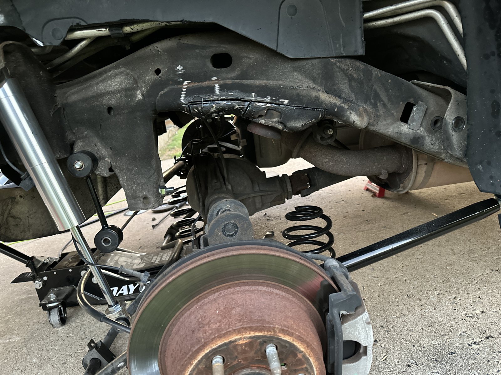

The driver side was exponentially more difficult than the passenger side, because of the damn gas tank. I got around it by using a 40” pry bar and a 7” cutoff disk, but it was still a bear trying to not cut into the tank. I still nicked it with the cutoff wheel, you can probably see it if you zoom in.
This is mostly how I did mine. 4" death disc on the outer wall and front and back side walls. Then a recip saw reaching through the front cut slot to cut the back wall as far as I could go. Then pried it down with a wrecking bar to score the back wall from the inside-out. Worked it back and forth a few times to break it off. Cleaned it with a flap disc.
Yup! 4” diamond cutting wheel for the outboard and sides, then sliced it up the middle. Used a 40” pry bar to pull the whole thing down then switched to a 7” diamond cutting wheel and let ‘er eat!
Here I was in the middle of cutting. You can see where I chopped it up the center to allow it to bend downward.
