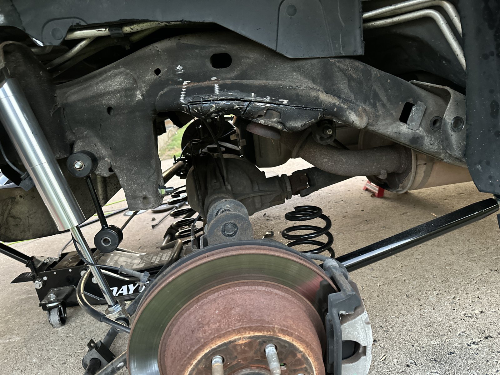

In all the fun, I ran into the same problems @iamdub did. Upper ear on the frame-side of the panhard mount hit the chassis. It has now been “corrected”
My sway bar is also touching the axle-side of the panhard mount, albeit just barely. I’ll have to have a welder friend rectify that for me.

Also just finished adjusting the panhard bar to center the axle, and the lower control arms. Without the drop-shackles in place for the LCA’s, I had to adjust the driver’s side WAY back to center the axle. All is good, though, and we’re square without those stupid phuccing shackles.
I’ll be adjusting pinion angle tomorrow morning while on an alignment rack, if I can. If not, there’s a chassis shop here in town who will set it.
Sorry boys, didn’t take pictures of any of that. Putting the front UCA’s on now and will take a couple photos.

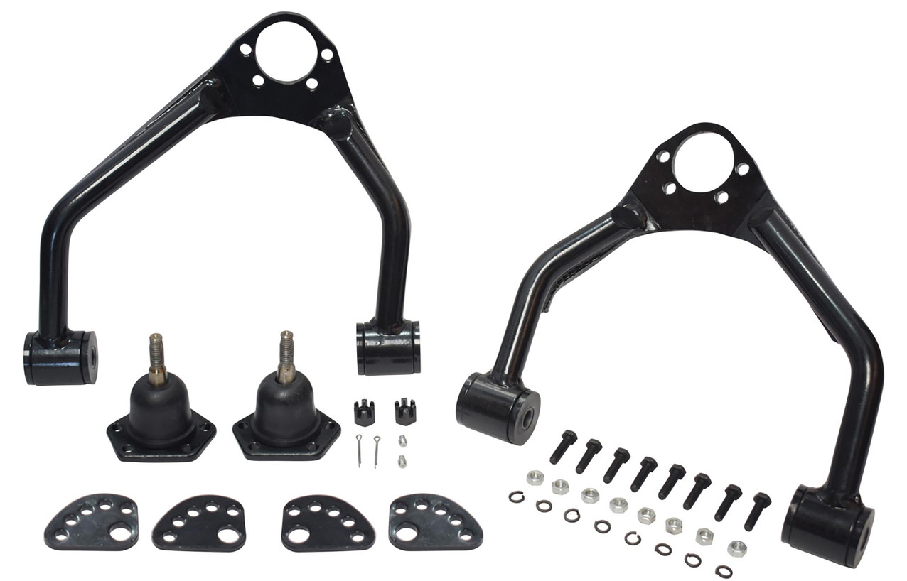

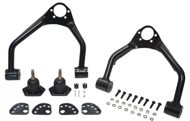

I did not install those UCA's. They're marketed as "alignment correcting arms", so when I bought them I assumed they were adjustable. You know what happens when you ASSume. Guess it would've helped if I would've looked at the picture when I ordered them.
I went to the tire shop this morning and threw the truck on their rack. Glad I did, as we were able to adjust the thrust angle into spec, instead of being almost a full degree out. We're now 0.08-degrees out, which is close enough.
I contacted the chassis shop today, and have an appointment to have the upper arms installed there, so that I don't have to drive with a bad alignment, and for them to set pinion angle, and check over the whole truck for straightness.
Be sure the grease fitting is on the bottom. Conveniently enough, there's a hole in the mount you can stick the grease gun through.
Good. When you're ready for real sway bars, you'll have the clearance.
