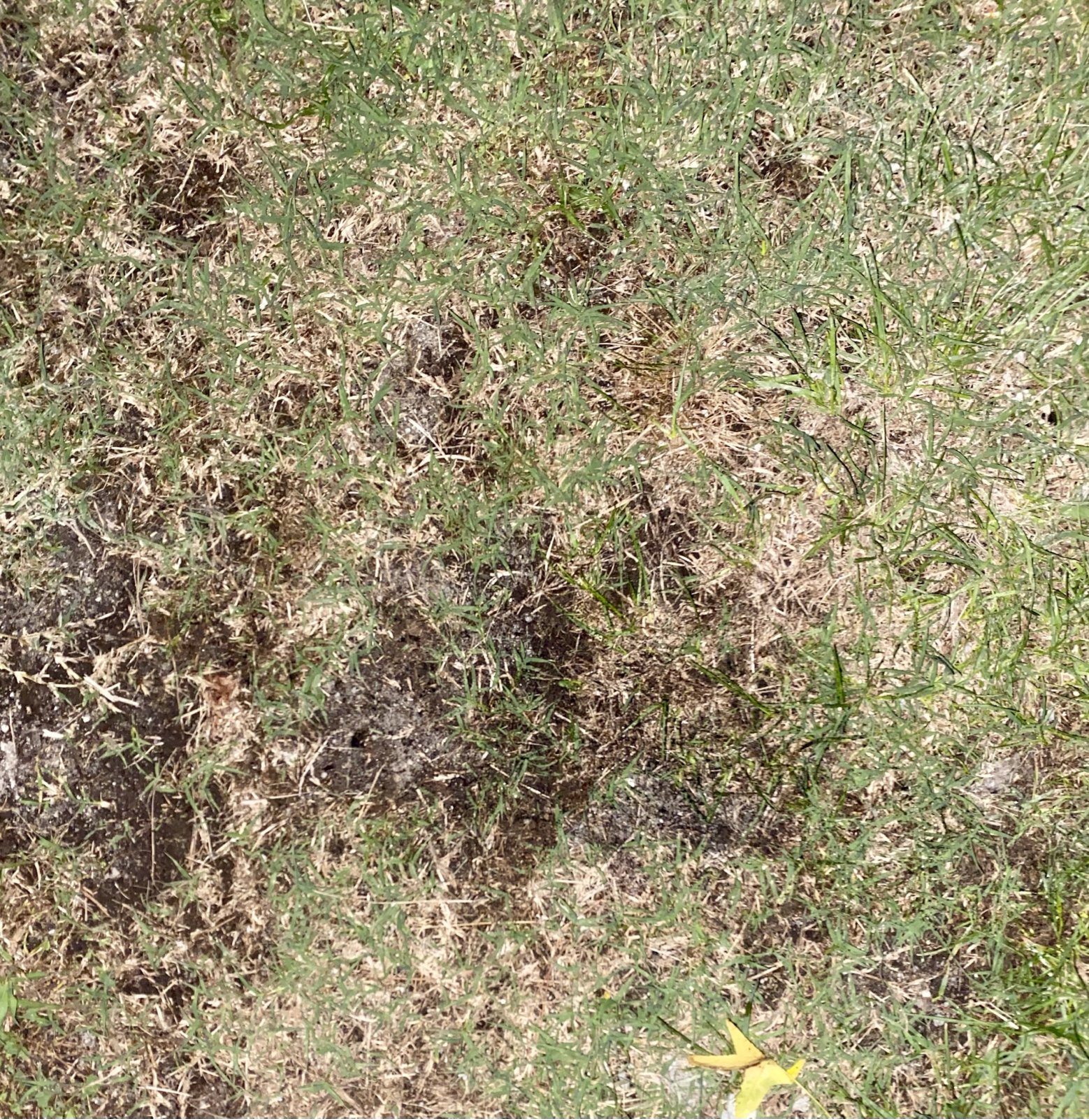

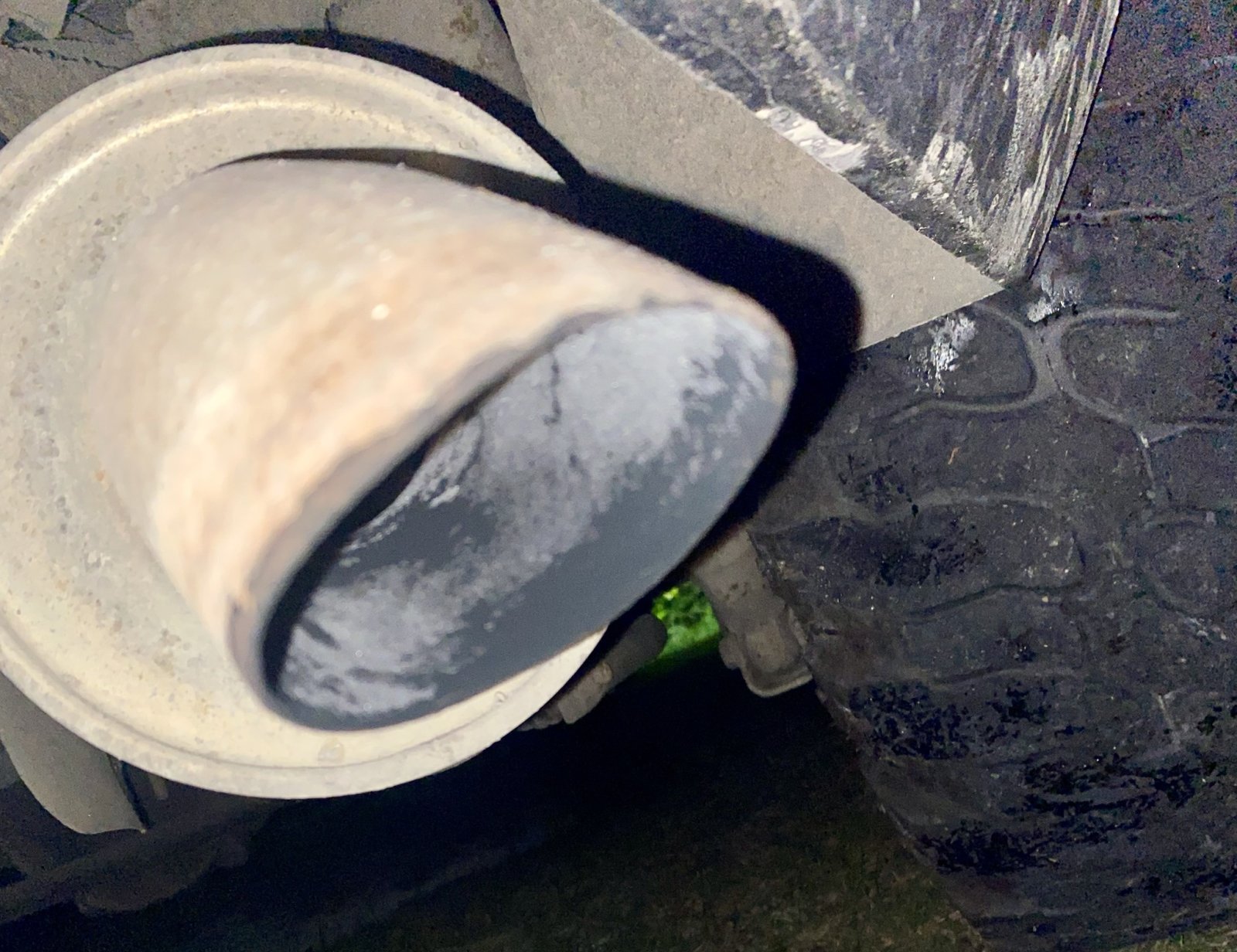

here's some oil on the ground after startup & a pic of inside the exhaust directly after

when you do those plugs inspect to see if any are oil wet, that might point you somewhere.
any misfires?

and if there are any oil in them, what them?
Note the location, then check for valve cover leaking, or if need be pull the valve cover and inspect further. this generation are not really known for having leaking valve guide seals but anything is possible I suppose
