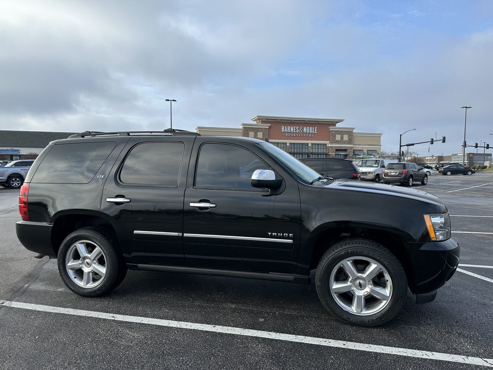

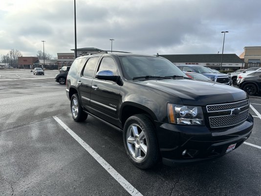

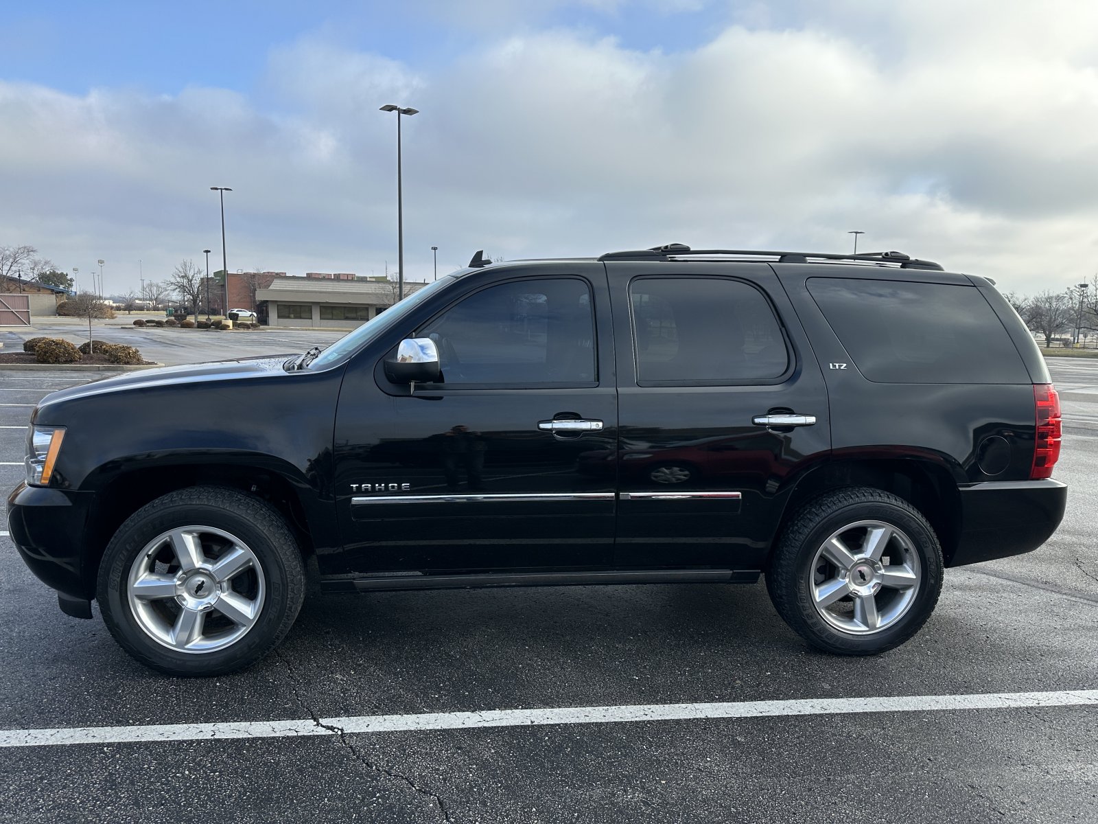

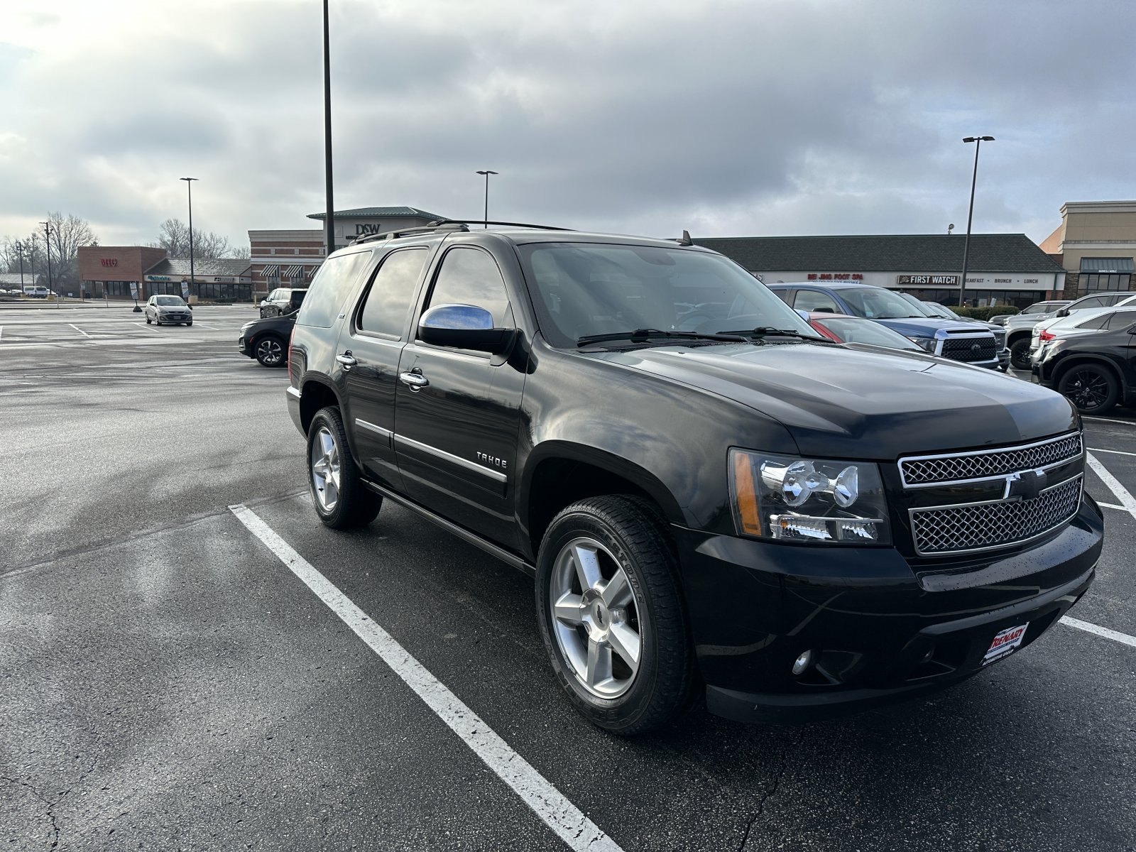

Guess I better start a build thread now that I’ve started modifying my “grown up car”
2012 LTZ with every option I know of, and black on black! I couldn’t believe how hard it was to find a black on black LTZ, and this one fell into my lap 8 miles from me at a dealership. Many will say I overpaid at $20,500, but I could not find another one in this condition, with “low” mileage, in the condition I wanted.
Purchased January 21 2023 with 100,321 miles on her. One-owner and copious maintenance records, no negatives on CARFAX history, and most importantly, UNMODIFIED!
These photos are from the morning after purchasing.

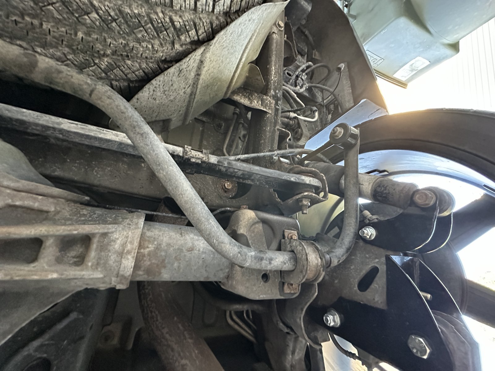

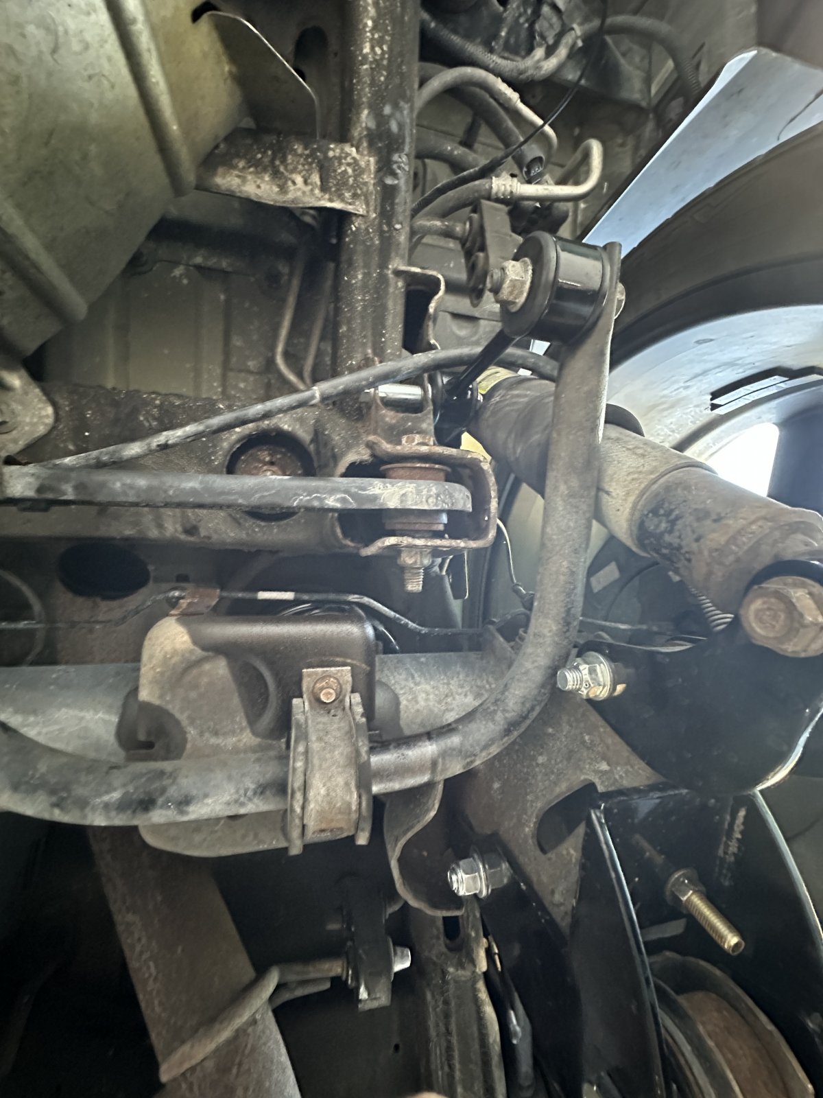

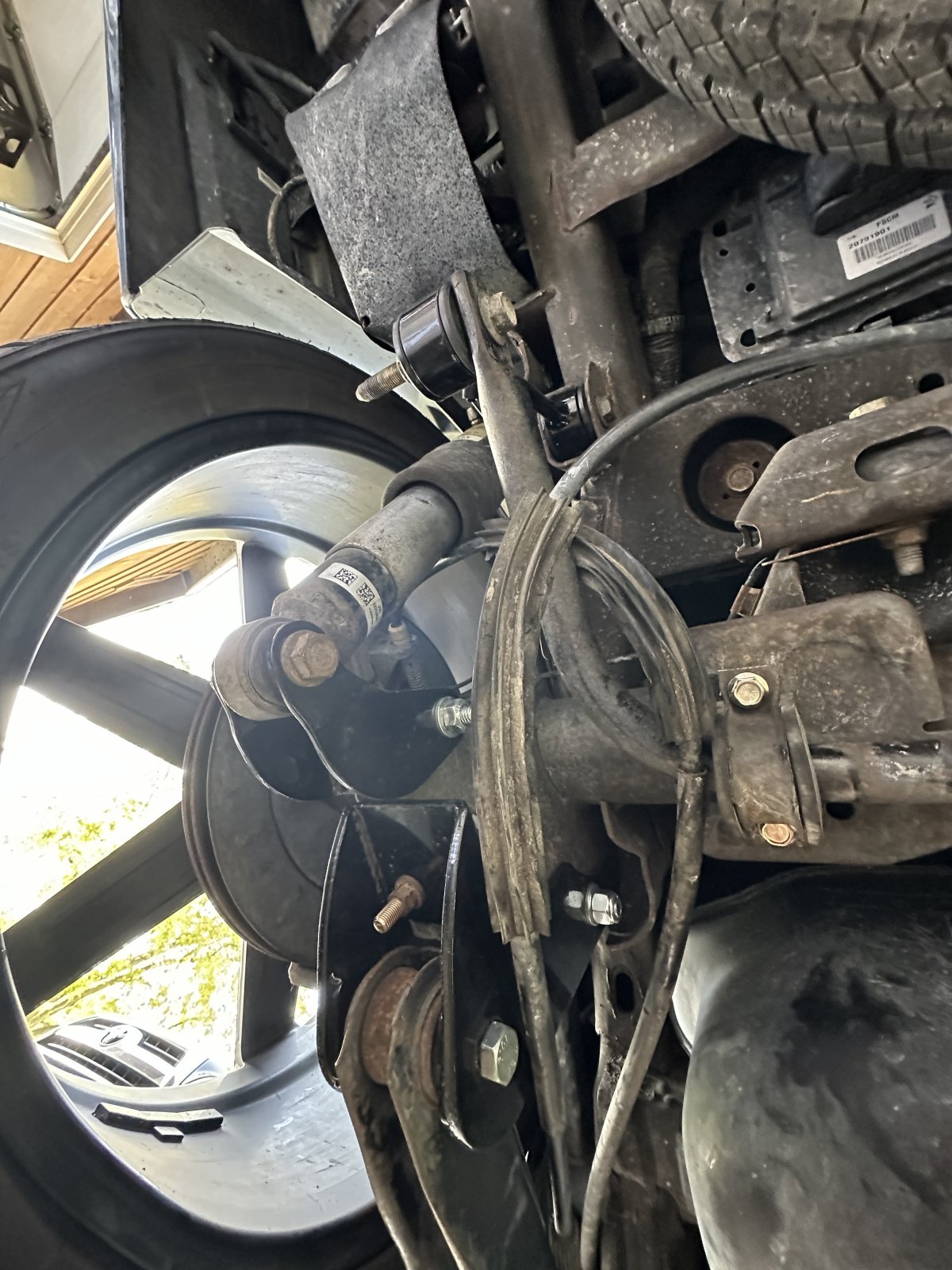

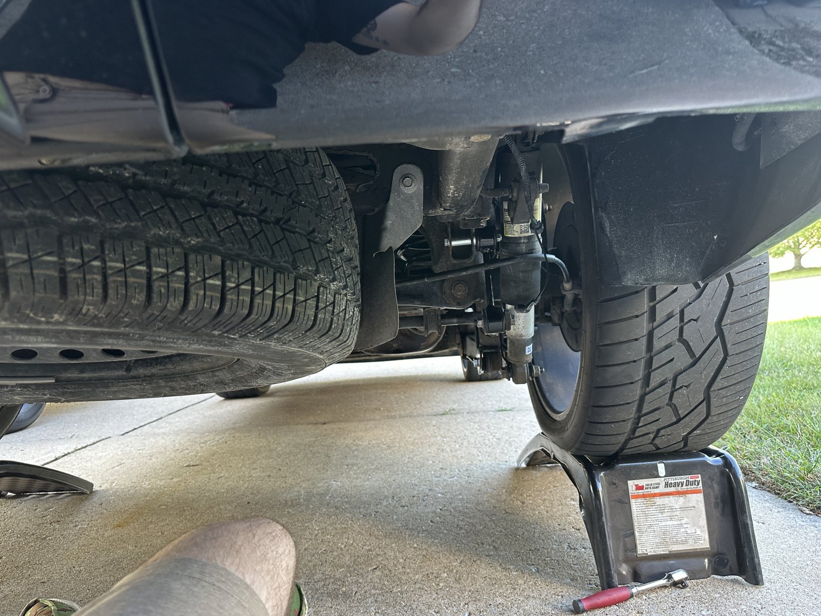

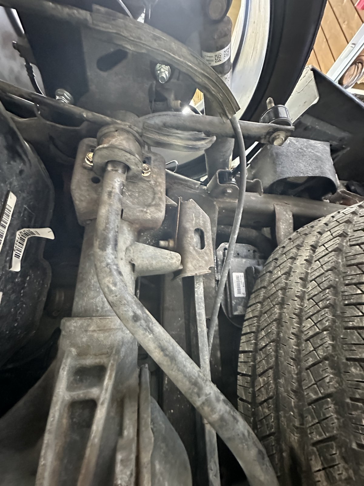

After some conversation with @iamdub , he asked me to post these photos here to show that there IS an alternative for 2007-2014 Tahoe / Escalade / Yukon / Suburban rear sway bar links. This is part of the Trekline 5” rear drop kit:
I see what they did. I like the idea of having the bushed ends inline with each other versus the Z'ed offset design of the DJMs- the joints are in compression and tension versus shear. If I manage to break mine, I'll keep this idea in mind. Or make a stupidly beefy Z.
I'll probably buy a set of Tony's just to see what they're all about. I like the idea of spherical bushings vs static bushings.
