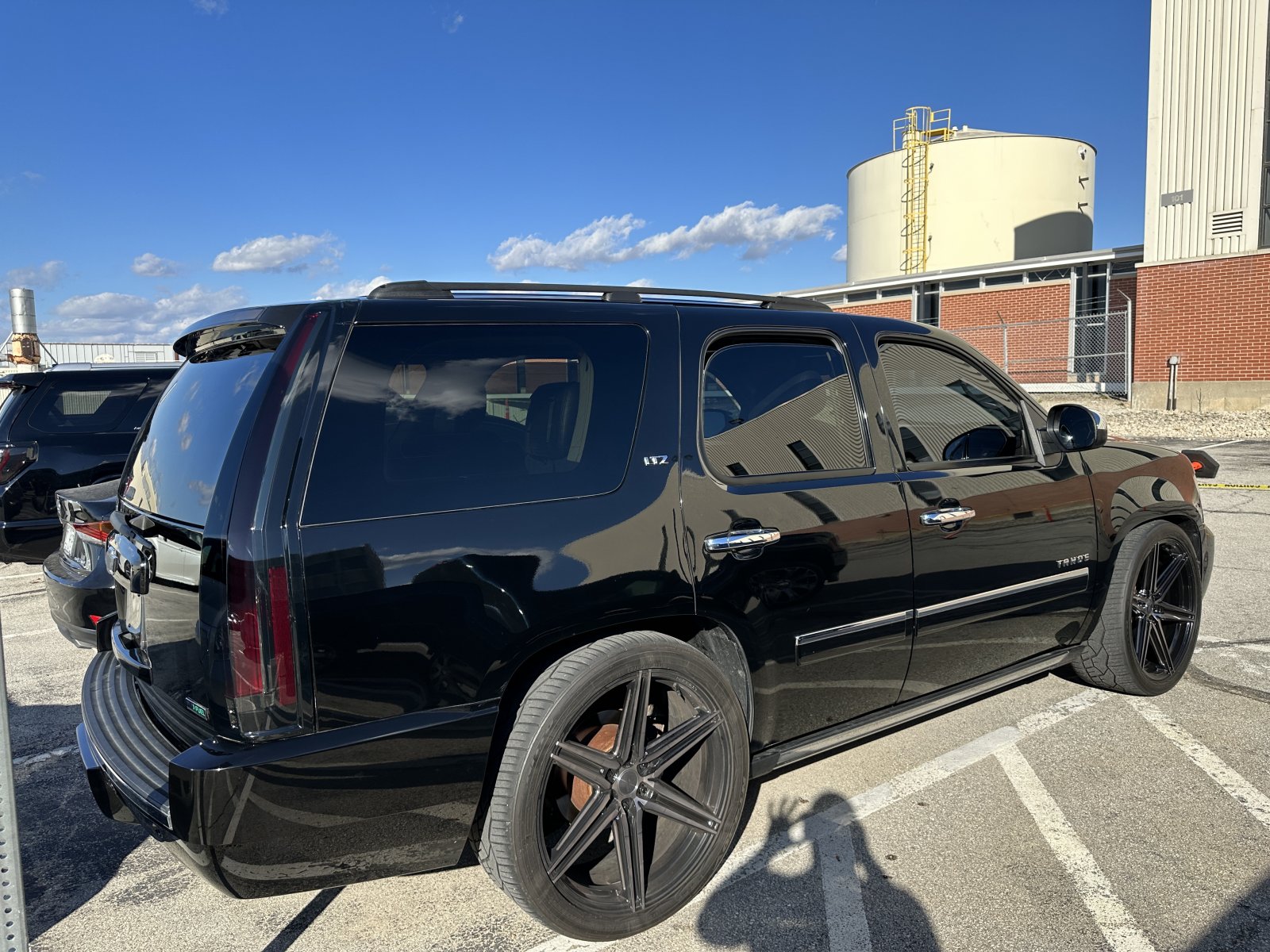

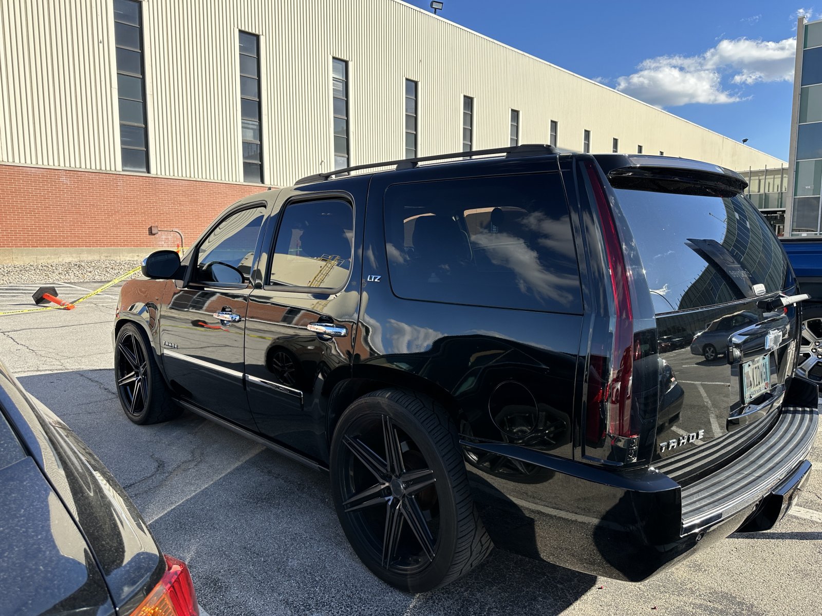

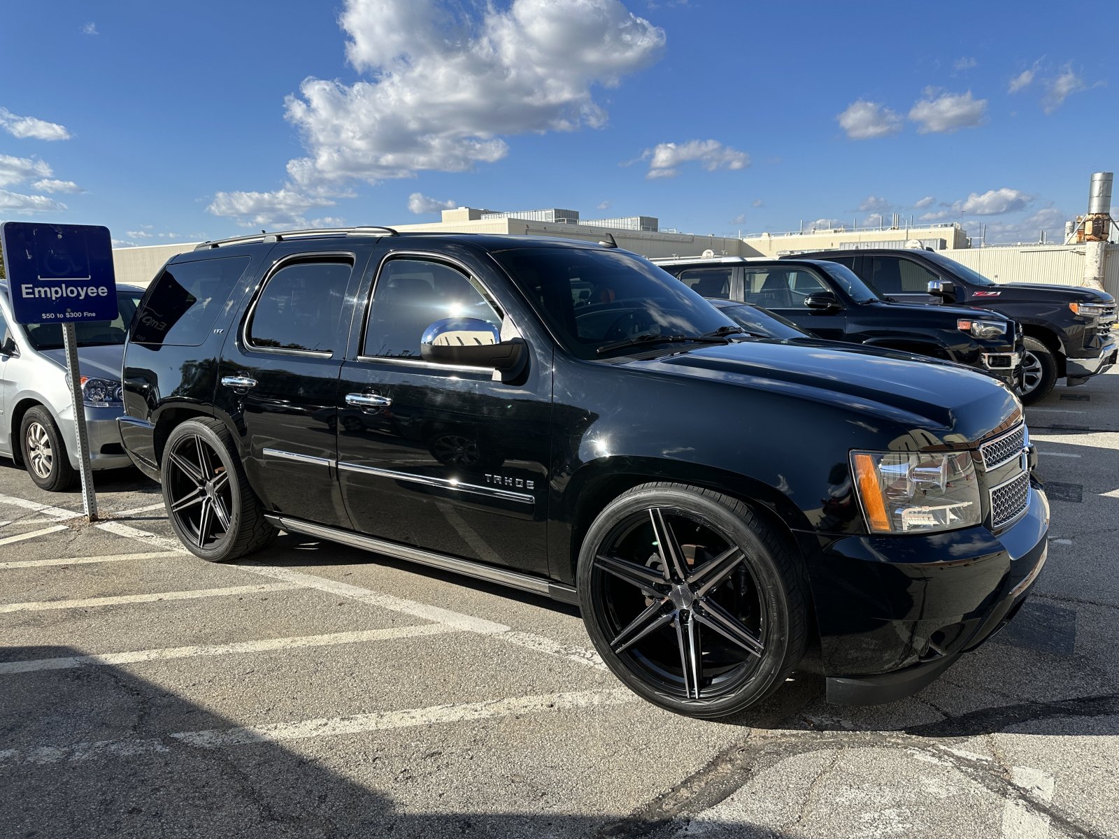

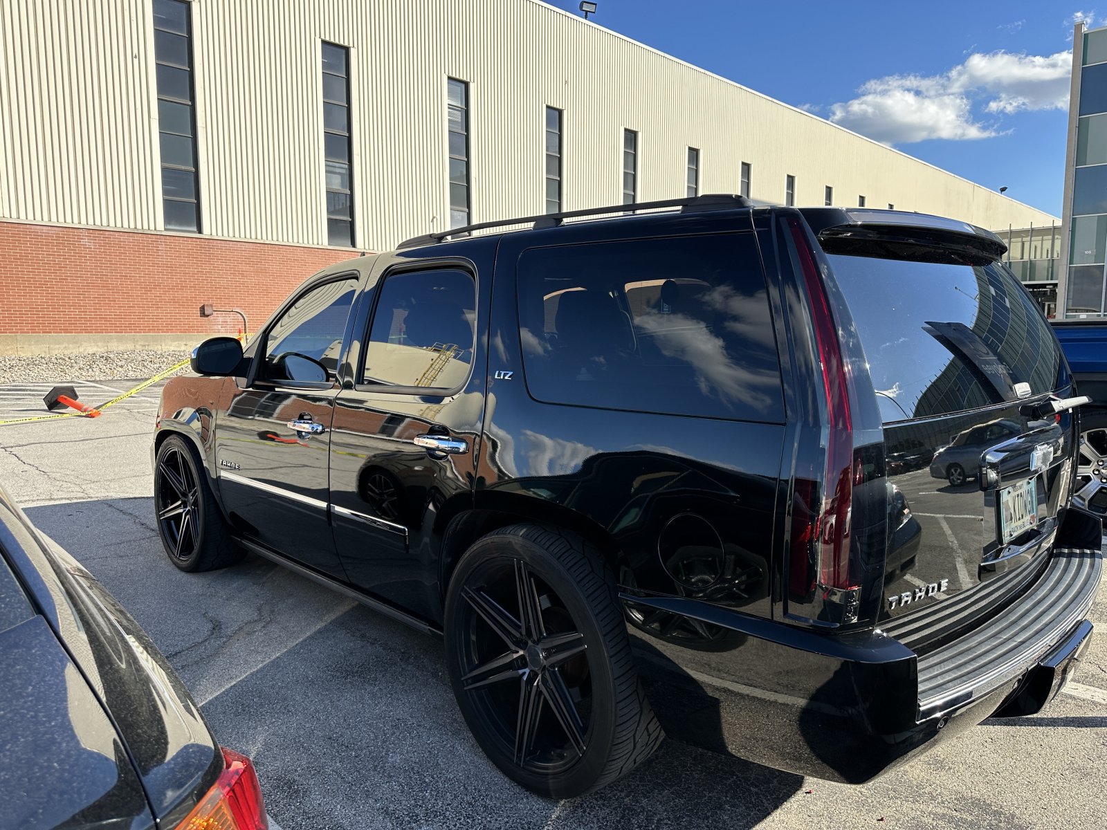

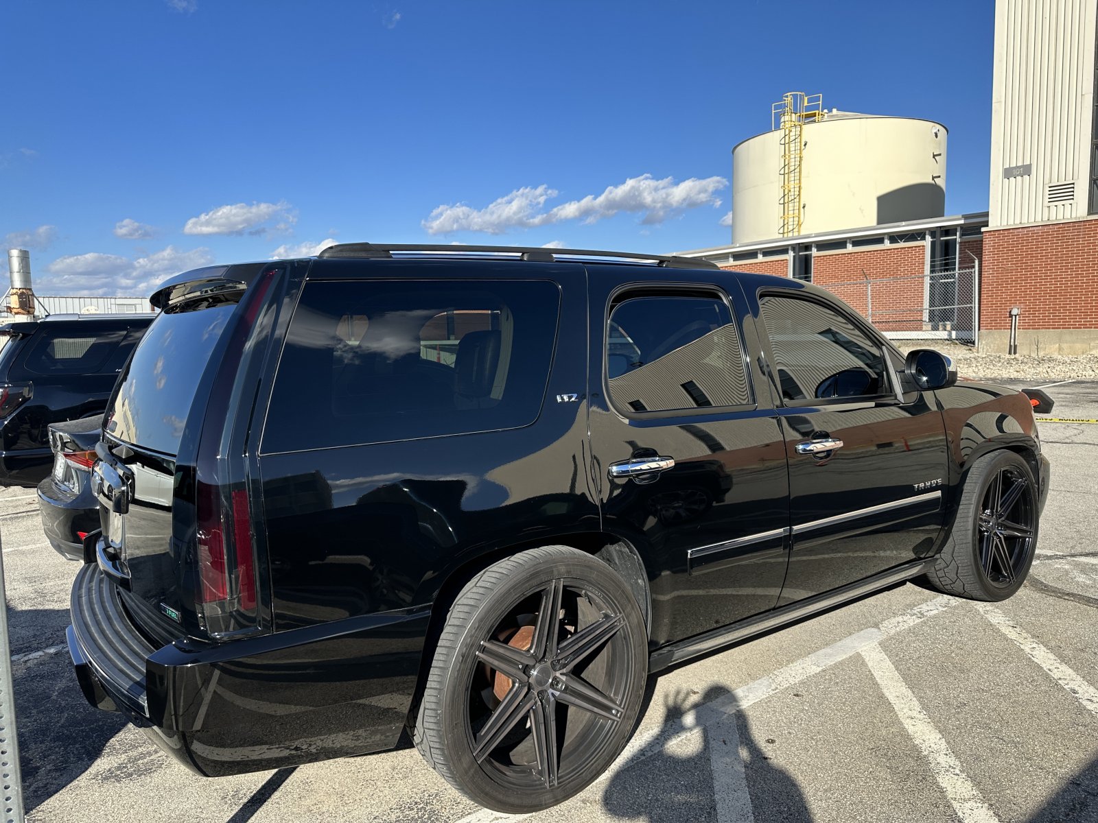

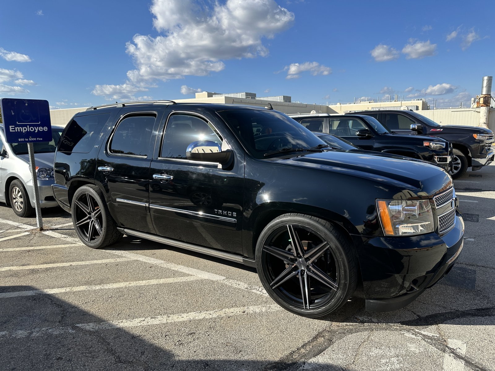

Got myself a free claybar job today!
While at work, some idiot contractor decided to paint the light poles on a windy day, blowing overspray on 300+ cars.
A company called National Overspray Removal reached out to me, as they were contracted by Boeing to have the problem rectified! I figured, the worst that happens is I get a free car wash and I STILL need to buff it.
Turned out better than I expected, and be even laid 2 coats of wax on it. I told them not to touch the wheels.
