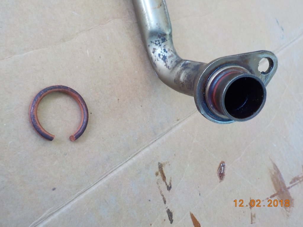

1st of all: lots of fake/counterfeit parts out there... IDK if amazon is the best source...
and these gauges are just a guideline at best, esp the coolant temp...
2nd: the actual "TEST" that OP is asking about basically drowns the oil pump inlet
in oil and ONLY is an indication of the condition of the oil pump inlet tube pick-up O RING only.
The test is: add 2 quarts extra to an already warmed up engine. Park downhill (pretty decent
grade is needed for oil to slosh to front of pan)
Don't rev engine.. IF you see a significant increase in oil pressure on your gauge or scanner,
then you prob have at least a deteriorated O-RING (you may have other issues too)
But this test is only for the O Ring.
Then, don't drive around with the extra oil... Get it to the correct level immediately or you'll
be dealing with way more issues soon enough

just leaves me wondering what gm did with all these truck o rings that they fail so often.
This is not true. When the o-ring gets brittle is when they fail and then they good for another similar duration of about 165K miles.

They really don't fail so often. It's an age thing. The O-ring loses elasticity, shrinks, gets brittle and splits. It's in a rather harsh environment of chemicals and temperature swings. They commonly last well over 150K miles.
It IS a common failure in higher-mileage engines and that's when you see posts about testing it.

Mine at 130k miles w/good oil pressure. Broke when I pulled it off.
I have see that a lot over the years, a o ring that's fine, till you pull it off and try to take it off. it then splits. not on these trucks, just general stuff I work on.
I wonder if gm only putting the one bolt on let's the tube move around enough for the o rings to break while still inside their groove

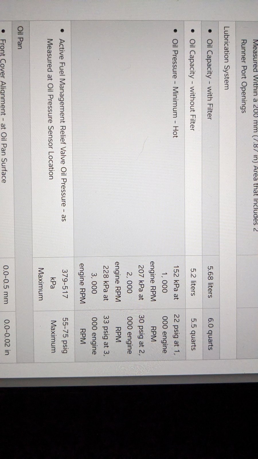

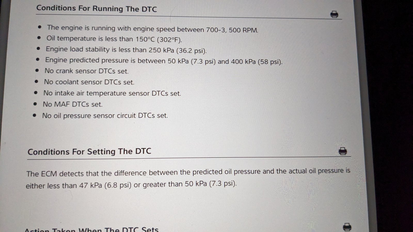

by higher oil pressure this is what I mean, what gm calls out as acceptable. I'm still not sure what you actually see in the gauges?
*see attached*
so basically it says 22psi at 1000rpm and doesn't set a engine light till 15 ish. I'm guessing by a 600rpm idle that would be 10ish?
the spec for the 08-13 6.0 hybrid with the variable displacement pump calls for a different spec.
oil pressure spec hot
36psi @1000
42psi @2000
45psi @4000
afm relief valve 55-75 max.
p0521 ecm detects different oil pressure than expected by lower 6.8psi or greater than 7.3 psi for 10sec
seems like a big difference in pressures for basically the same engine. that's all I meant by that comment. it doesn't really idle when it's hot, it auto stops, I'd have to see force it to run and see what it idles at. but any time it comes out of auto stop it goes straight to the mark between 40 and 80. you've got me curious. I'll have to check. I've never noticed it below 40psi. I've got a legitimate dealer bought new sender on it. I agree there seem to be some counterfeit ACDELCO parts on Amazon. they got me the 1st time.
I'm still wondering what a standard 5.3 idles at when hot in a low mileage one?
my ls3 is in a c6. on 5w30 at 200deg temp it is around 38psi.(no afm or vvt) but that's a manual idling at either 750 or 800rpm. I can't remember now, bumped it up a few rpm at idle for the alternator voltage after I put a underdrive balancer on it. so not really applicable, I only mentioned it because it's over 100k and I've had it above 300deg oil Temps a few times at the track and mountains before I got the Temps under control and just changed the o ring out cause I was in there. it was the original one, blue color for the sizing but it was perfect. couldn't tell a difference between it and the new one I got from the dealer to replace it.
LOL @ what GM calls out as acceptable, especially on the subject of oil consumption.
*see attached*
Thankfully, it's not so linear. Mine hot idles around 650 and 25-27 PSI. 1,000 RPM takes it to mid-30s. 2,000 RPM is good for around 42 PSI. My guess is that one, at hot idle, would be around 20 PSI.
I didn't know you had a Hybrid nor did I know it had a variable displacement pump. I only knew of GenV engines having them. I also just realized my pressures are spot-on with the Hybrid specs. Mine's a 222K-mile LMG with a high volume pump (Melling M295HV, also ported),
plugged AFM towers and plugged AFM relief valve port.
I see what you mean now. Yeah, those spec'd pressures do seem higher than the non-Hybrid engines. I think they allow low-20s at hot idle and under 40 cruising (1500-2000). Still plenty.
