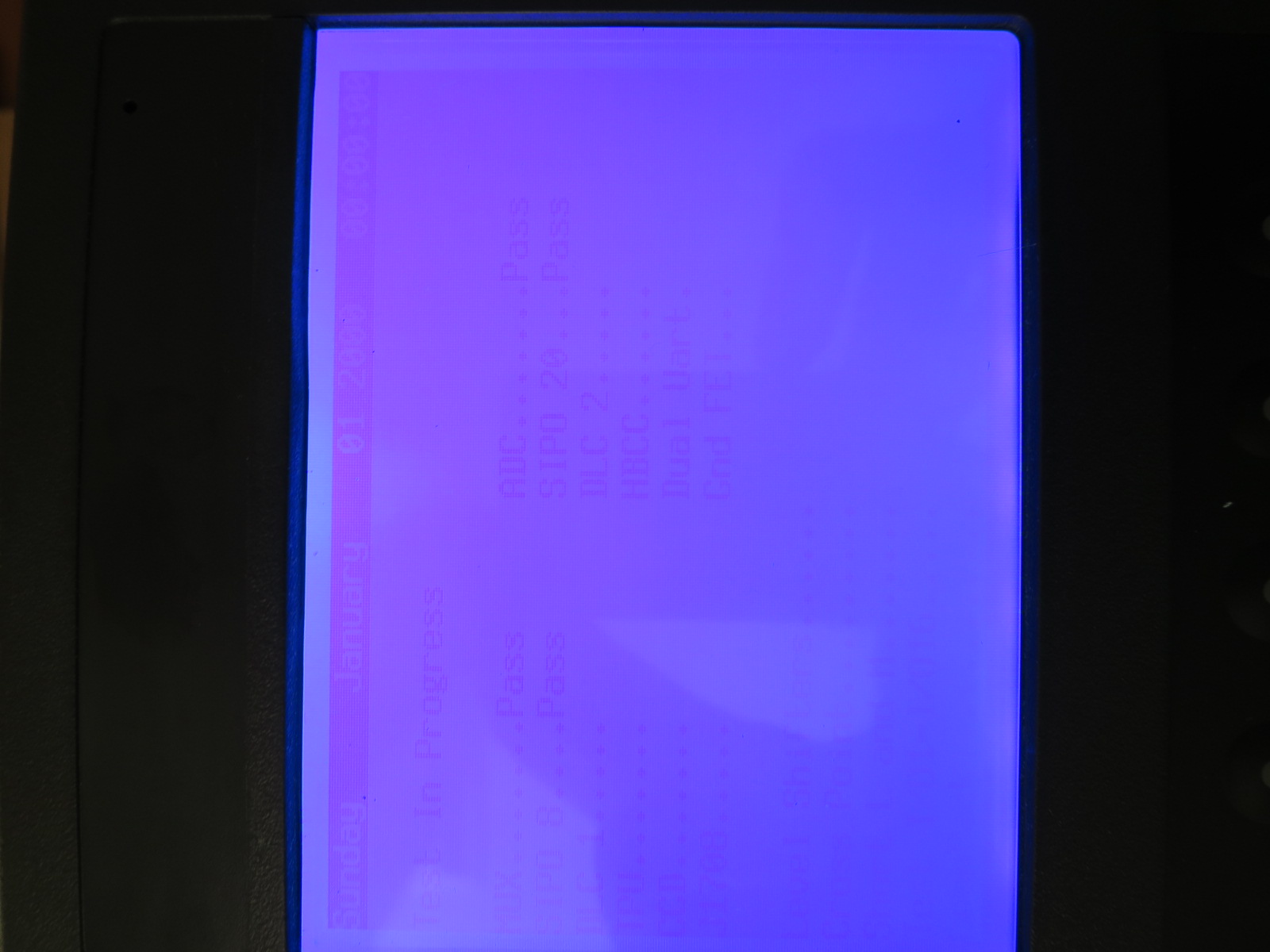

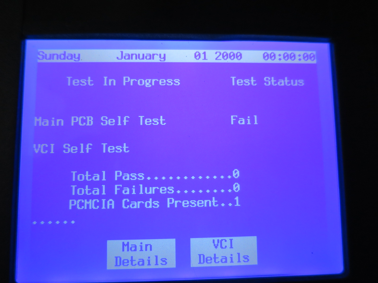

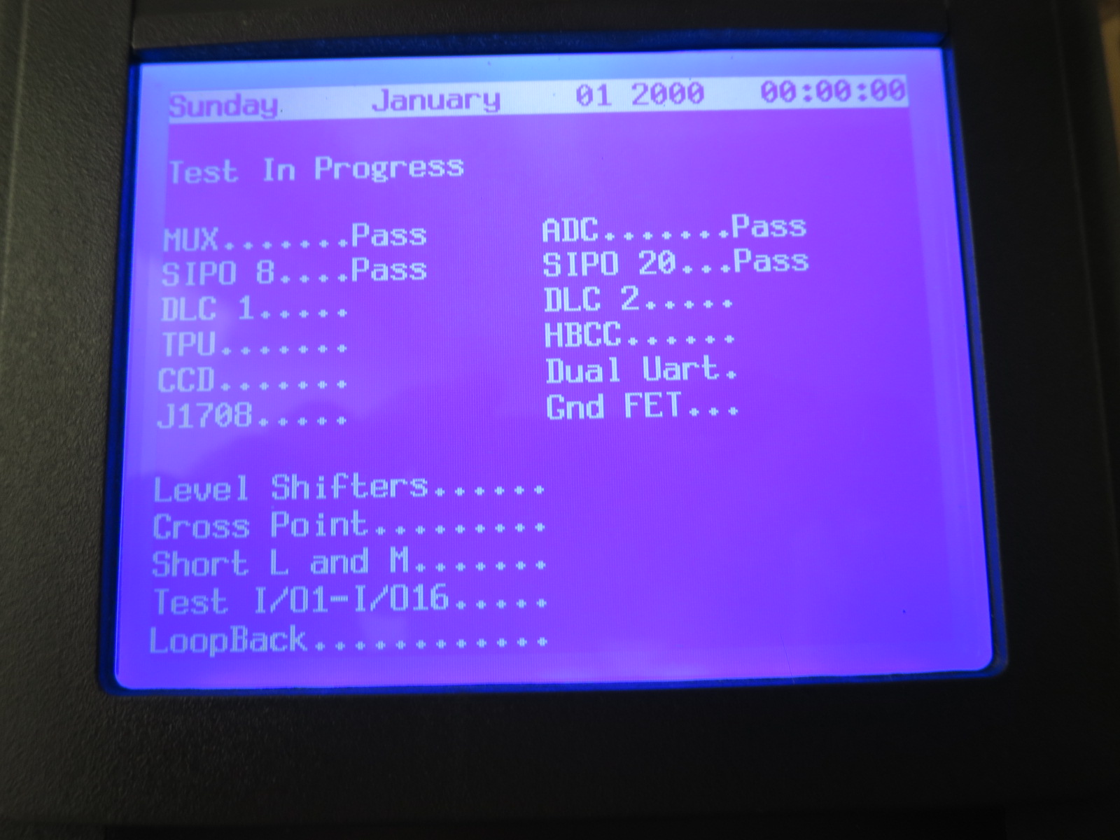

I think I got a duff one.
Contrast has reset a couple times
VCI test hangs at this point every time.
The GM User guide (P122) doesn't mention the Auto. PCB & VCI test but it stops here, won't respond and I have to shut it down.
You have to make sure that you power it up and connect the connectors EXACTLY where and WHEN the instructions tell you. I did some self-tests out of order and got error codes but they passes when I followed the instructions to a tee.

I followed the instructions in the GM User Manual to run the test. I left the VCI test running while I went to get groceries and it's still hanging. It must be a bad one.
Edit
I just went down and tried it again. No matter what I try I get a communications error that says something like 'lost communication, check the cable, check the ignition', or it hangs on 'starting communications'.
Wish I'd already tried one or could try someone else's to see if it is the unit and not my truck.
