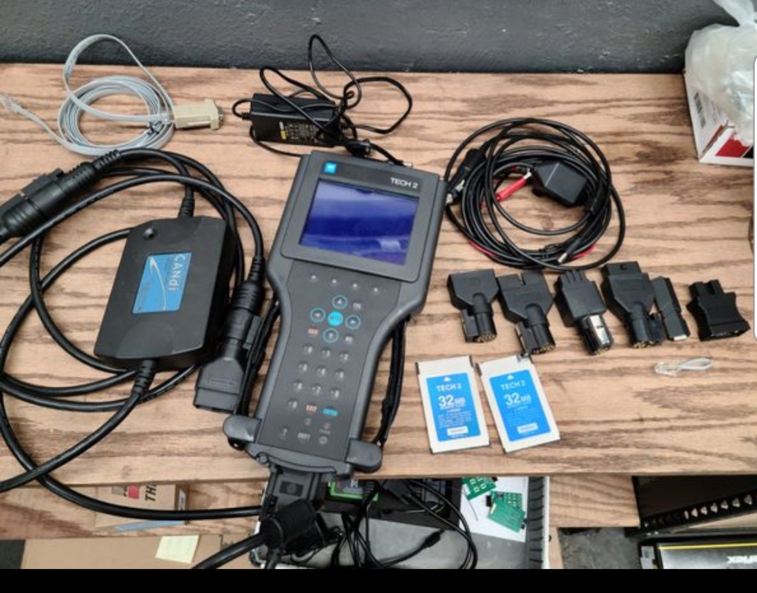

That's a good price. That's everything I received with mine. How can you do a flush with it? I'm still trying to learn myself.
LOL. It does the ABS bleed which also basically flushes it out. The last time I was setting off my ABS on loose ground trying to get air out of it a lot of nasty black crap came out of it so it seems like something that should be done with maintenance imo.
Same guy selling it for $250 w free shipping here. https://www.ebay.com/itm/Automotive...589216?hash=item3b4a1e9720:g:wb4AAOSwSTFe4G-K
Anything I need to look out for?

Not really sure. I went into it blindly myself. Hopefully guys like @swathdiver @Rocket Man and @Doubeleive will chime in. Did you get the latest edition? I think it's something like 3.004

Thanks for the replies. Should get it by the end of the week.
21,296
30,248
Looks good. Do thoroughly run it through its paces once you get it to make sure all features are working.
Mine has seen near continuous, almost daily use for the last three years now. I get a real time clock failure on start up even though the internal battery was replaced. When it first arrived, the OBDII adapter was defective, I bought another which is how I discovered the original was bad. They sent me another and I have since bought another. Mine also quit talking to the older vehicles. At first, moving the PCMCIA card into the other slot seemed to work but now it won't talk my wife's car again. So I bought another card but that did not change things. Today I ordered up another cable so we'll see how that goes tomorrow when it arrives. These are parts that wear out so don't let my comments discourage you.
If you are using this on your '96 you will not need to connect the CANdi module. That's only needed on vehicles with the CAN bus computer architecture like the GMT-900s. But do run the self tests when you get it. Have fun!

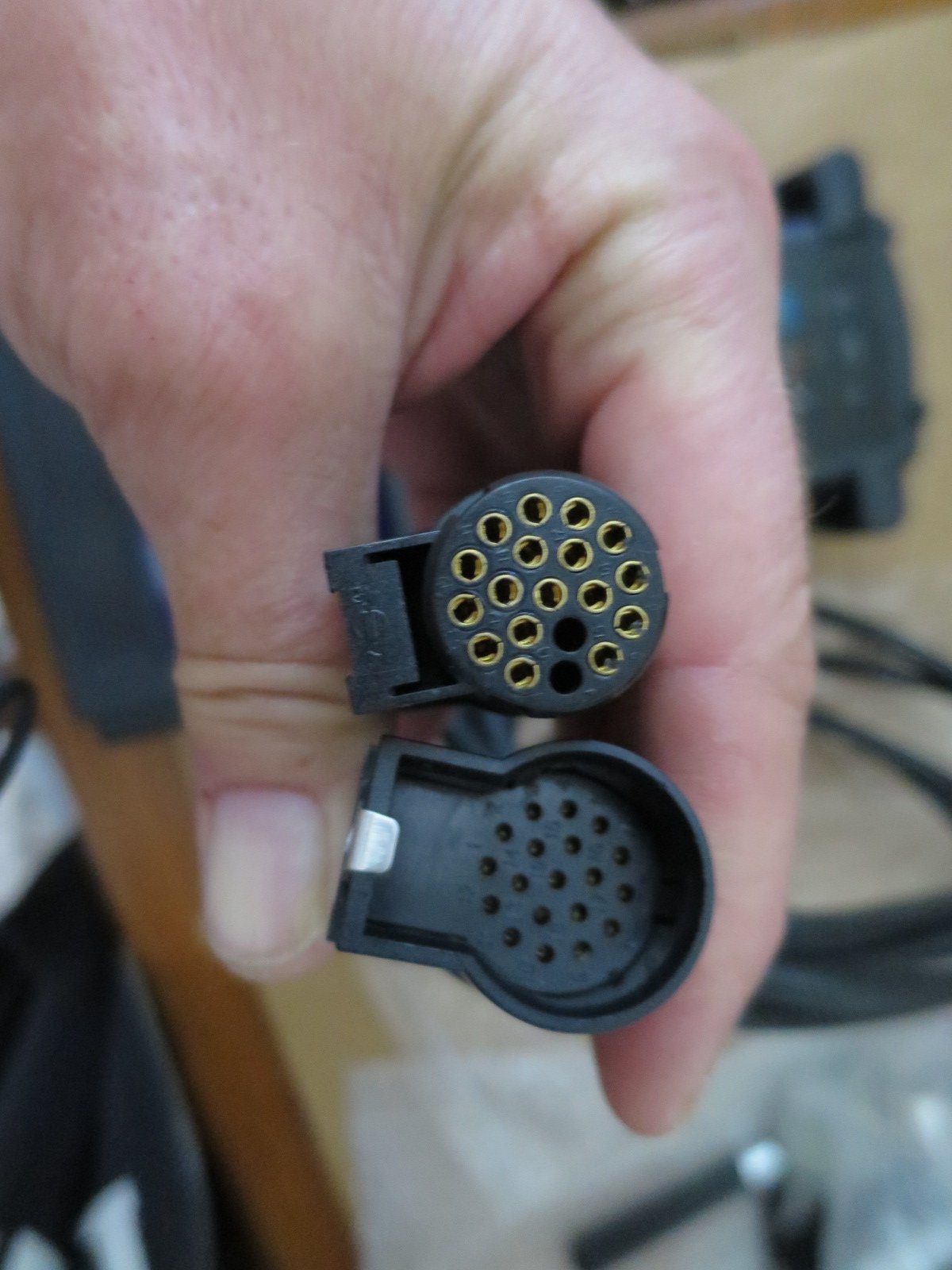

AC adapter is definitely dead. Just hooked it up using the battery cable adapter and it starts up fine.
I'm guessing this adapter goes with this cable. But what I don't get is how does it actually make a connection when there are no pins on one side?
I just found out. And now I know why it's so tough to get them together. I did take a good look before I asked, honest. Still can't get it them to snap together though. Hopefully will work anyway.
Mine are super tight and never really "latch" together, but work fine otherwise
push harder, I would say hit it with your purse but this isn't facebook :fishing1::Good or Bad:

I already tried hitting it with my purse. I even greased it up with oil off my nose. It's 1/16 off. I think it will be fine.
30,547
47,997
ya they are pretty snug try taking it apart and putting it back in a few times and then push till the clip holds it together
