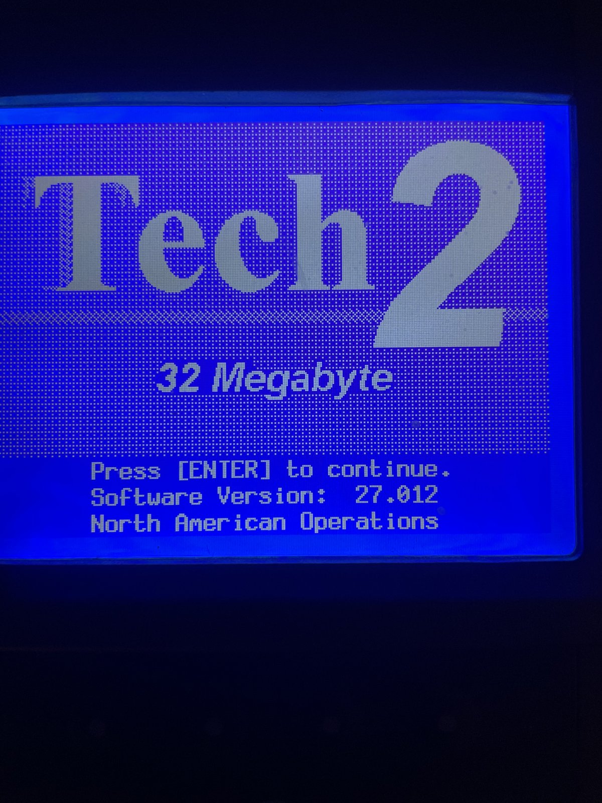

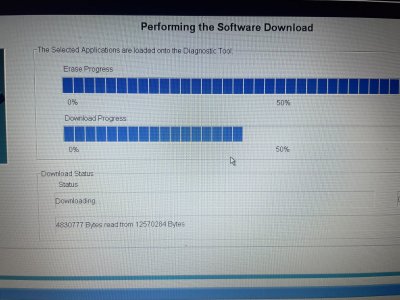

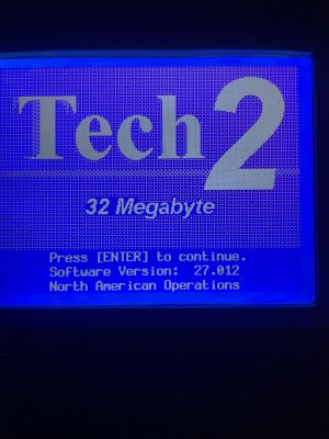

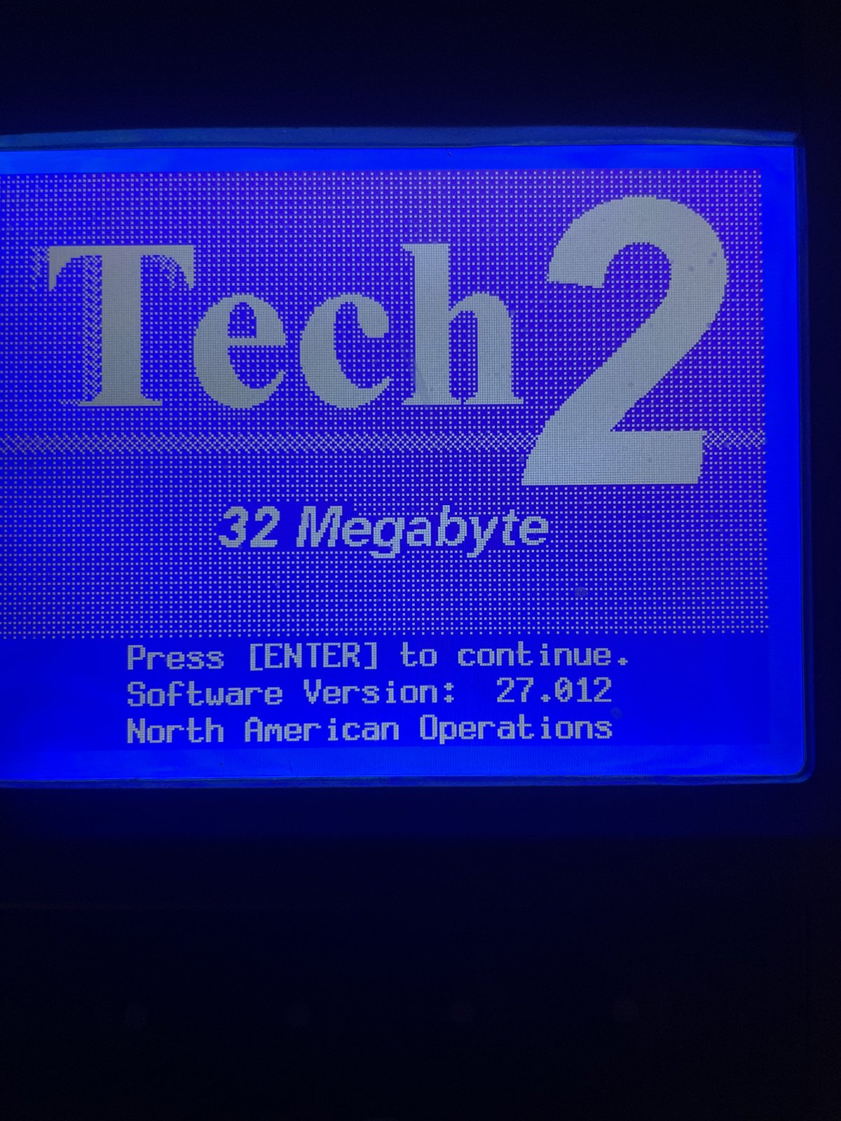

Going to try saving back one revision on the PCMA and then back up a revision.
wsteele
Dec 26, 2020
1,731
2,355
Fail. Still stuck. Gotta try starting over.

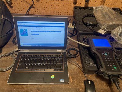

That is a bummer George. Are you running the SW on an old Windows PC or running in some compatibility mode?
If you are running TIS2000 in a compatibility mode, maybe you can try using the web version (TIS2web) to get the latest sw downloaded. There are YouTube how to videos out there on using the TIS2web with your Tech 2.
George B
¯\_(ツ)_/¯
Feb 5, 2020
7,881
18,990
Oconomowoc, Wisconsin 53066
I am going to have to figure out how to do this or buy a new card.

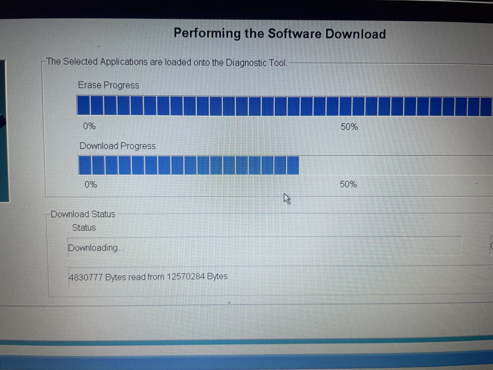

Captain Dumbass strikes again! DOH! I don’t have 33.004 on the PC. How do I update to 33.004?
One way would be to do a search on YouTube for something like "updating Tech 2 with TIS2web" or some such search. There is a guy who makes a bunch of clips on using the Tech 2 with the online service. It probably means a subscription to GM's TIS2web download stuff, but I think it is pretty cheap. Not sure how that compares to a new card price wise though.
