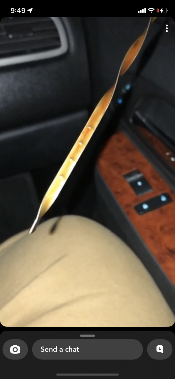

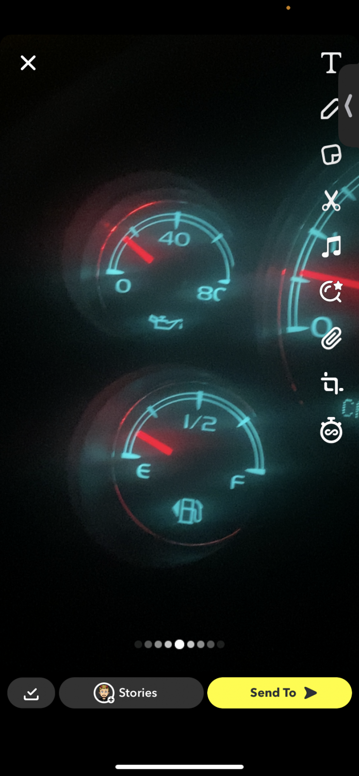

Normally I’m between 20-40 but lately it seems to be dropping? Oil level looks good but it’s reading low lately. At 17 PSI

First of all, the gauge is not an absolute. A mechanical gauge is best to compare with but a PITA to hook up. Try a new sensor to start with for a cheap fix. You are gonna have a screen to deal with as well on this NNBS rig. See a few, not just one, you tube video to see what I mean.

So, in my experience here and on my own trucks, the oil pressure sensor is the most likely first cause of low oil pressure indications on these engines with AFM, as the filter screen on the sensor gets clogged and only AFM engines have that screen. The second most common cause seems to be oil filter choice. The third most common cause seems to be the oil pump pickup tube o-ring, and the fourth most common cause is probably a tie between a sticking oil pressure relief valve in the pan, a damaged oil pump (e.g. lifter came apart and spread shrapnel through the pump), or worn cam bearings.
I think you have a solid plan. Start with the simplest first, which is a fresh oil change using a known good filter. I use a Wix 57045. And then go from there.

High miles. 165k and I live in Midwest. Usually cold a lot. Haven’t changed oil since got it from dealership. They said they did. But I doubt it. I don’t really know how to read dipsticks. It looks fine to me from just looking at it. No leaking underneath.
