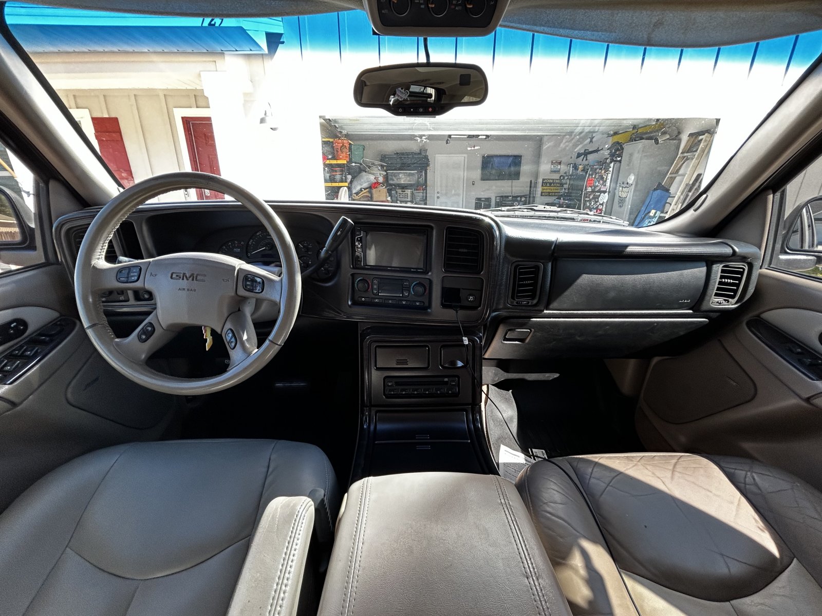

This is my current mission. Dashskin really made a huge difference. I also repainted all the trim and used vinyl paint to black out the rest of the dash. it’s a work in progress. As far as tightening up all the connectors, I did some searching on here and found that getting some small adhesive felt strips and wrapping all the connectors with them really tightens things up and reduces the rattling. JB Plastic Weld works pretty good for fixing broken ones too. I’ll be posting updates periodically as I make progress on mine so I’ll be watching yours too.
