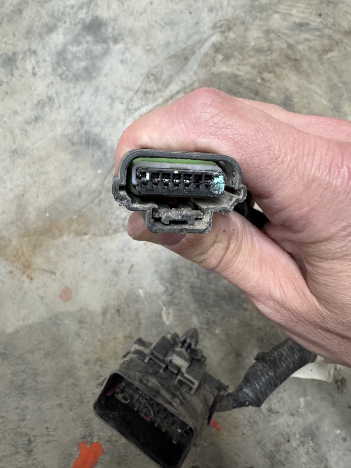

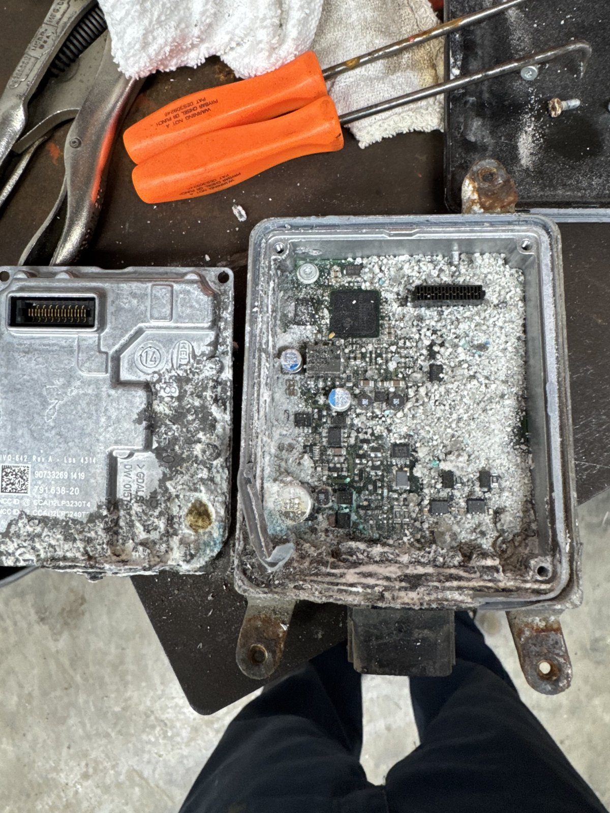

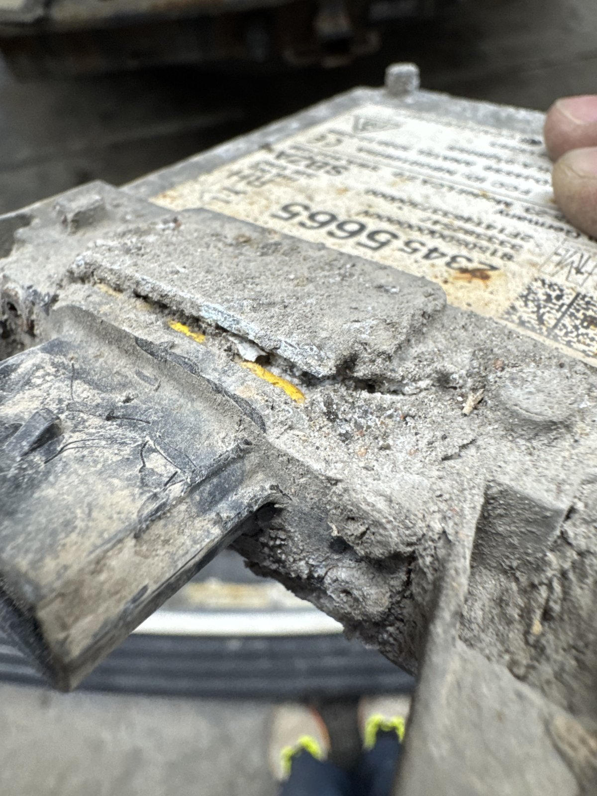

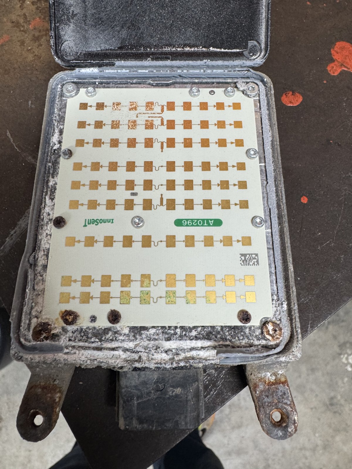

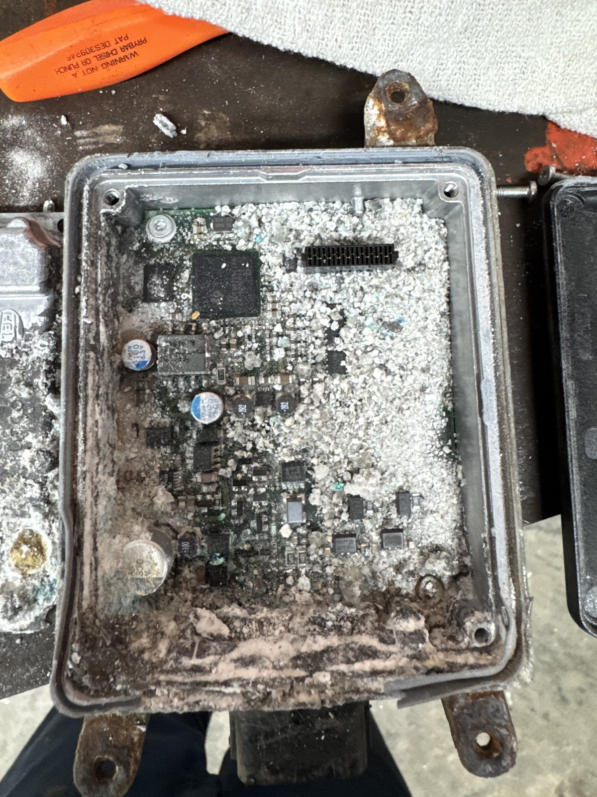

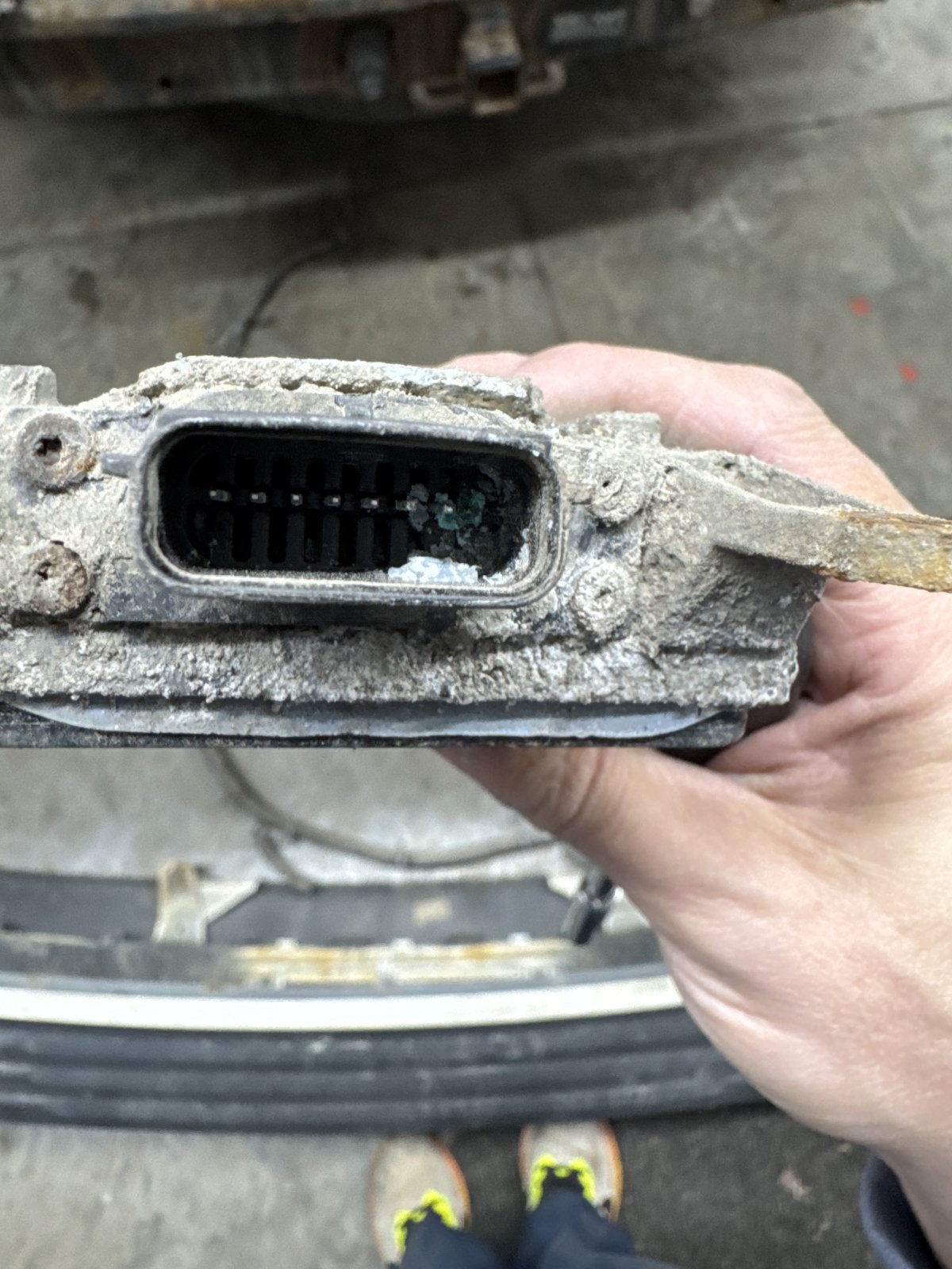

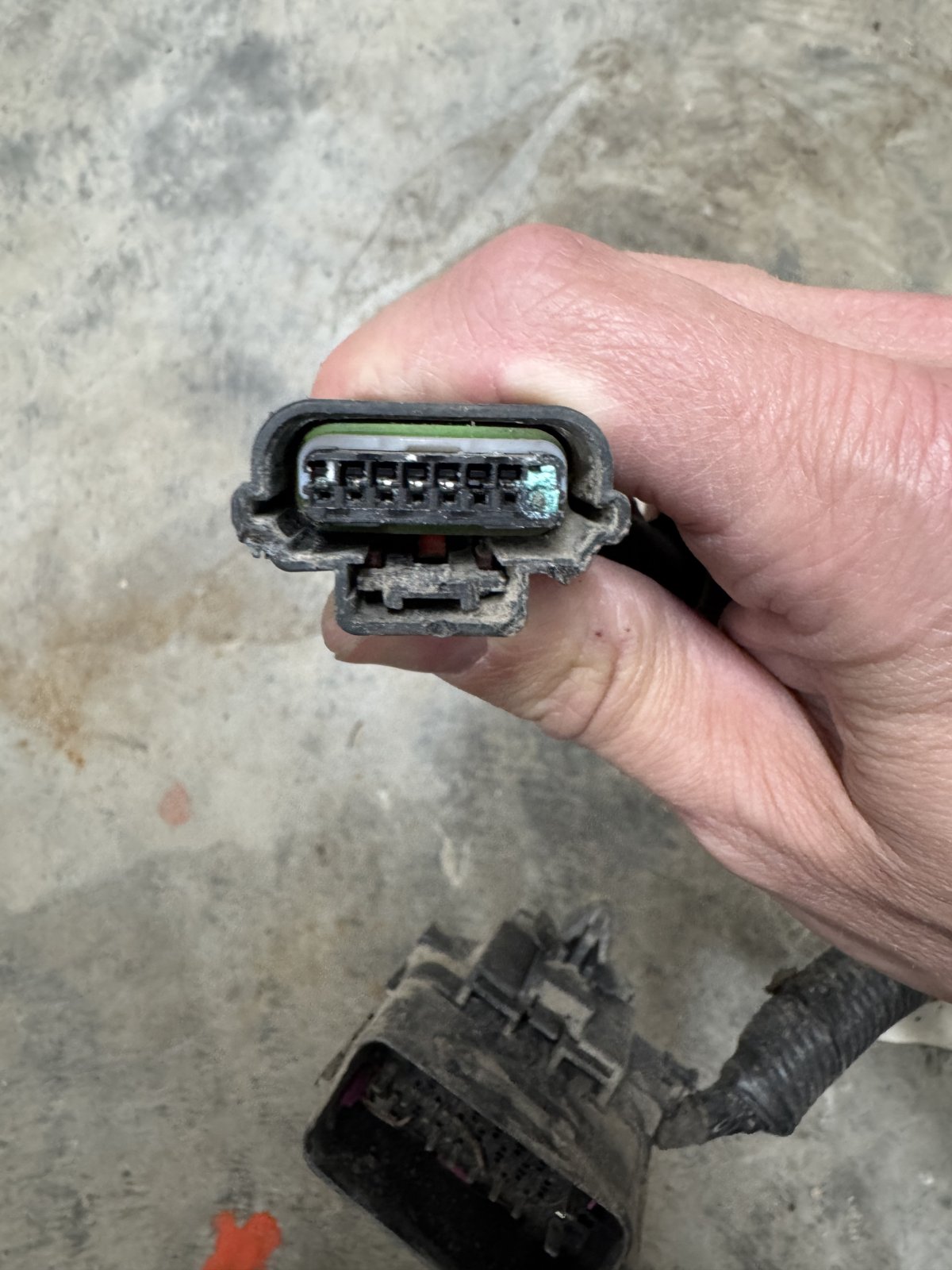

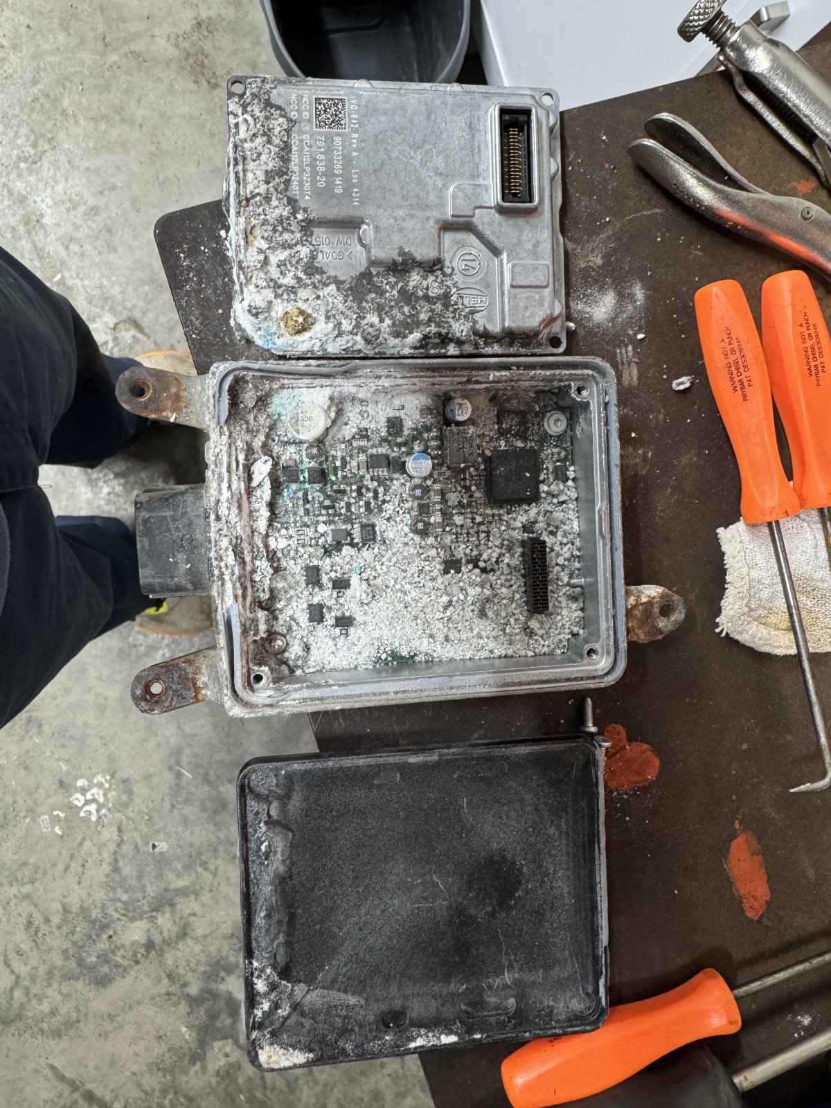

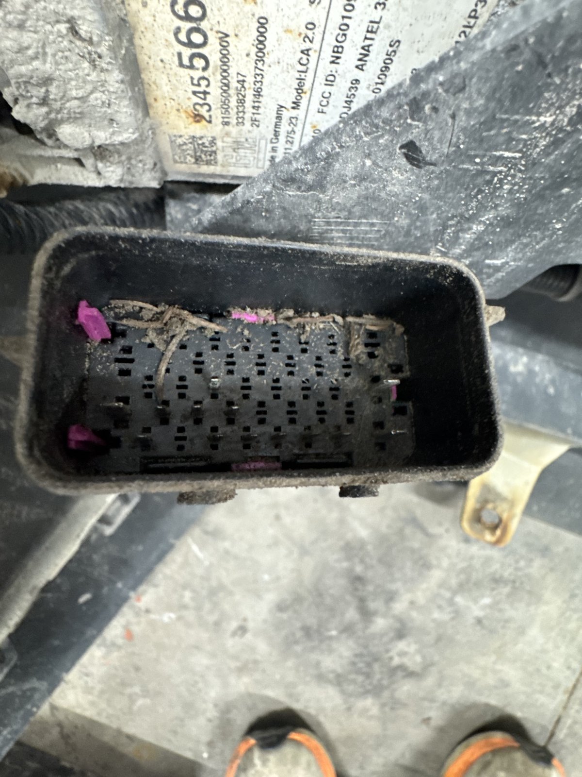

Sorry I thought I was on a different thread, I did fix this issue but it wasn’t what everyone has been mentioning. The fix is remove your rear bumper and unplug the harness that connects to your blind spot sensors and back up sensors. What I found was that over years of driving in 4 seasons the blind spot sensors fill with water, freeze, split open and short out, this causes the faults we’ve been getting. I unplugged the harness back in May and haven’t had a single issue since, repairing it is an extremely expensive fix, I was quoted 900 for each of the blind spot sensors, 500 for a new harness, then the required programming. I felt that back up sensors and blind spots sensors weren’t worth the 3k for the repair so I just unplugged it all and took the vehicle end of the plug, filled it with dielectric grease and put a good quality freezer bag over it, taped the hell out of it and stuffed it up under the passenger side tail light so it wouldn’t see water again. I’ve included some pictures of the headache pieces. It’s a quick fix, can easily be done in under an hour at home. I hope this helps your problems too, It’s embarrassing that GM calls this quality work.
