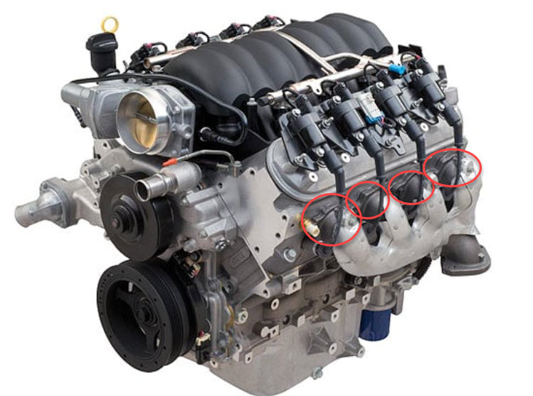

Take a look at the engine on both sides where the exhaust manifold attaches to the engine block. There are 4 exhaust ports on each side that the exhaust manifold connects to exhaust the fumes through the exhaust system (catalytic converter, exhaust pipes & mufflers). At each of those 8 mounting points (4 on each side of motor) where the exhaust manifold attaches to the engine, look to see if you have an missing/broken bolts and/or black soot around that port.
I attached a photo and circled in red where to look.
Visually sometimes the bolt is still there but its actually broken further down.
If any bolts are loose, missing or broken or if black soot is present around any of the ports, that could be the source of your ticking sounds.
If it is the case, there are much cheaper and easier ways to fix it rather than removing the exhaust manifolds to remove the broken studs.

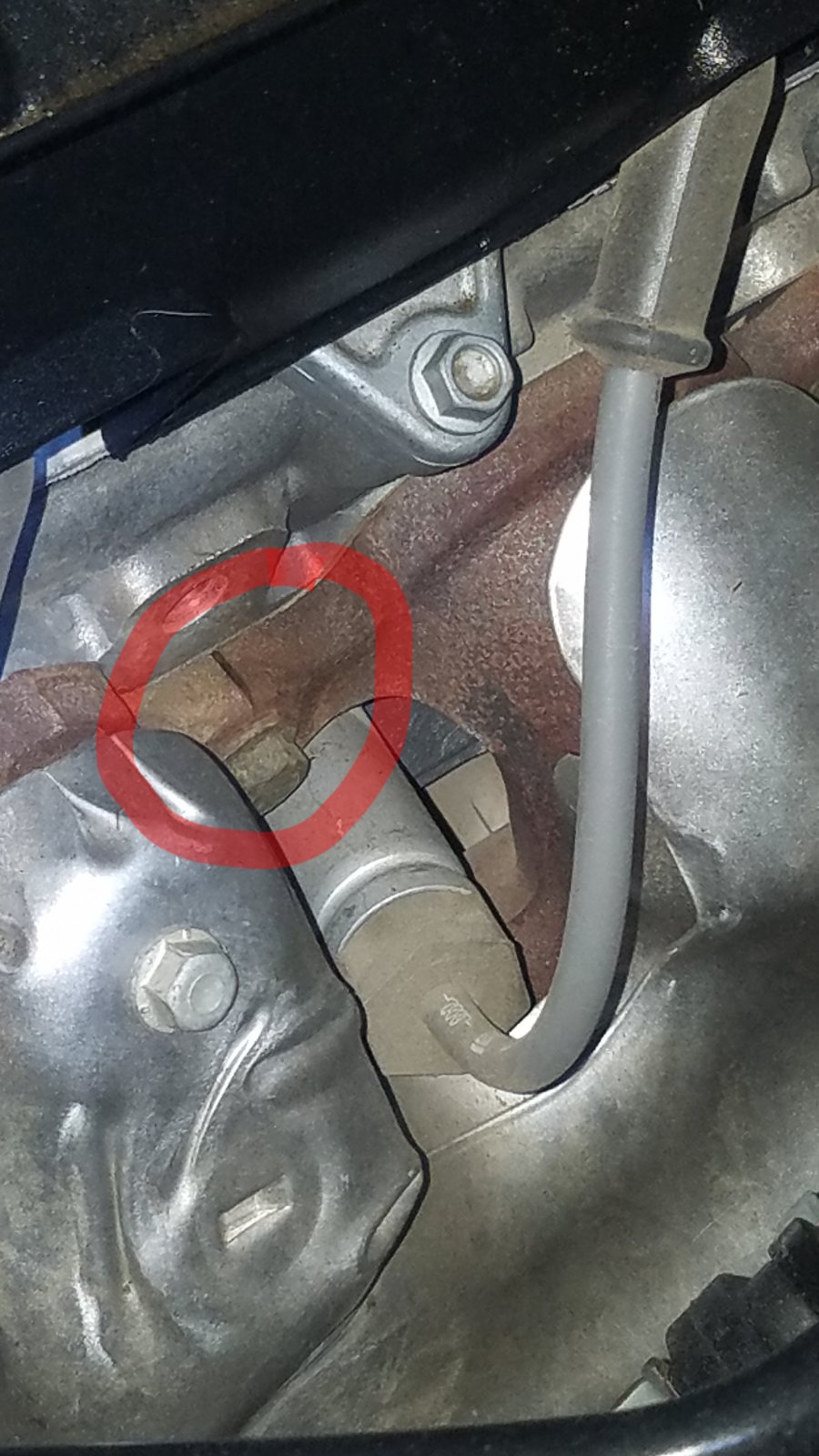

I did a quick visual inspection on the manifold both sides. Passenger side tough to see but looked ok. So did driver side. I wasn't able to look on the bottom side.
I did note and circle in attached pic what looked and felt like cracks in the manifold on both sides above bolts but these appear to be designed that way, is that correct?
Confirmed same on all the ones I can see on my 2015 Yukon Denali 6.2.
Appears to be designed that way.

They are like expansion joints in concrete. The metal expands and contracts and the little spaces allow for that....IMO.
That is what I was thinking. It kind of reminded me of multiple sets of headers (OEM & aftermarket) I had on my 2000 RT Durango 5.9 V8.
