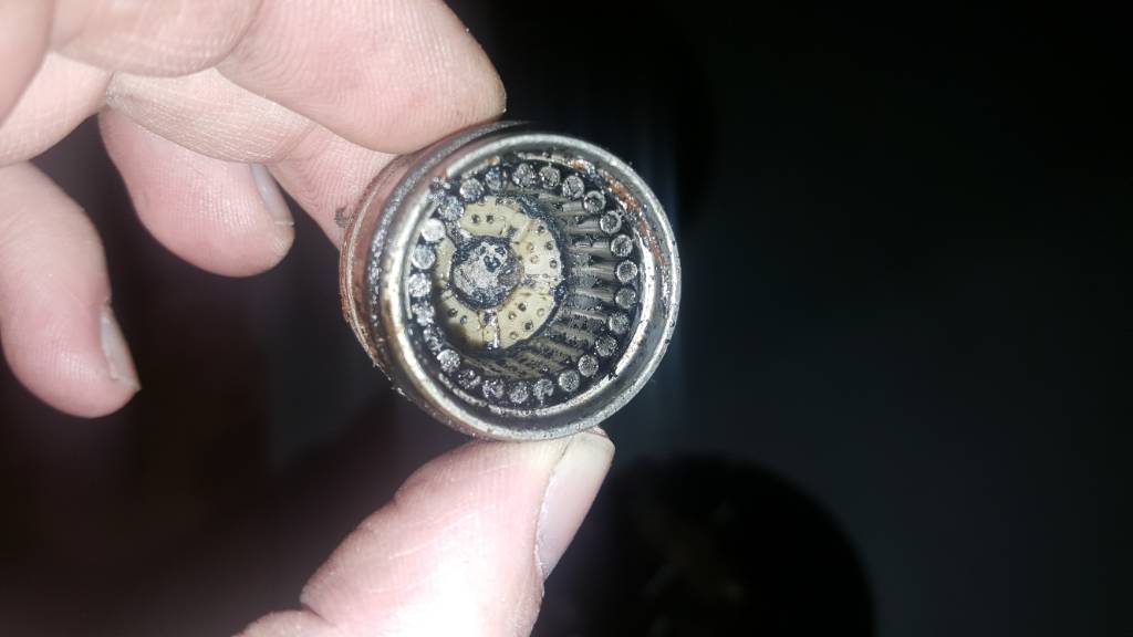

I got the mechanic's stethoscope. I couldn't find a single thing with the interior that was at issue. I am thinking perhaps it's the rear universal joint. My guess is it's completely dried up w/ little or no grease. Unfortunately, I don't have one with a grease zerk. Curious what Universal joint to you recommend?

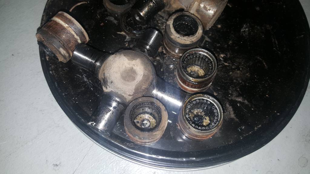

I think I was looking at the original ujoints witb 230k miles on them. They looked fine although a bit low on grease and grease was dirty. Was amazed they were in the condition they were though. There was zero slop in them too.

Complete annnnnndddddd
Was a complete waste. The squeek is elsewhere. Also i wouldnt recommend greaseable ujoints. No matter how much grease i pumped in there, rhere always seemed to be one joint that didnt get grease. Ug...
