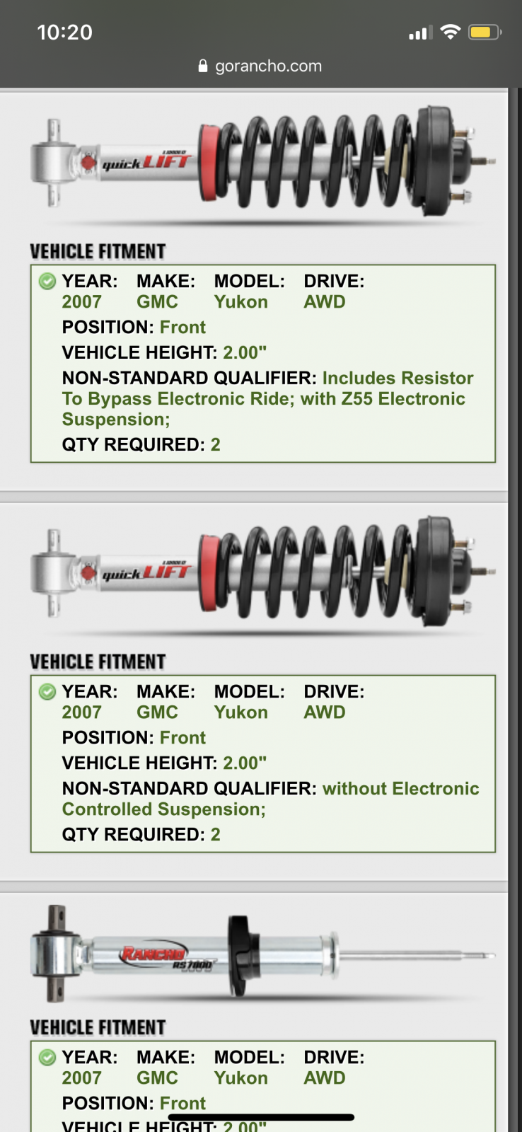

2007 Yukon Denali here. Got rid of the autoride years ago. I’ve got a 2” (or 3” as I can’t exactly remember) coil spacer that works perfectly for me. I then use the Rancho (darn it...been awhile and forgot the part number! I believe it’s the RS 5000). Anyways...if I already didn’t have the coil spacers I was going to look into these from Rancho...
I do like the Rancho shocks, though. Good ride from them. Ugh...got the wrong year for those Ranchos...anyways, you get the idea.
