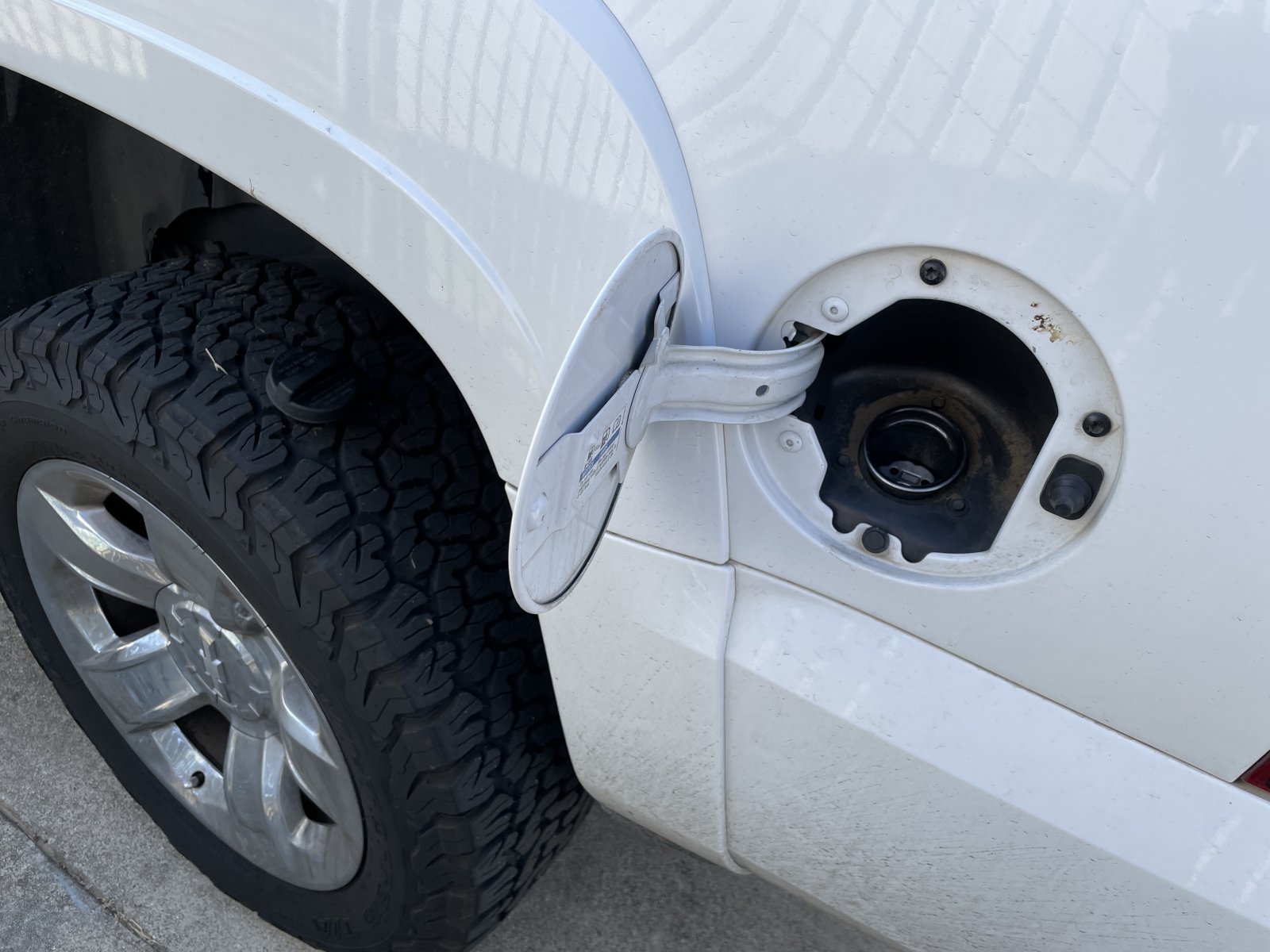

Hello gentlemen, in the middle of the night on the 4th of July someone stole gas from my Tahoe while it was parked in my driveway. I went to leave for work the next day and discovered my gas cap on my rear tire.
I put the gas cap back on the Tahoe and drove to work. On my way home from work I filled up with 91 at my usual gas station, but ever since then the motor has idled a little rough and on the freeway my Tahoe has a little shimmy like an unbalanced tire or slight misfire.
I just redid my front brakes the day before my gas was stolen so I am going pull my front tires back off and inspect all mating surfaces but I have this paranoid/OCD feeling in the back of my mind that the stealing of the gas caused something to happen with either the EVAP system or they got dirt in my tank. OR the gas station just switched to summer fuel here in California. Either way my motor isn't running as smoothly as it did a few weeks ago.
Today I filled up another tank of gas and the Tahoe had a very notable rough idle immediately after starting it from filling it with gas.
Along with having my property violated! My Tahoe isn't running as well as it used to and I want to see if there is anything I can check on, I am hoping these are just the early stages of a EVAP failure. I have had a history of not being able to fill up the gas tank in one go, the pump always clicks so I have to hold the nozzle at a special angle to get to a full tank.
Lesson learned, locking my Tahoe every night and installing security camera.
Anything you guys can think of or am I just paranoid?
This is how I found my tahoe:
First, I have tried to siphon gas out of my own vehicle to use in a lawnmower, and I discovered it is blocked even using a very small hose. I'm wondering how they got to your gasoline. Second, remember, security cameras do NOT prevent crime, they only document crime. Unless the crime is very serious, or you know the perpetrator, the police will have no interest in your video.

@ZKWBQD I think at this point the consensus is that they weren't able to get anything out of the gas tank, most likely a failed attempt. The fuel level was low on my accord

The only difference I can think of in the caps would be the color and the gasket material. The black cap might have a gasket that is not resistive to the E85, and might decay over time. But that's just conjecture on my part and if the gasket on yours is in good shape now, running E85 in the short term shouldn't cause any problems. Long term you may want to get the yellow cap for it, or run with the black cap and see what happens. The only job that cap has is to seal that filler neck.
If they put something in the tank it's not going to affect the evap system, at least not right away. It would be more fuel contamination than anything. But not knowing if they did add something, it's hard to tell if that's the case.
If your VAN'S 8th character is a "Z", you have a Flex Fuel/E85 vehicle. I have had two, a 2001 5.3 Suburban and a 2005 Yukon XL 5.3. Both had black Fuel caps from new. The Yukon now has 237K miles, and did have evap vent and solenoid problems, which set a CEL, and caused Fuel filling problems, but I never had a rough idle or running issues. I replaced the vent valve and the solenoid, which resolved the problems.
