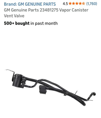

OMG I replaced the complete EVAP on this truck and still getting p0446... I replaced the vapor canister vent valve, solenoid, (upgraded version) charcoal canister and stlll p0446.
Oh and I forgot to mention, I dropped the fuel tank and blew all the EVAP lines out and none were clogged.
If you have experienced this or have any ideas what's going on please inform.
Replaced gas cap probably 3 months ago cause information kept saying loose gas cap...
And the CEL doesn't come on for this code. CEL works because it lights up when I start the truck. I check the codes with my cheap OBD scanner, lol.
TIA my friends
can you share what parts brand was used if not oem
also what is the mileage out of curiosity

And the charcoal canister was some off brand, like $30. I felt the charcoal canister was probably all the same no matter manufacturer as bad as that sounds lol
