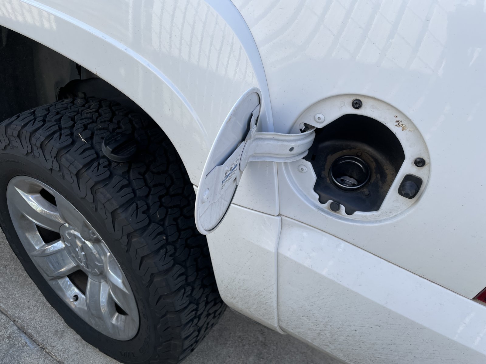

Hello gentlemen, in the middle of the night on the 4th of July someone stole gas from my Tahoe while it was parked in my driveway. I went to leave for work the next day and discovered my gas cap on my rear tire.
I put the gas cap back on the Tahoe and drove to work. On my way home from work I filled up with 91 at my usual gas station, but ever since then the motor has idled a little rough and on the freeway my Tahoe has a little shimmy like an unbalanced tire or slight misfire.

This is how I found my tahoe:

That totally sucks. I'm not sure if they would actually be able to get any gas out with a siphon on these trucks, but I've never tried either.
I'd do an inspection underneath to see if they knocked anything loose in their attempt

Is there anything in the fuel filler neck between the tank and the hole that they could of knocked around or damaged?

Virtually impossible to steal gas out of the tank.
Much more likely that something was put into the tank.
I'd start with running some good fuel injector cleaner, like BG 44K, and see if that helps. Then, I'd do other "tune-up" items - air filter, spark plugs, etc.
I don't think so, unless they went underneath and messed with the vent or something. I was under the impression that most new tanks had some sort of blocking device that prevented siphoning.
After reading further, I would agree that something was PUT into the tank. Maybe sugar, piss, etc. People are idiots.....

Any CEL? You already knew you had evap system problems? My guess is that they tried, could not get fuel and dumped something in there but maybe damaged this too:
If you do the try to address the evap system do the entire system. If they dumped something, it could be in the entire system. Sucks.

@OR VietVet No check engine lights and yes I had pre-existing fuel filling problems.
I inspecting under the Tahoe near the filling neck and nothing was tampered with. The Tahoe was completely unlocked but it doesn't look like they opened the doors because all my stuff was inside. I am hoping they just attempted to steal gas and left empty handed but here we are
If something was dumped down the filler neck would it go straight to the tank or would it hit the EVAP system first?
