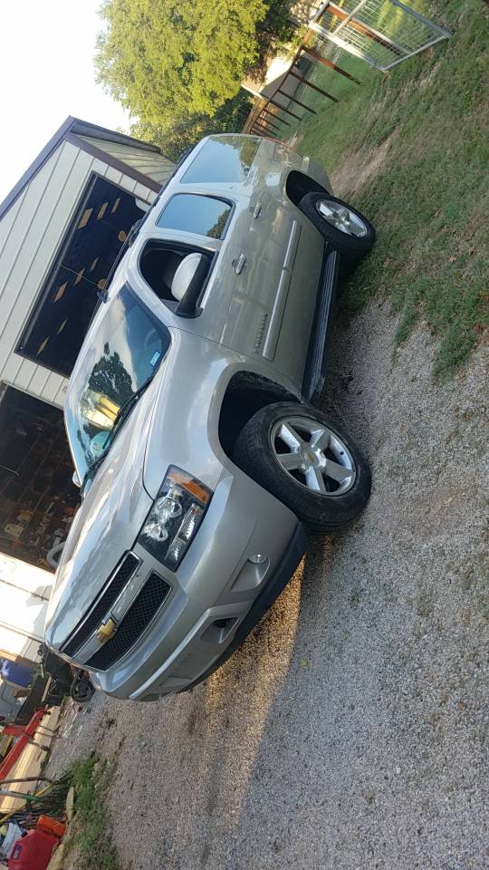

Knocked out some stuff yesterday.
Did the top engine cleaner, changed spark plugs, installed lift, switch to synthetic oil.
Spark plugs 1 and 6 were bad. Mpg went way up on the drive home. 17-18 at 80mph.
Have a tuner on the way, going to disable afm. Hopefully this fixes me up.
If not will be doing the valve cover replacement.
Sent from my SAMSUNG-SM-G891A using Tapatalk
