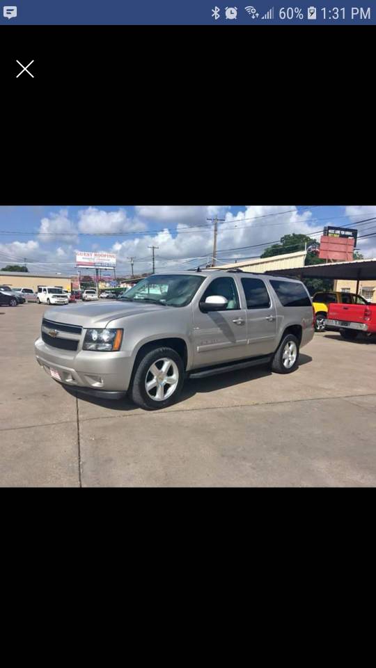

Hey guys, still having major sellers regret. Sold my tahoe. Had a lot of work into it.
Picked up a super clean low miles 07 Burban 4x4, two owner, all maintenance done at dealer.
Plan was to leave this one stock.
Week two of owning, limo tint, exhaust, and 2.5" front-1.5" rear lift in the mail. Also adding K&N drop in.
I want to add tow mirrors, and i want to add the factory touch screen. Is this as simple as plug and play? I have the double din radio with a slot for dvd and cd. Bose.
Will post updates and pics as i go.

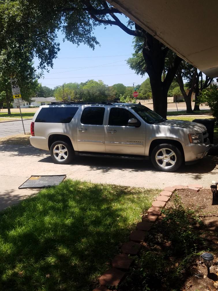

Limo tint and eyebrow done.
2.5" 1.5" lift, 2" wheel spacers, Green interior and puddle light LED kit on the way.
Going to delete resonator and install black 4" tip tomorrow morning.
When i get time also going to do tow mirrors, and swap in a touchscreen with backup cam.
