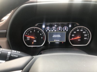

Just bought a 21 High country and experiencing the first gremlin. Getting a popup on the dash and the airbag light goes on. Popup says "Service Safety Restraint System". It lets me dismiss it and both the popup and light go away. Seems to come back after a period of driving and or the next time that I am in the car after about 5-10 minutes.
I will snap a picture of the popup.

Finally having this fixed tomorrow. I am told that the part is a Deadener which equals a piece of tape! More updates to follow as I will certainly try and find out which sensor or module needs the tape. I was also told that there is an internal bulletin about this.
For the record the issue has become pretty annoying where I get the message every few seconds on a short drive.
image.jpeg View attachment 255155

Just git back from the dealer... Document ID#5642786 "Installed Butyl tape to Inboard (Driver) Side Airbag connector."
Could be a TSB or recall coming on this.
