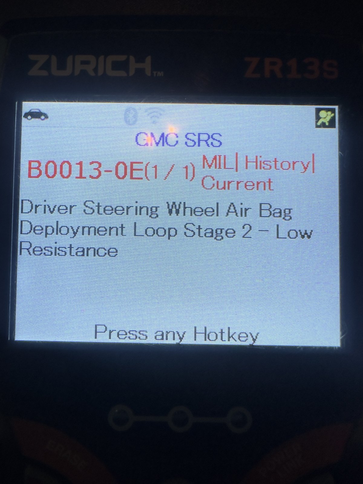

I tried disconnecting the battery, crossing the cables, removed the airbag, checked connections, replaced everything, and still get the Service Air Bag fault. Here's what my Harbor scanner shows:

I'm not sure if the diagnostic path will help you, but here it is:
Here's something I notice from that...
Conditions for Clearing the DTC
* The condition for setting the DTC no longer exists.
* A history DTC will clear once 100 malfunction-free ignition cycles have occurred.
I don't know how you would have low resistance on the airbag circuit from removing it...
But at least you know it needs to be between 1.3 and 5.1 ohms now...
And you might need to have 100 key cycles for it to clear if it somehow happened from being unplugged..

Or a dirty clockspring connection. These circuits are very susceptible to small things (like a partial short or open at a connection) that disrupt the expected resistance. I'd inspect the clockspring connections and use DeOxit or similar to clean, then reseat them and make sure the locks are in place.
Of course, the clockspring itself might be defective. A short between two contacts could cause this.
