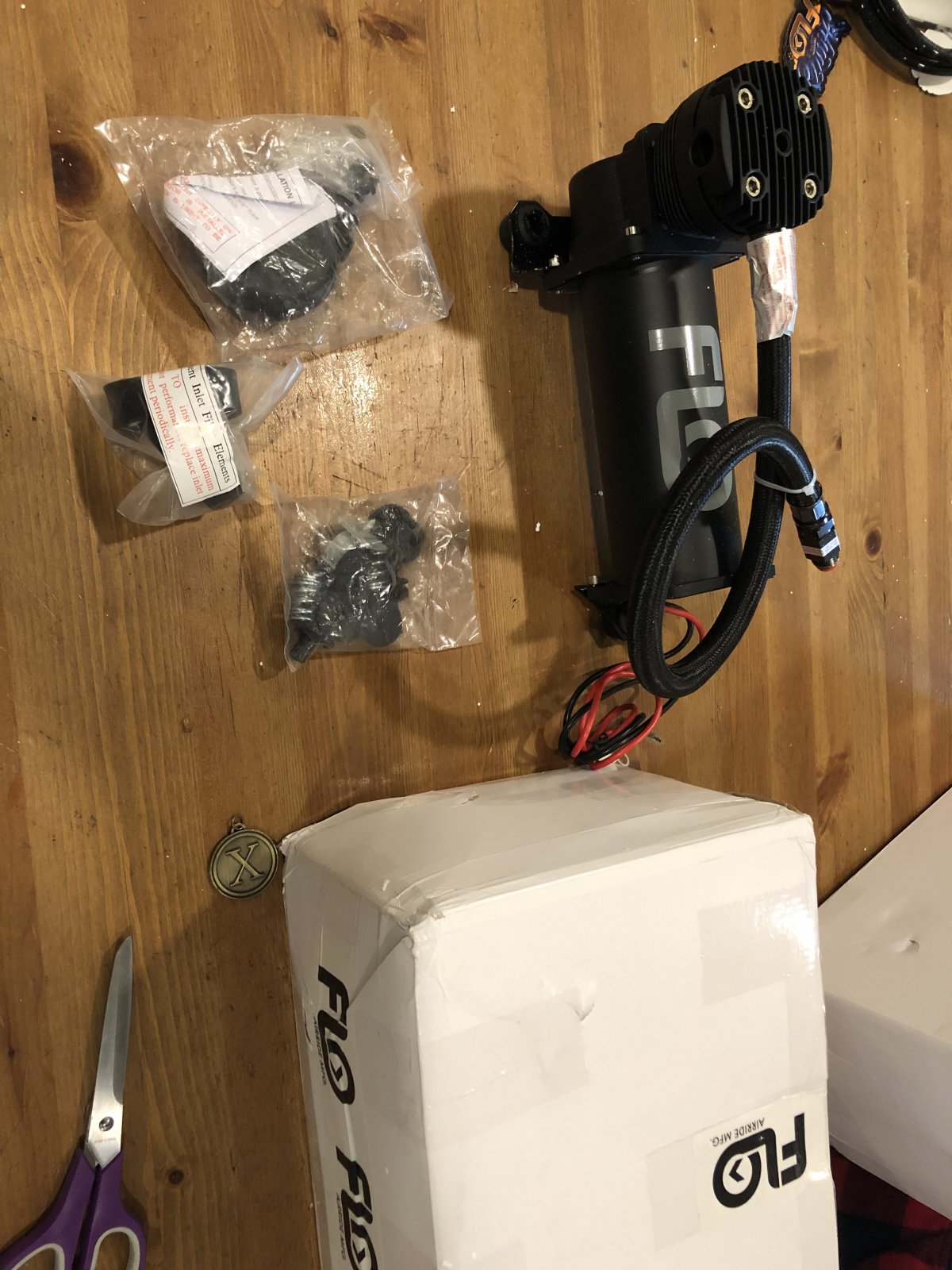

The FLO compressors list for $400 apiece; I used Messenger to hit up Mike Alexander, the founder of the company and after much discussion he said he could do the chrome ones for $200 each and black ones for $250 each. These are hard to come by right now. Since I hate chrome I asked him to sell me 2 black ones for the same price as the chrome ones. Done. Plus he gave me a discount on shipping which cost him $70 for 2 day and he charged me $46. They will be here Monday. I’ll update here when I get them.
52,954
I did tell Mike that I would be sharing my experience with their products. I like their tanks too but they don’t make a 7 gallon one. Yet.

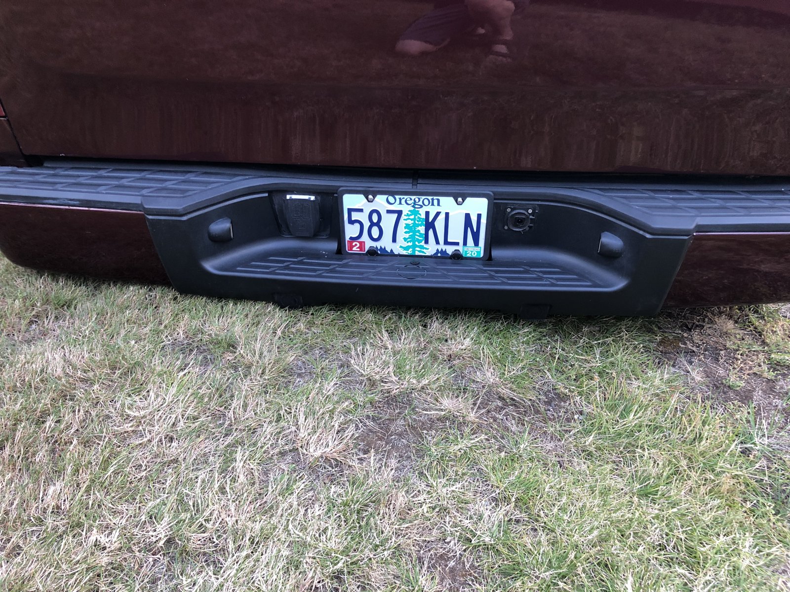

On the way back from dinner tonight I hit the down switch on the rear instead of the front after turning. (I always raise the front a bit when turning at an intersection) Since I run only 40 psi in the rear it came down fast and I dragged ass a bit. It’s never been a problem but this time it caught the plastic bumper parts on the bottom and pulled the center section almost all the way off and popped the spare tire hoist cover off. That’s where my backup cam is since I have no spare tire mech. I’ve been wanting to redo the cam and install the same one I just put on the Denali anyway. I didn’t take pics with the bumper part messed up, I was kinda mad at myself and just fixed it, but one of the tabs is broken so I ordered a new part, plus the new cam. As for the hoist cover, I can’t find one. I’ll come up with something, it just needs something over the hoist hole, not the stupid tube thing with cover.

Oh I want alright. But I think the pickup ones are different than the SUV ones. I can probably switch the whole thing I guess. Which do you have?
Edit: I just tried the one off my Denali and it fits. I’m just gonna order a new one, they’re cheap. Thanks though.

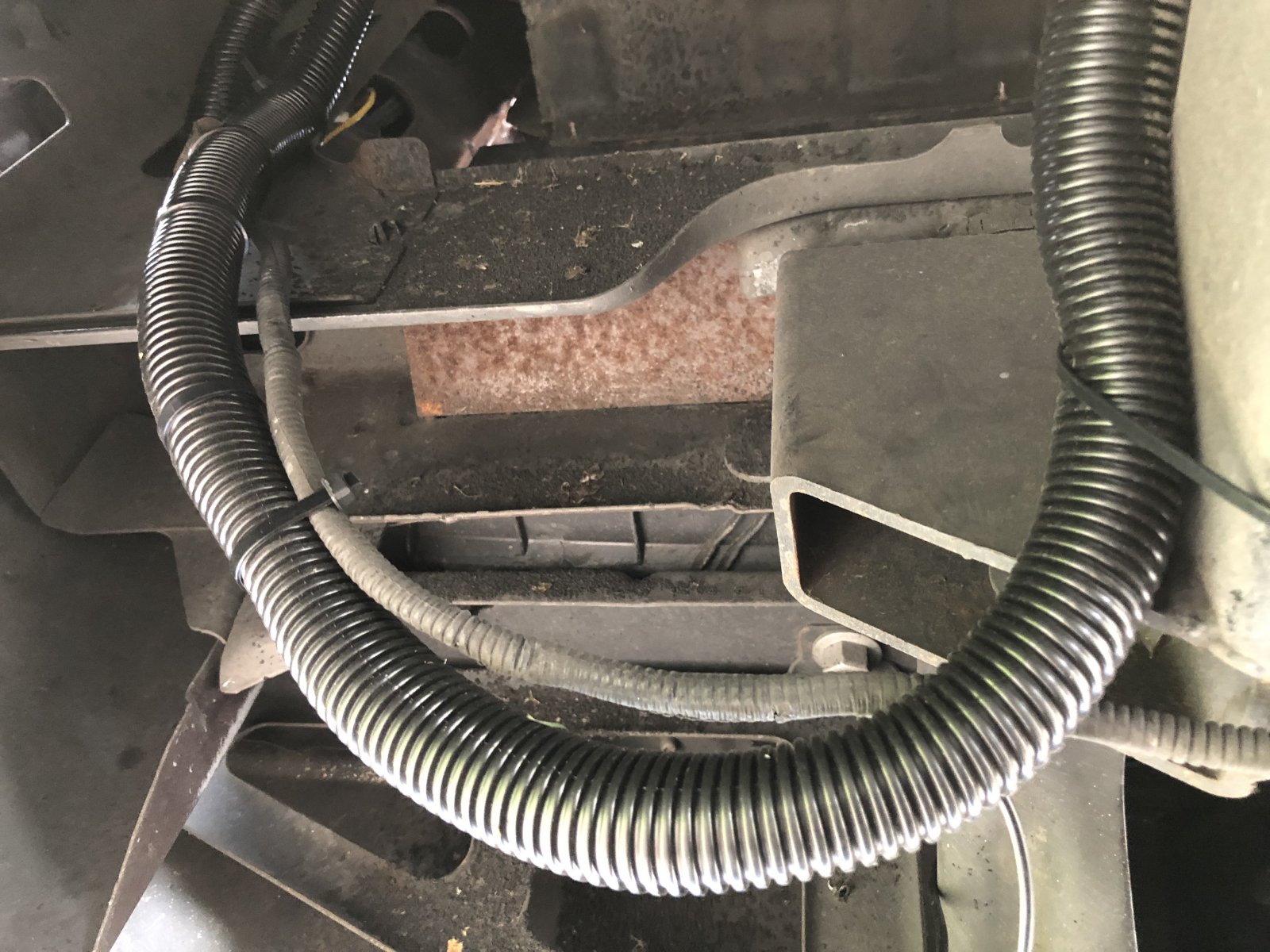

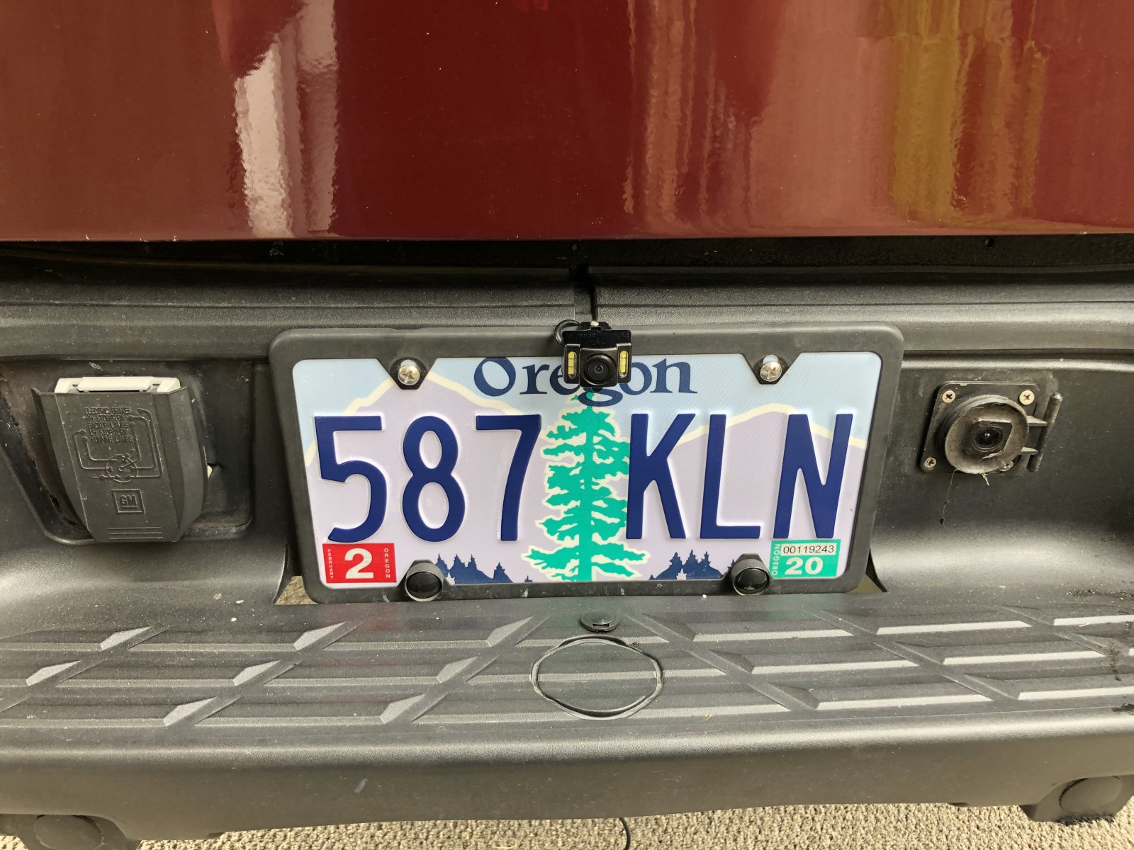

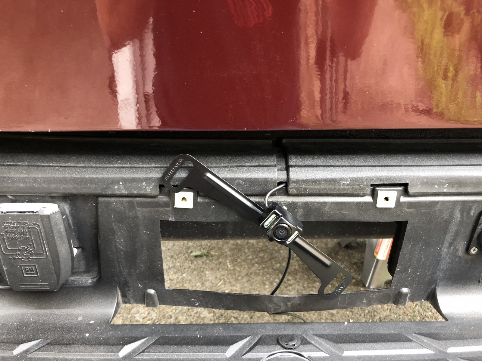

I installed the Auto-Vox Cam 1 today to replace the one that I had installed in the spare tire hoist location. I put one of these on The Beast and am real happy with it so I wanted the same on this. Great mounting, awesome picture. The one I installed in the spare tire hoist never did work too good. There was a place to run the wire through the center bumper piece and I took the opportunity to tidy up the wiring behind the fender. It can't be seen except from underneath but I know it's there. My previous work left a lot to be desired and I have no proof it ever existed lol.

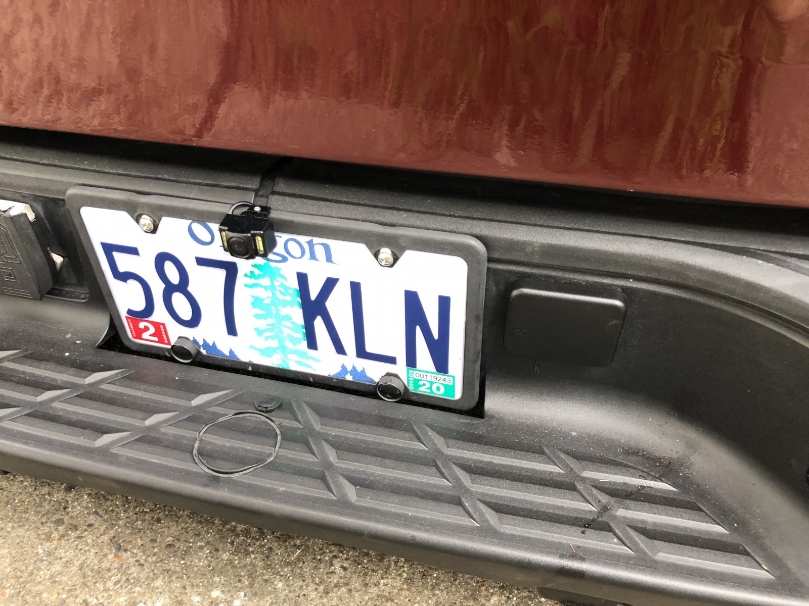

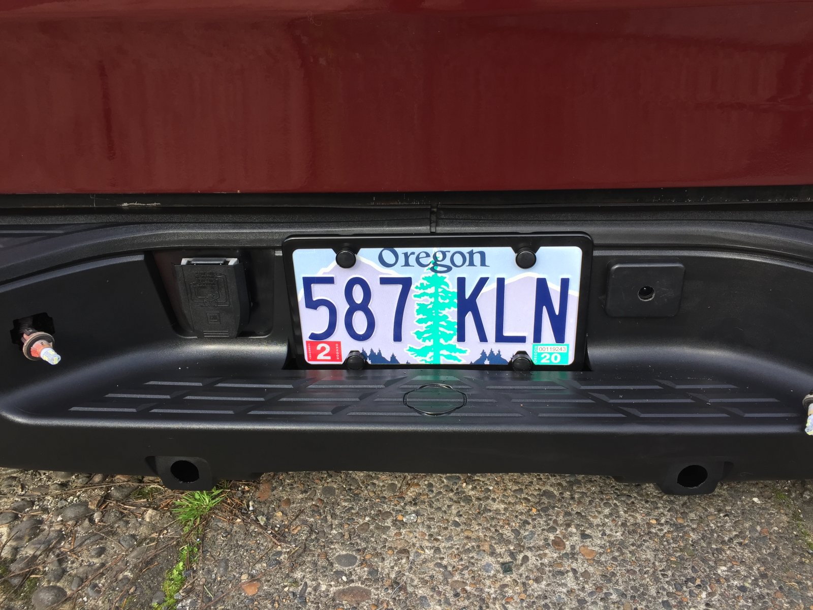

got the cover today. Rear view cam re-mod complete. The idea of putting the cam in the spare tire access cover would have worked ok if I'd mounted it closer to the cover itself so the hole was smaller. But this one works better anyway, and looks better.

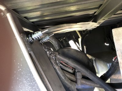

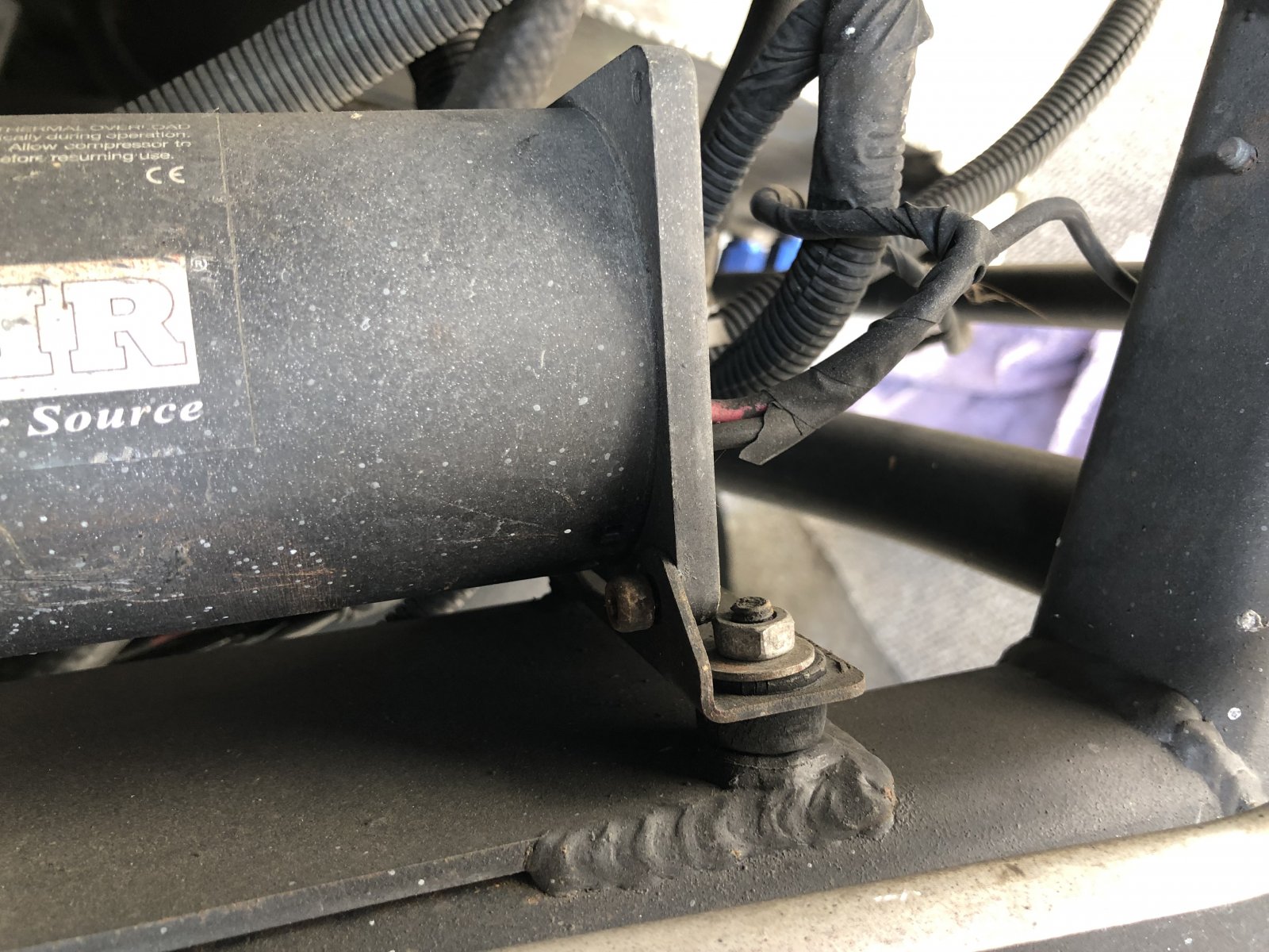

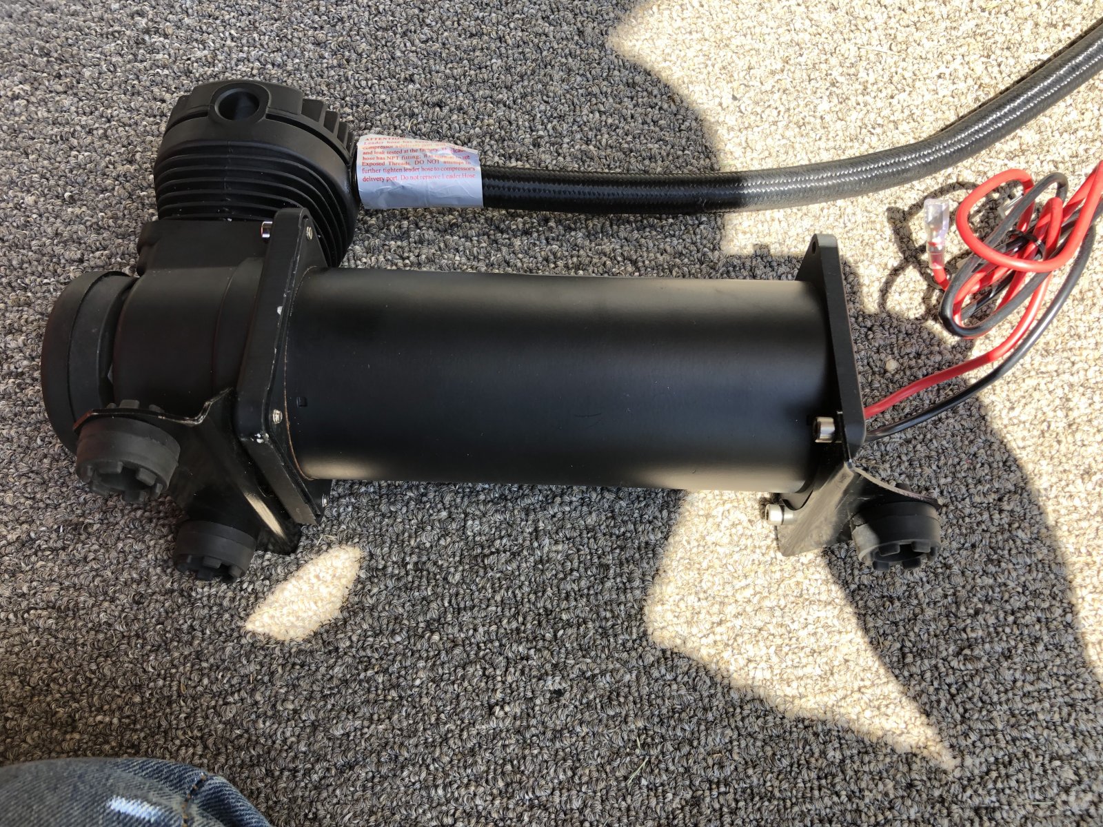

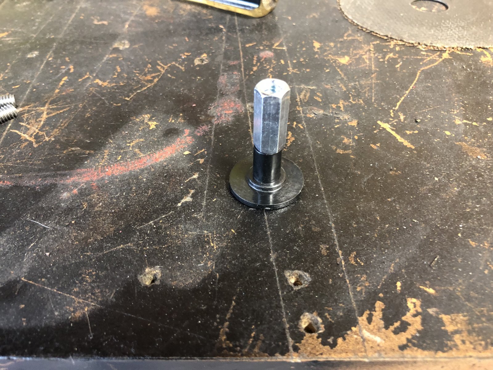

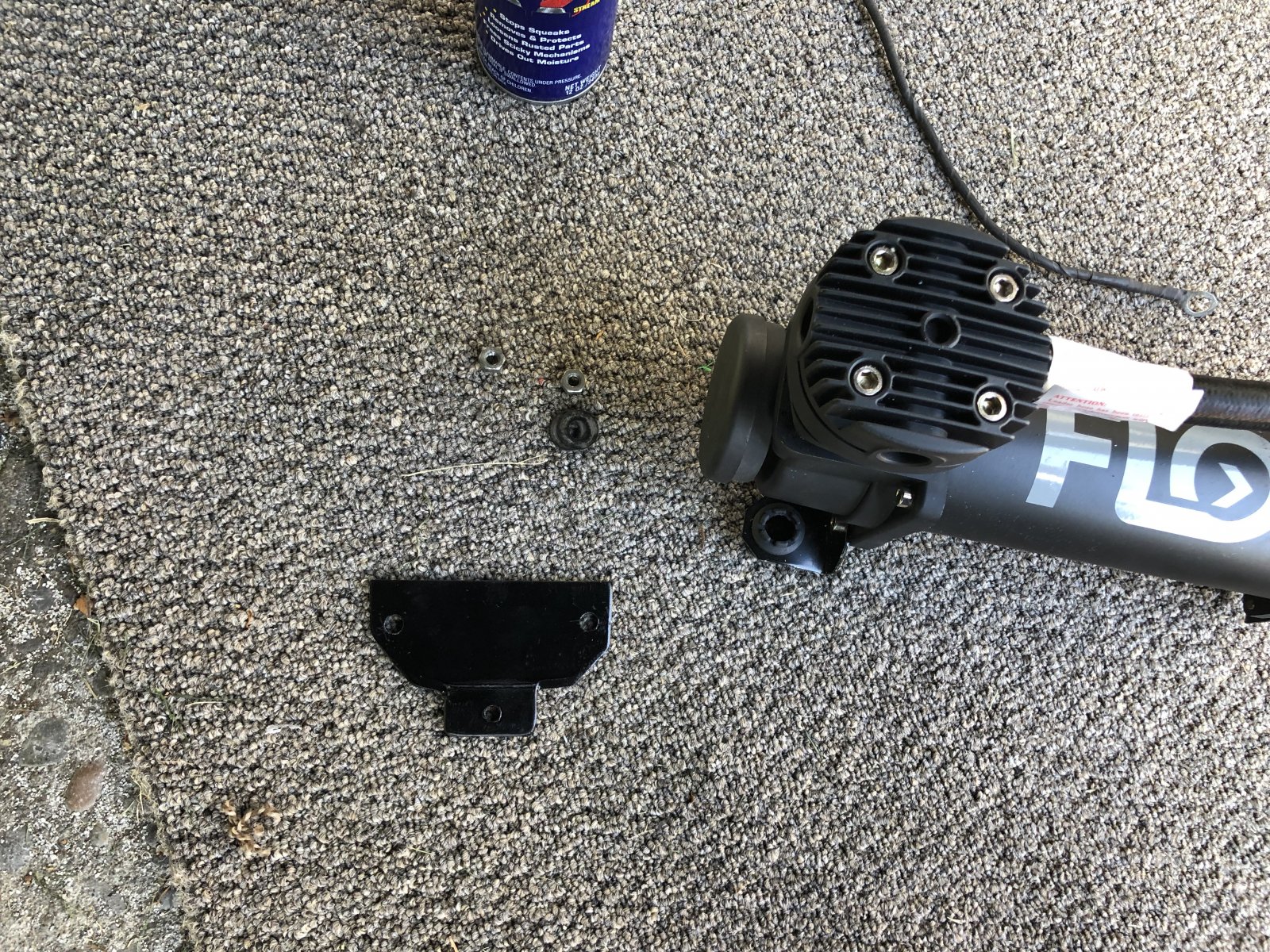

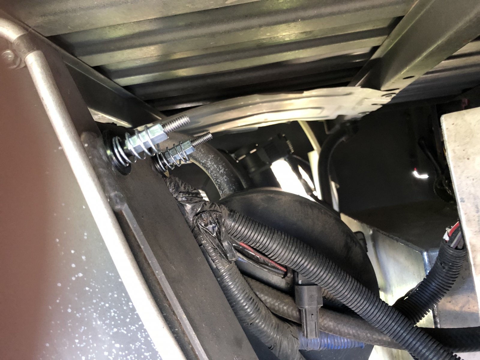

I started on the new comps this morning. First thing I found out is the mounts were different to the extent that I had to make extension brackets for the bottom mount because the plates the Viairs were mounted to were too short. The FLO's use 3 mounts with springs and rubber where the Viairs had 4 with just thin rubber. Mike Alaxander w/ FLO said these were prototype "Tri- mounts". The 1/4-20 bolts that were used on the Viairs were studs welded to the plates and were too short. The upper 2 were the correct center-to center though. The bottom 2 needed to be one, and it needed to be in the center and about 1 1/2" further down. I used coupling nuts to extend the upper 2 studs and made plates that utilized the bottom 2 studs to hold it in place and moved the hole down to where it needed to be. It worked out good. The spring mounts work great.
