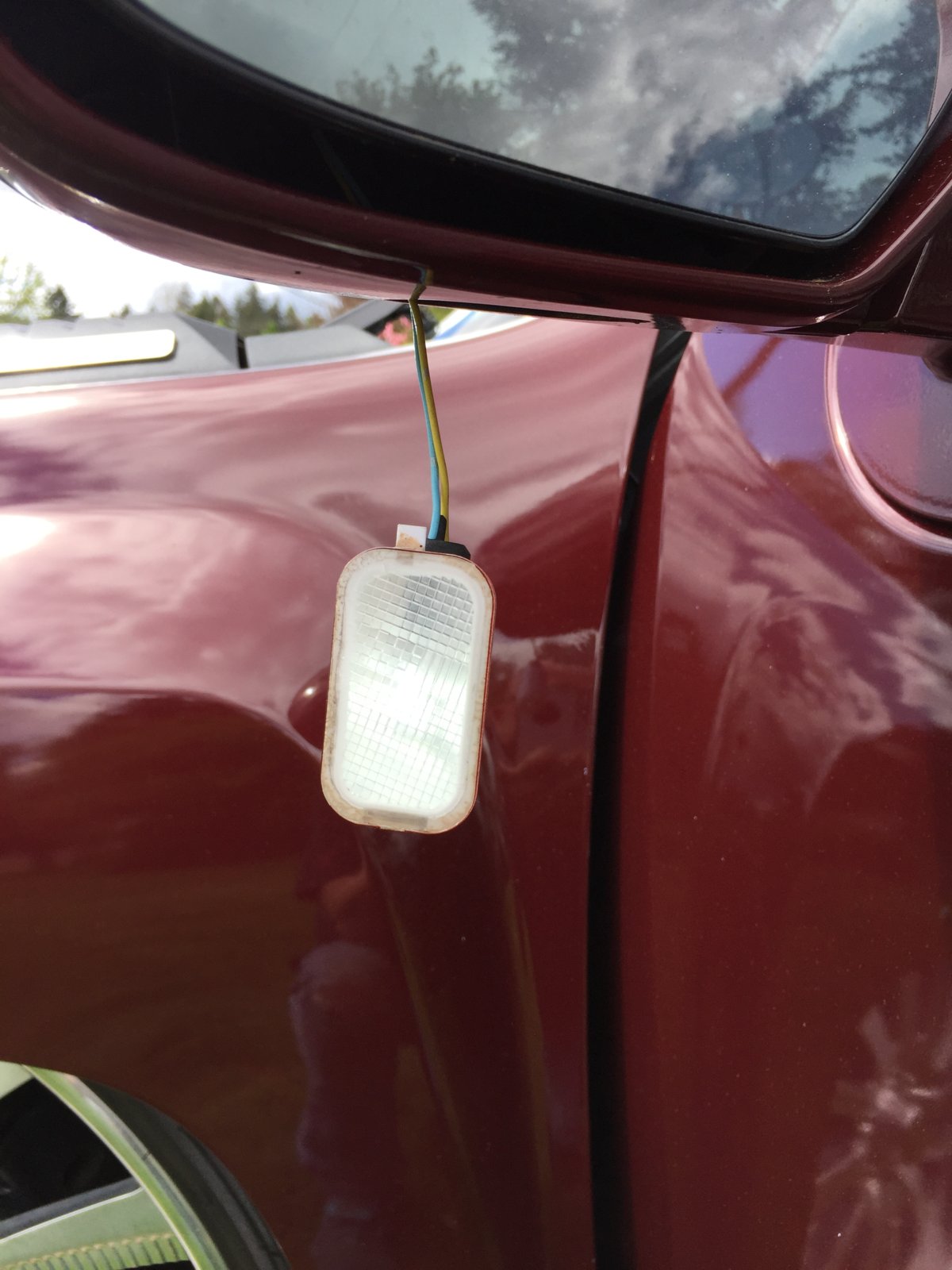

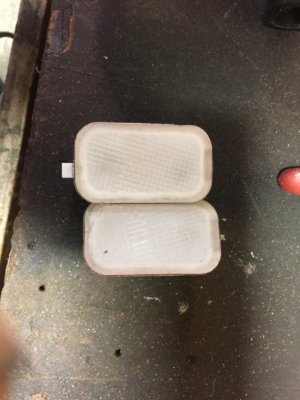

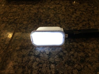

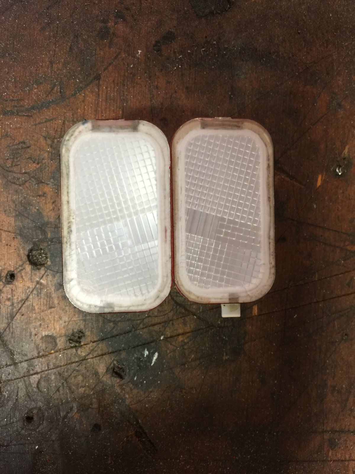

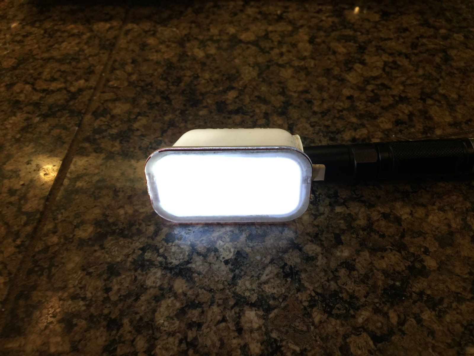

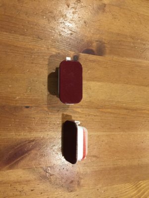

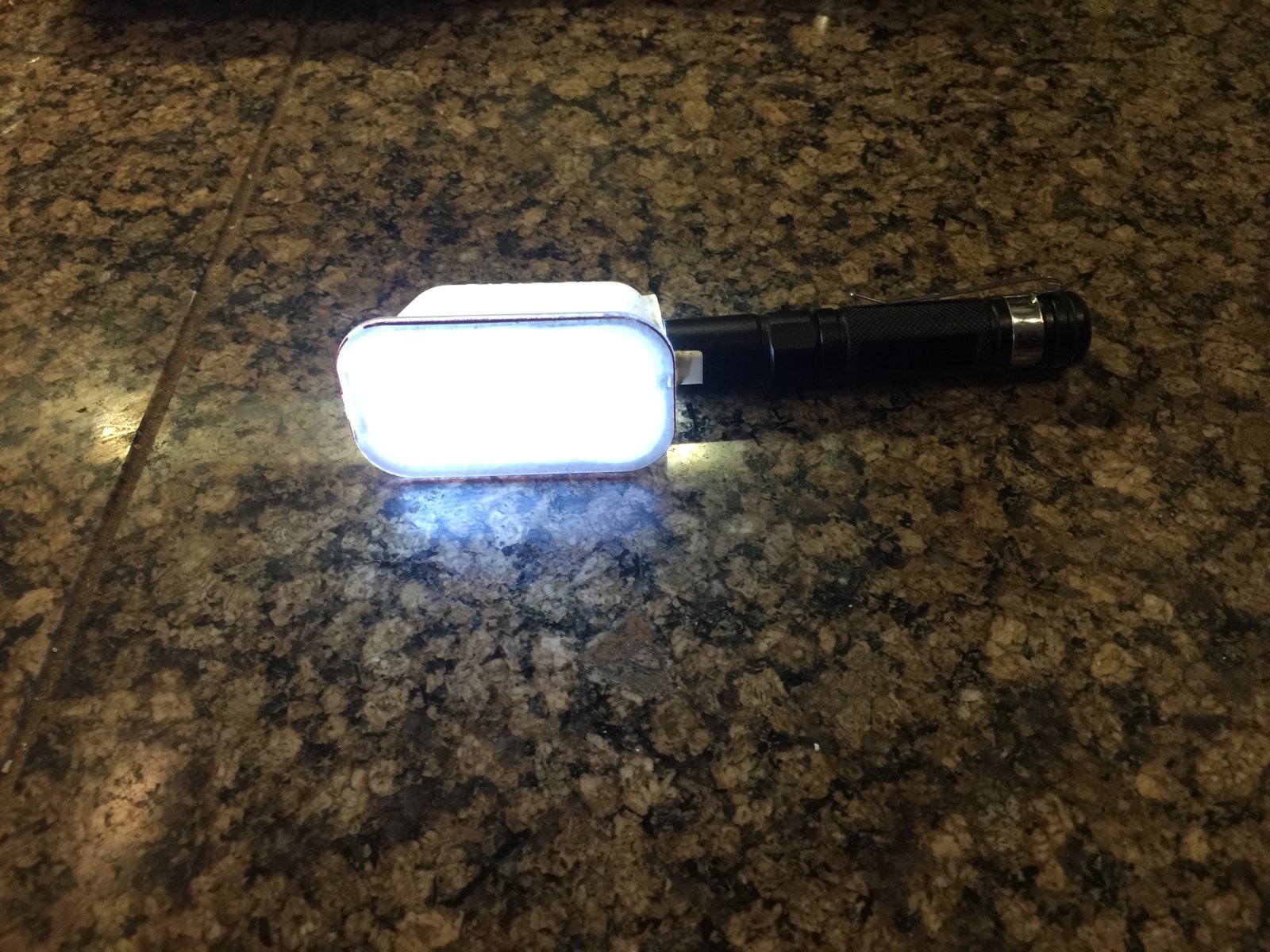

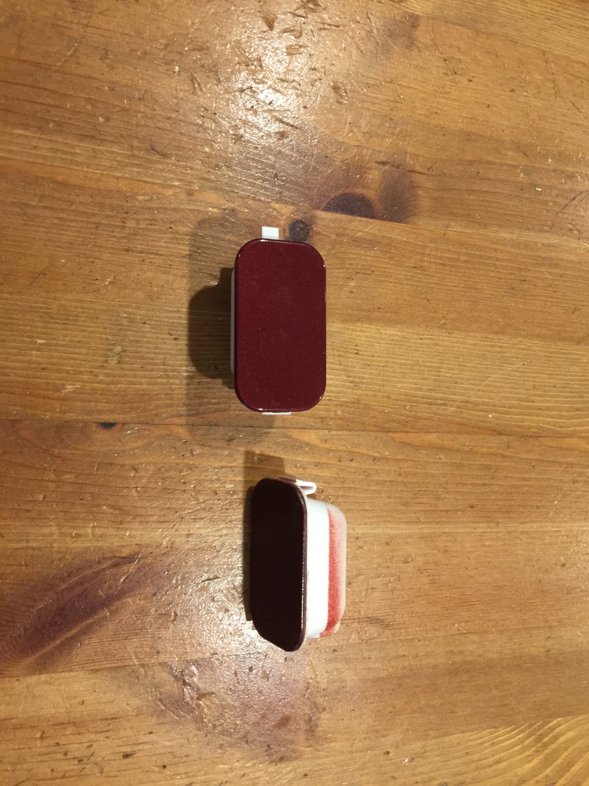

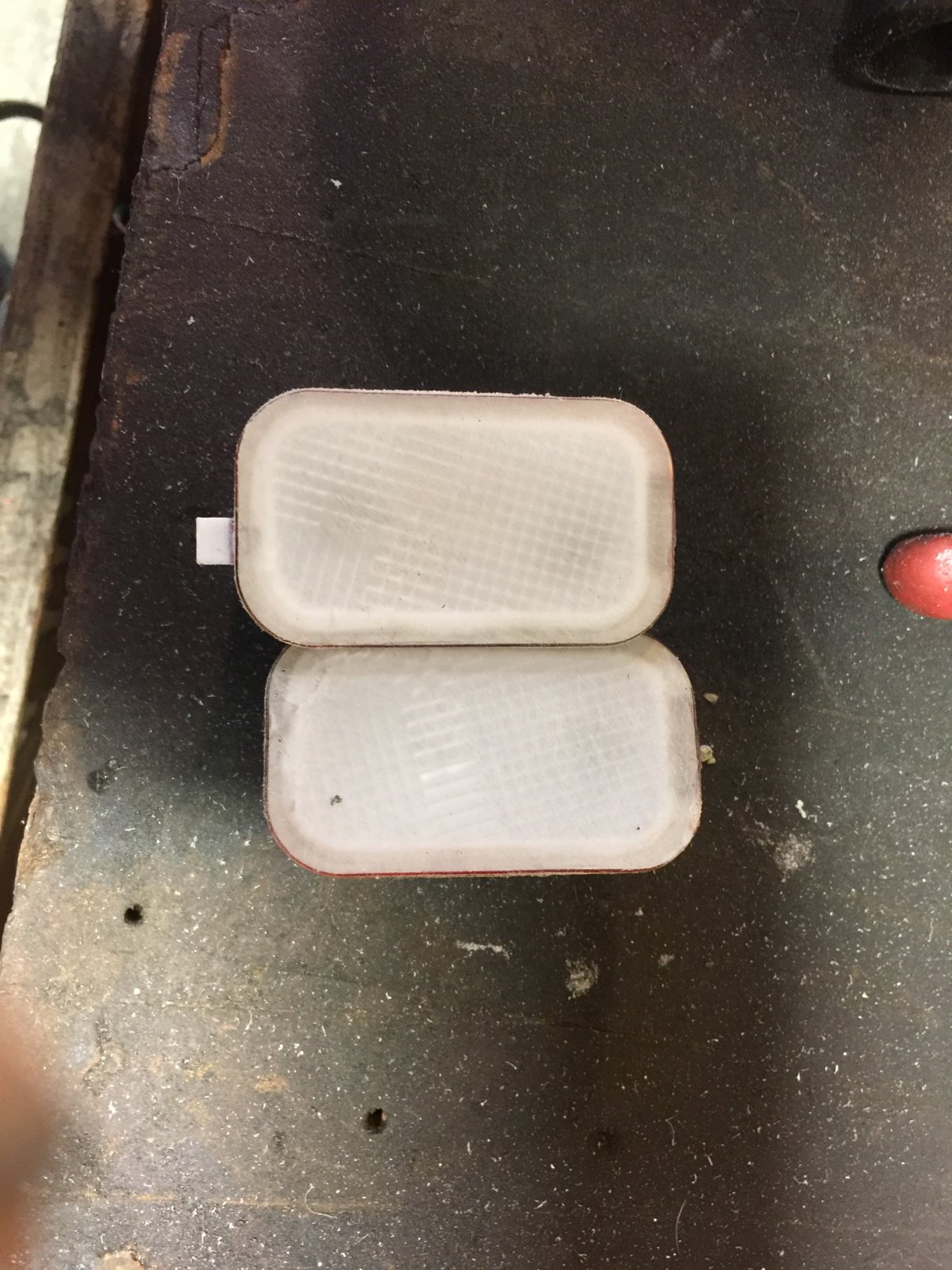

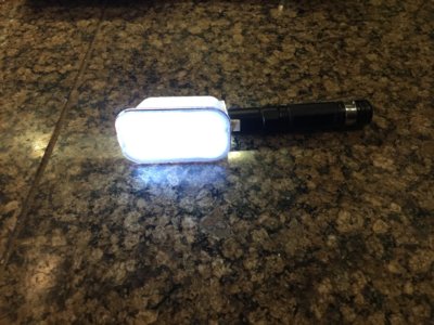

I noticed my outside mirrors have puddle lights but they aren't wired since they quit putting those in the NNBS Silverados. I think the mirrors are the power folding ones from a Tahoe. So I pulled the light housings because they were painted over and looked at getting some new ones, figuring they would be $5 or so. Holy crap, $20 plus shipping for each one. So I just sanded the paint off and buffed them with some Meguiar's Fine Cut. They should work fine. Now I just need to wire them to the dome light circuit and replace the bulbs with LED. Another almost free mod.

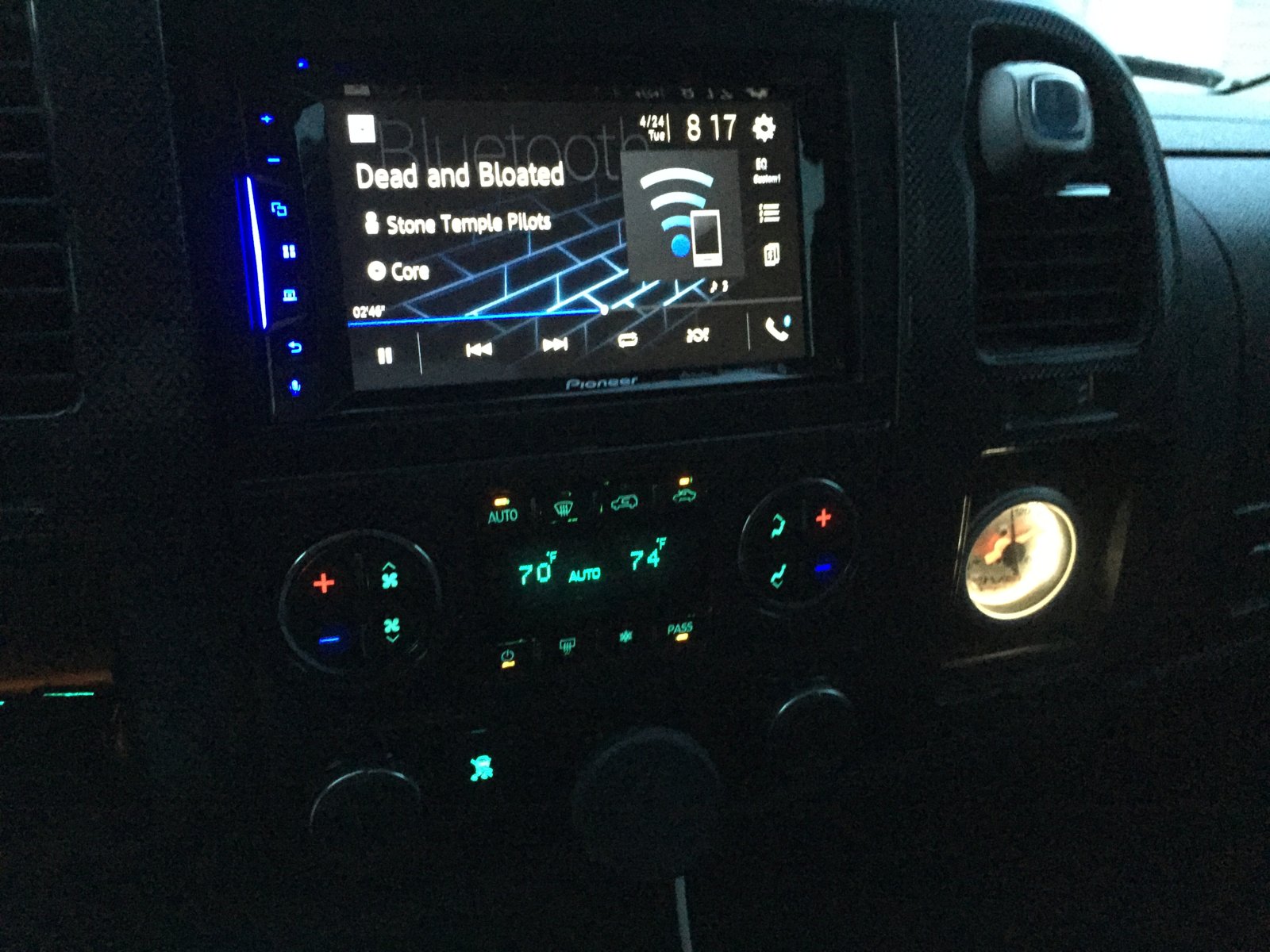

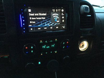

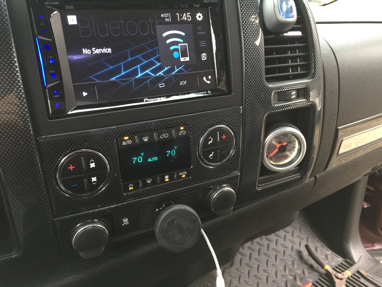

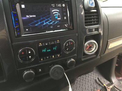

I installed the angled trim ring for the gauge today. It's better but I might re-do it to angle up a bit too. I didn't think about that when I modified the bracket and I'll have to see if I can rotate the trim ring without re-modifying it. You have to cut the legs to length, plus I had to remove material to clear the air line fittings and light. Anyway it's way better. Before and after.

I couldn’t remember......LTZs came with puddles lights, could be off that, or a suv, like you said. Odd they didn’t keep the ones without puddle lights and paint them instead of swapping to the ones with the puddle light and painting over it.....
It looks like they were the textured black ones, otherwise they probably would have painted them.

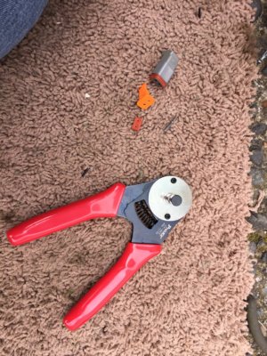

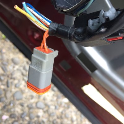

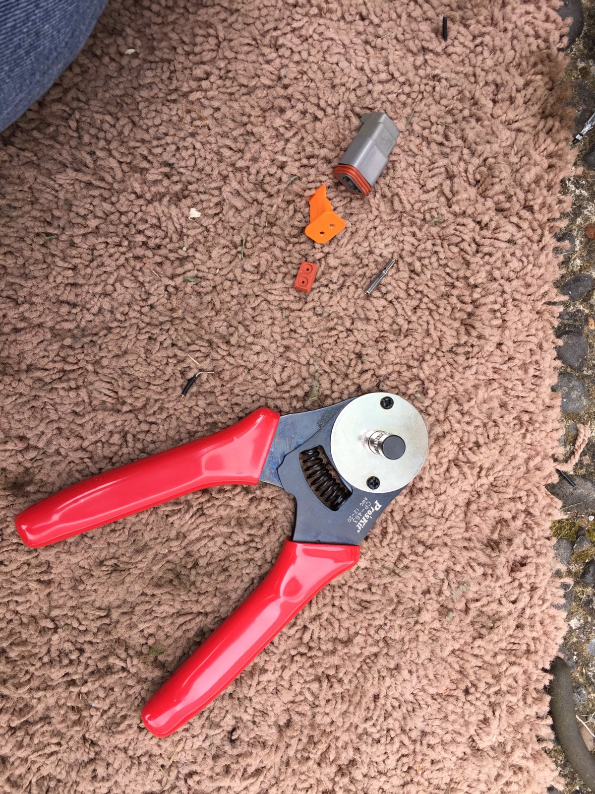

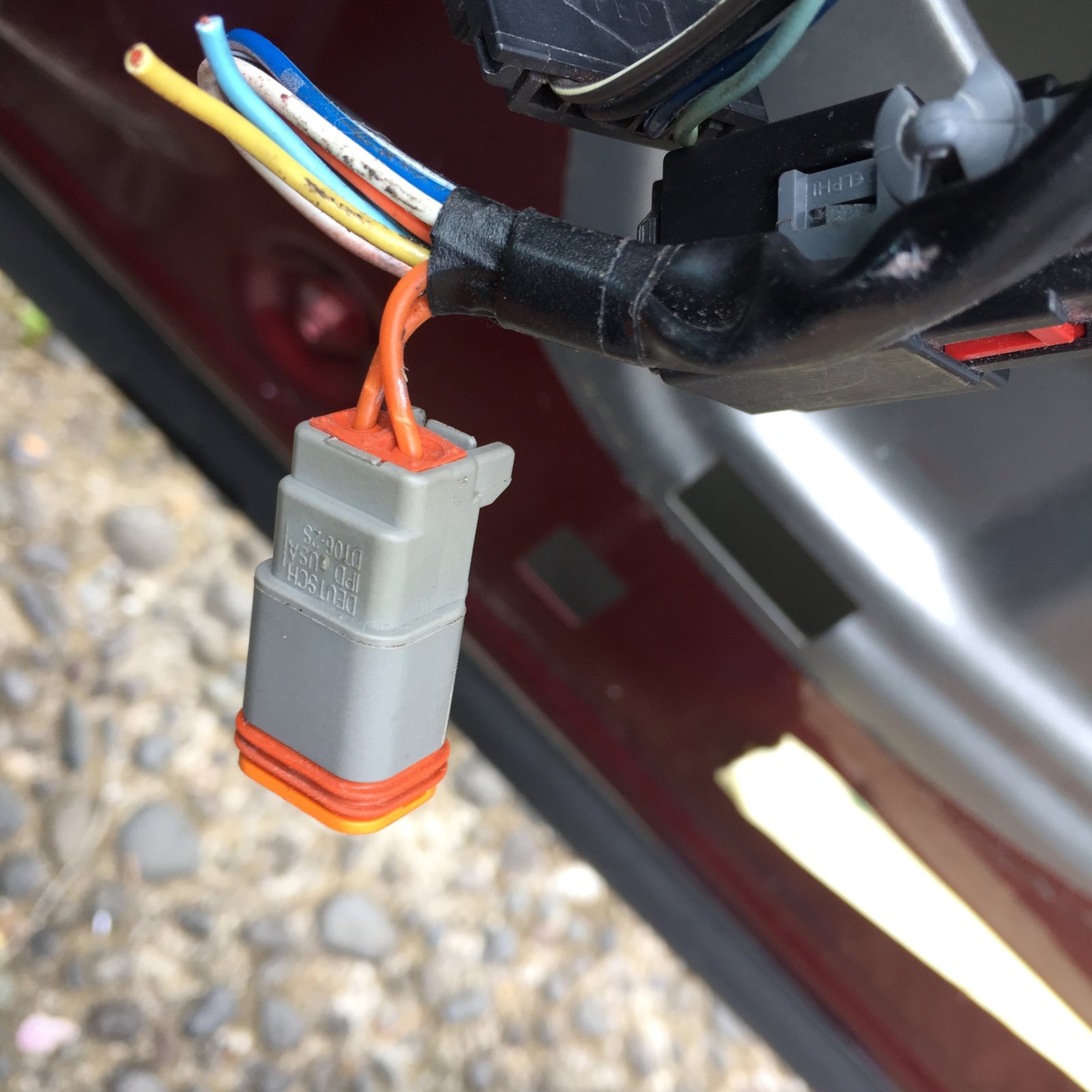

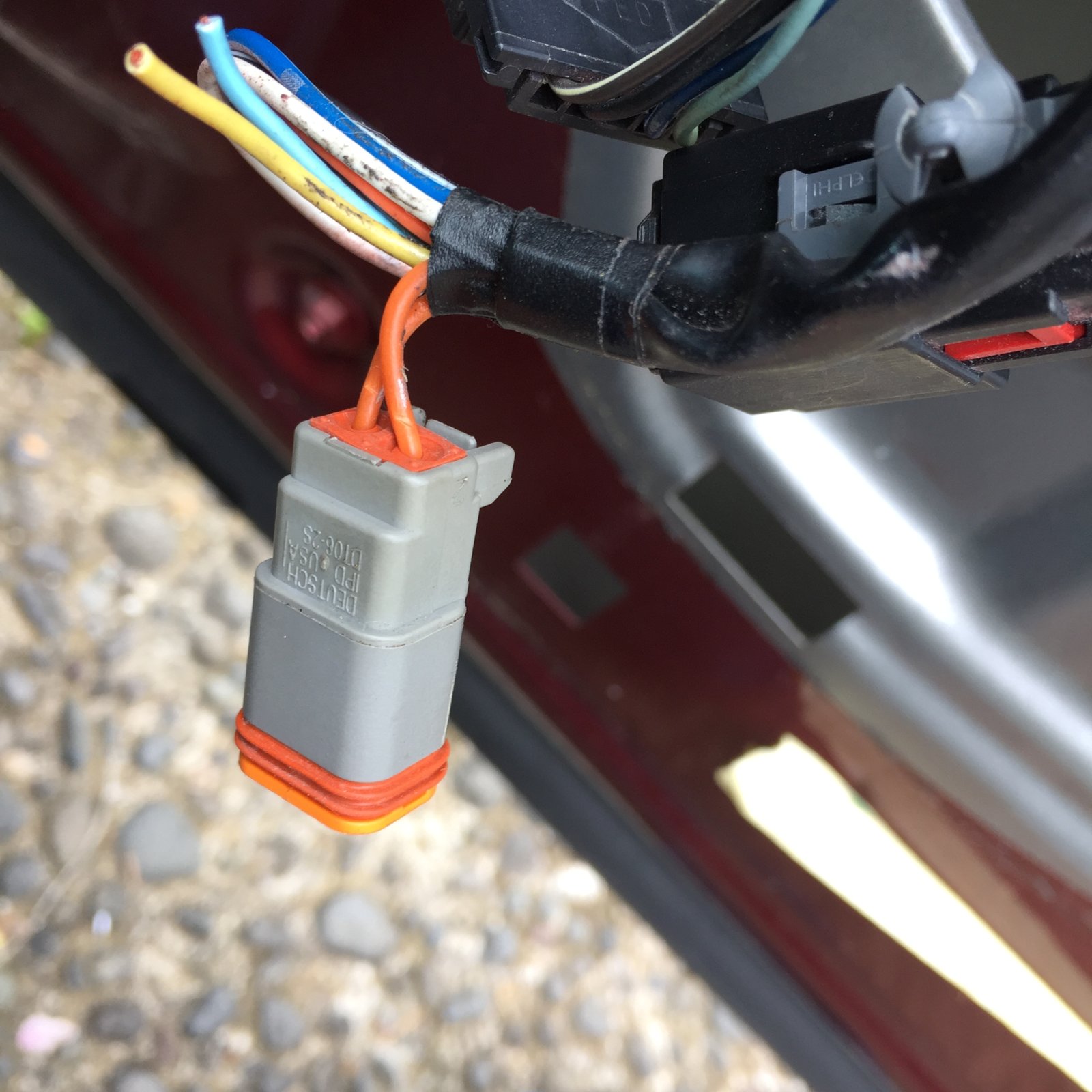

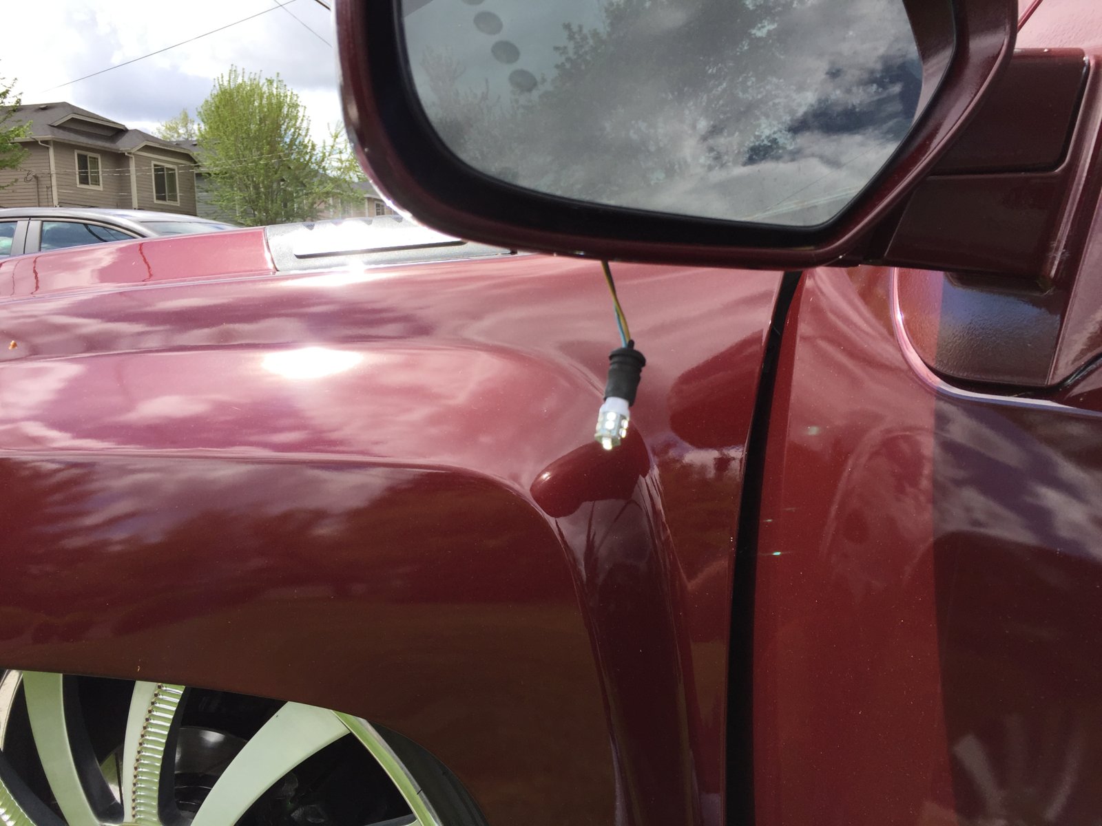

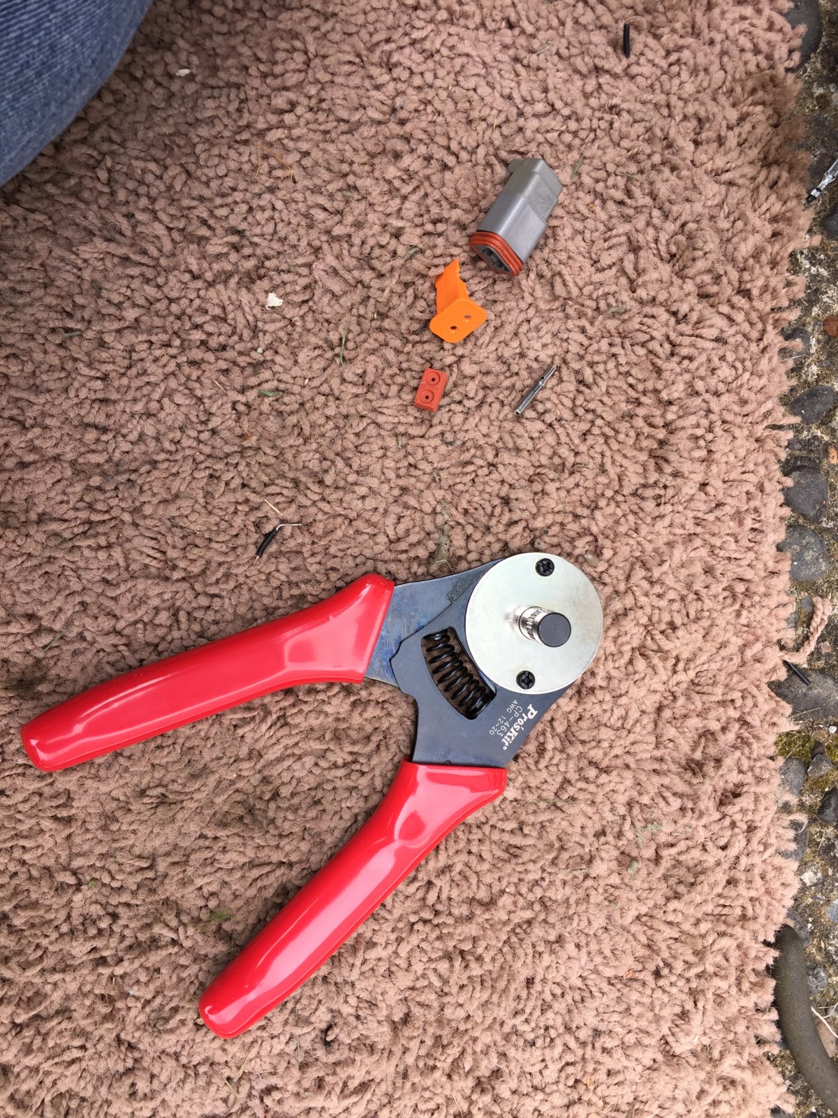

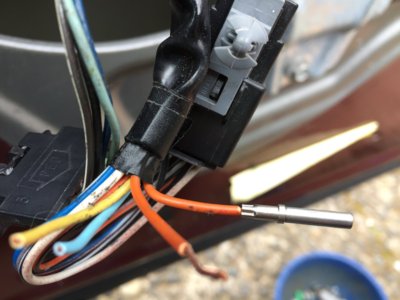

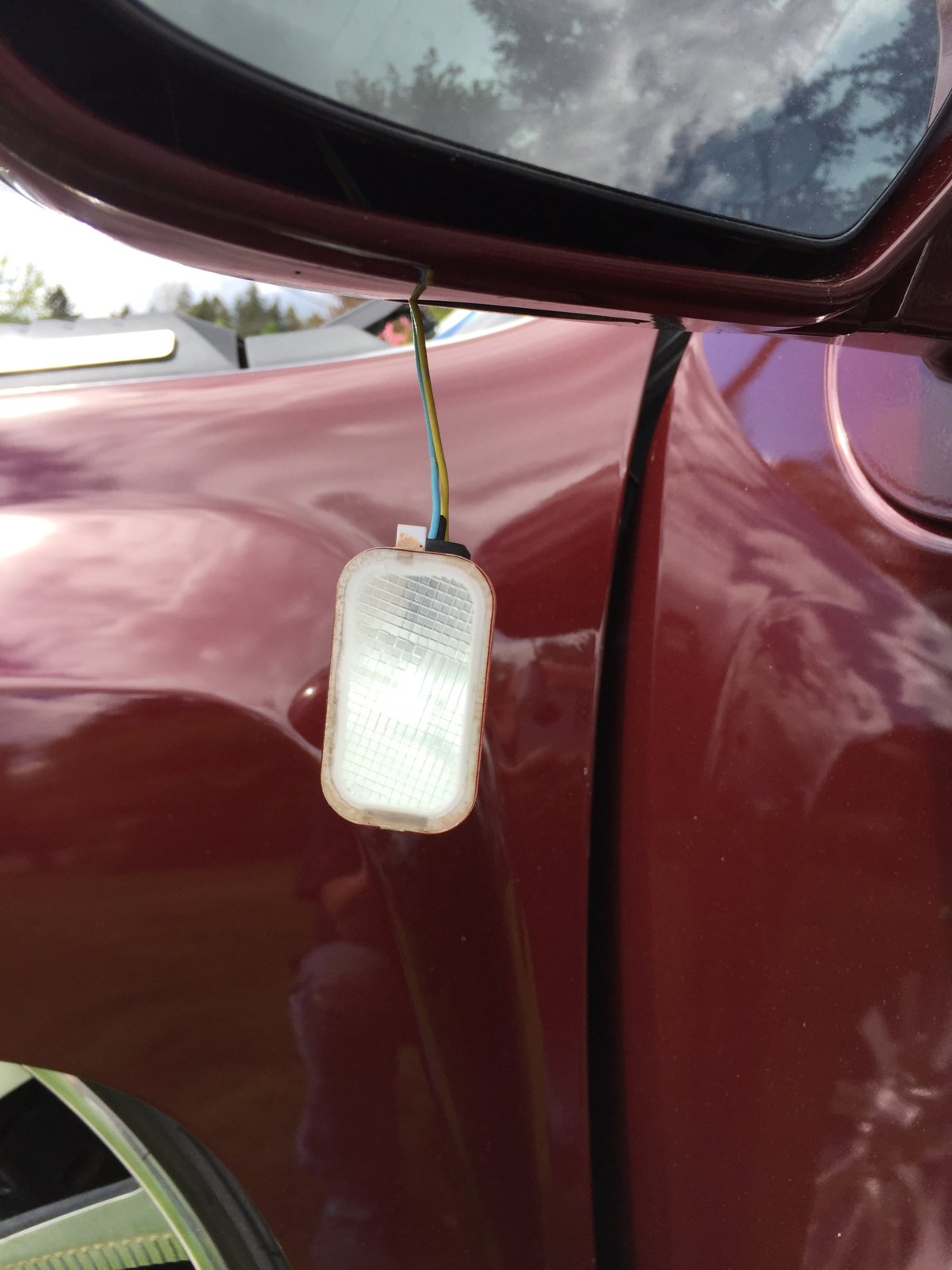

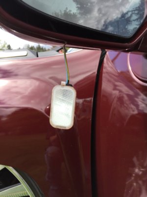

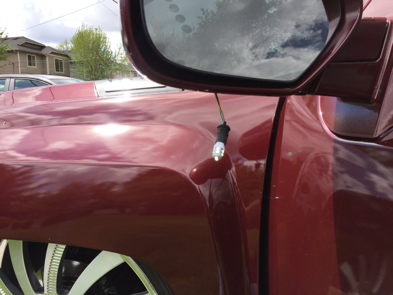

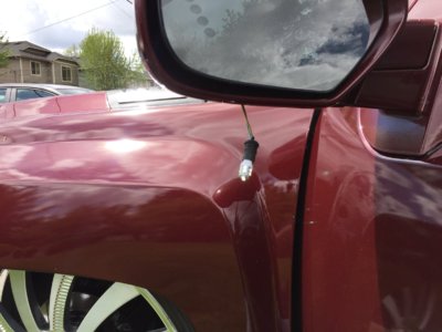

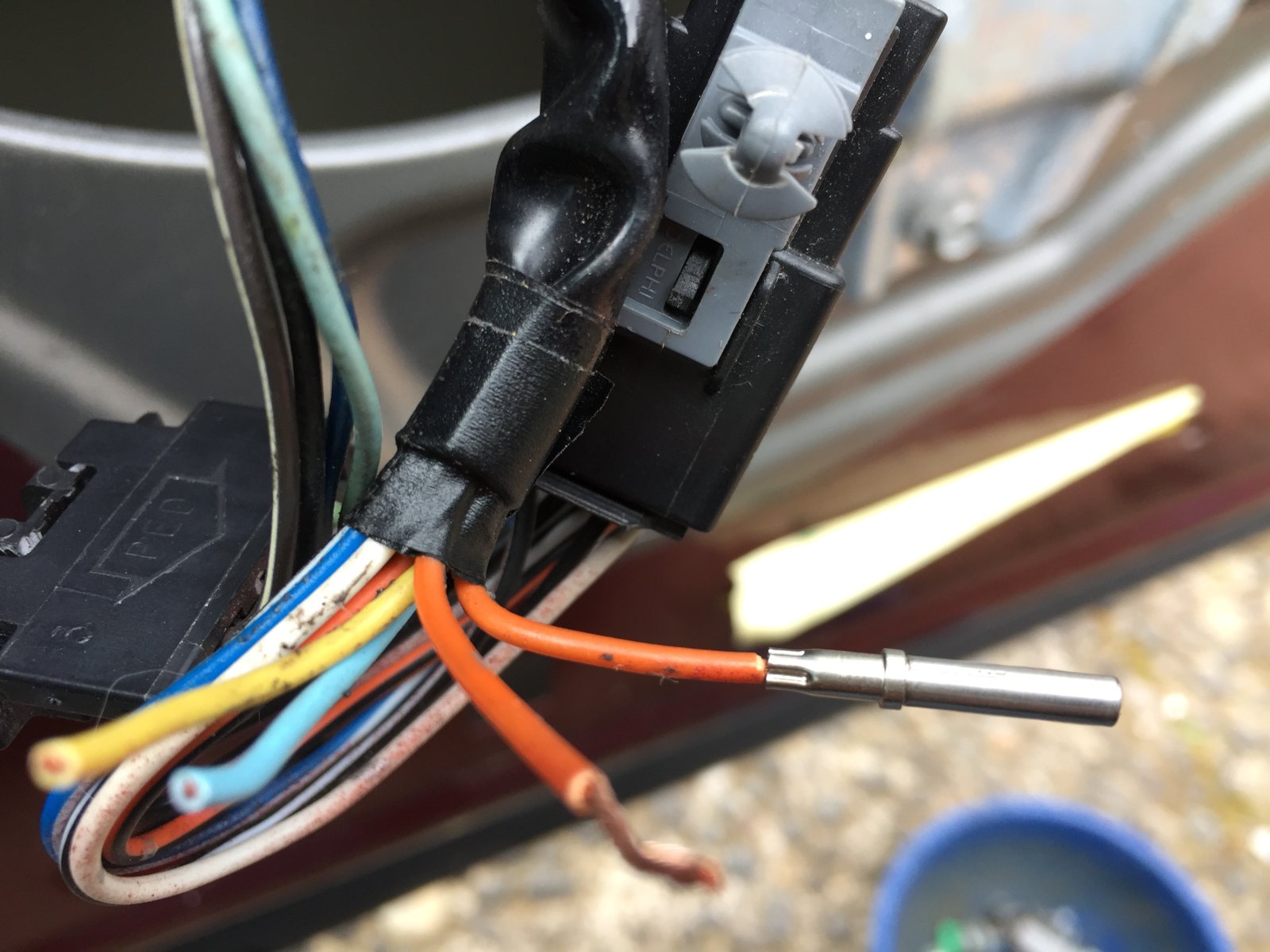

I got the puddle lights done today but I went over budget- I broke the toggle switch for my RGB/demon eyes so I had to buy a new one for $4.95. Dammit. Install wasn't bad- I had to run a wire through the door boot and hook it to the dome light wire over at the BCM. I used my fancy crimp tool for Deutsch connectors and put a quick connect on each mirror so they could be removed just like OEM. I was messing around with a motorcycle battery with the wires coming out of the passenger mirror and discovered the power fold function works lol. Too bad the BCM isn't programmed for it or I could get the upgraded switches and wire them in. Puddle light mod for $4.95, not bad.

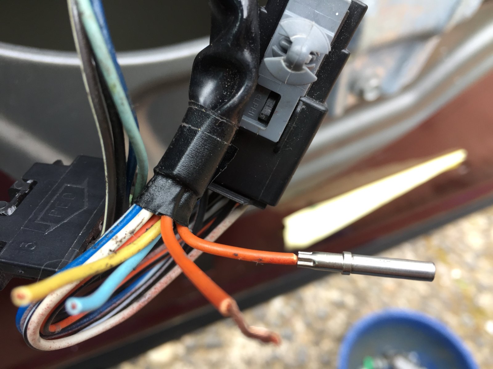

Couldn't you just wire the power fold directly for power, to a switch, and bypass the bcm? Could use a factory switch so everything looks original.
52,956
Its possible with relays but not just a switch. There's only 2 wires and you have to reverse polarity on the wires to switch directions. It's a lot of messing around. I don't think the factory switches would work because they're not meant to work relays, they're meant to use a bus line to the BCM. I saw a guy on another forum do it with relays and a DPDT switch mounted under the dash but I'm not really into that. I'd probably never use them anyway. If it was just adding a harness and factory switches I'd do it though.

I sure miss the good old days of just adding some wires to get something to work.
