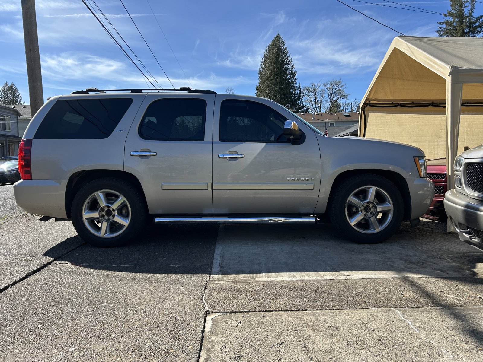

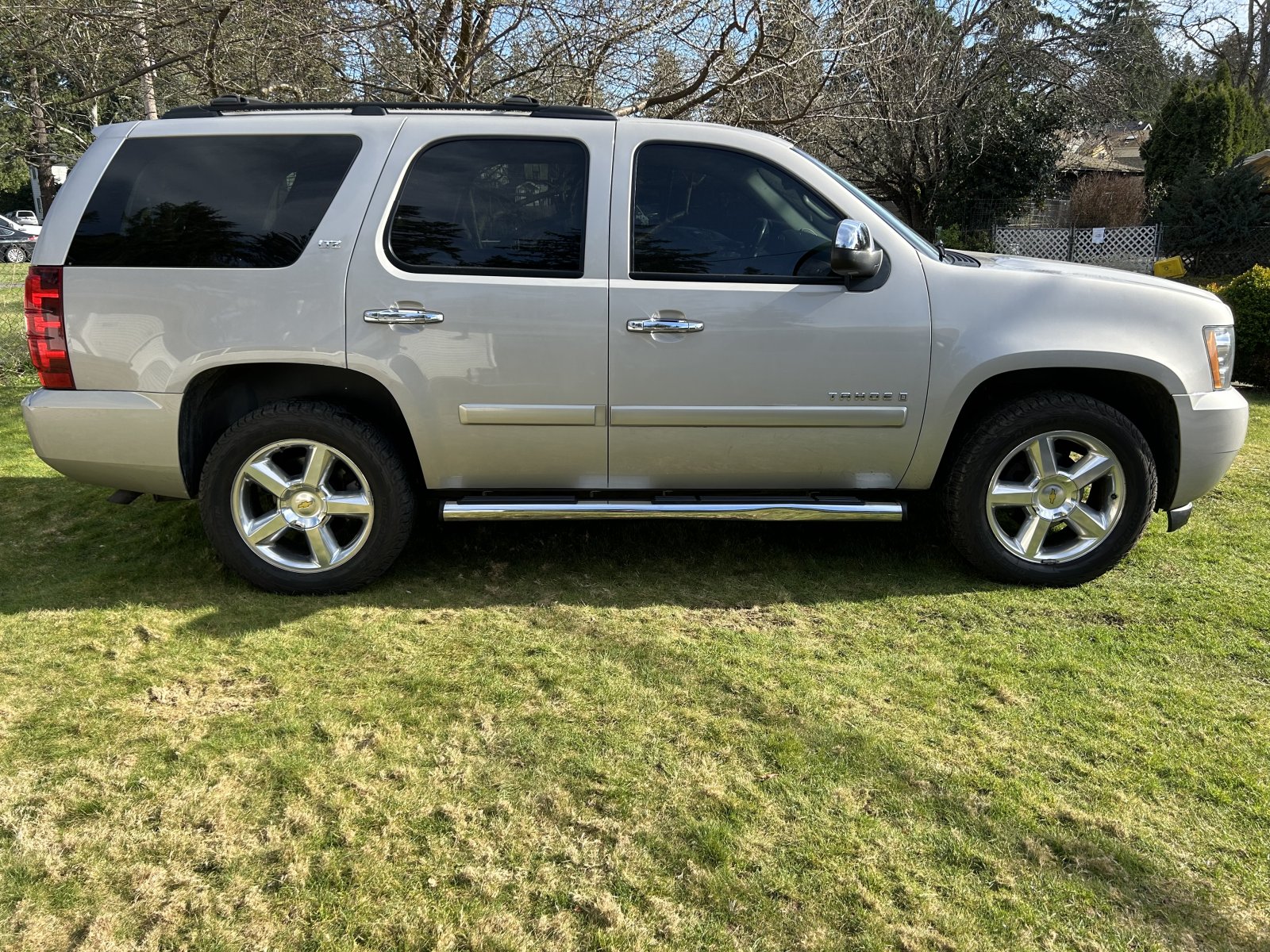

Did the drop today, and so far it’s a 2/3 not a 2/4 but the rear is still settling I believe. Plus I need to do a ALC trim set with the Tech 2. I shortened the rear ride height rods from 4” to 3” on a guess and I might have to tinker with them. The compressor came on but didn’t lift it but I had started it up while the suspension was hanging so the shocks might have had extra air in them. It should have exhausted any extra on the test drive though. Turns out the front LCA’s are aluminum so I didn’t need the spacers I bought. Just flipping the struts to under them gave me a near perfect 2” front drop. I have a tiny bit of rubbing on the LF on sharp right hand turns due to an inner fender liner hanging a bit but otherwise the test ride was great, the EBay springs ride nice. It cost a whopping $230 in parts. The yard shot is before.

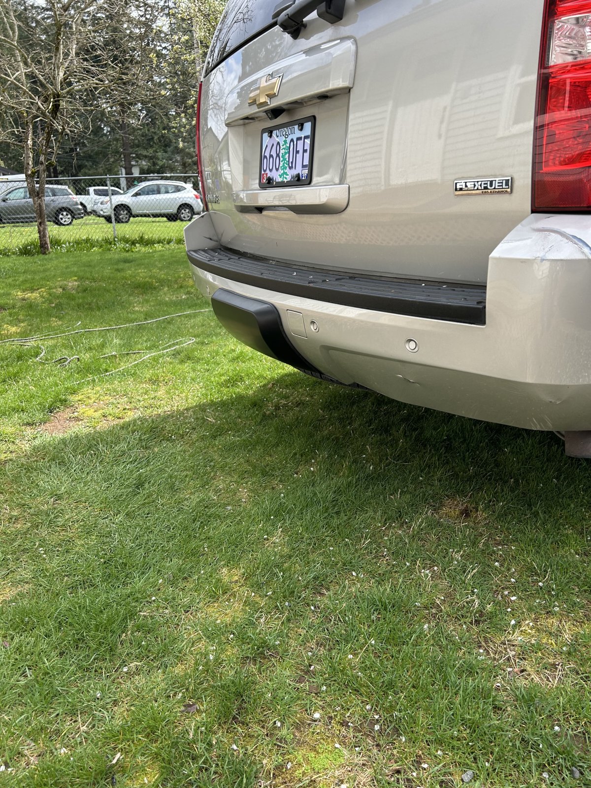

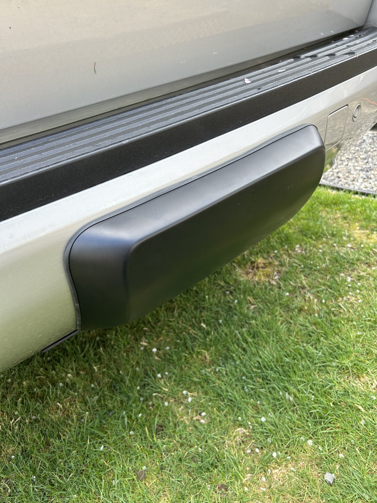

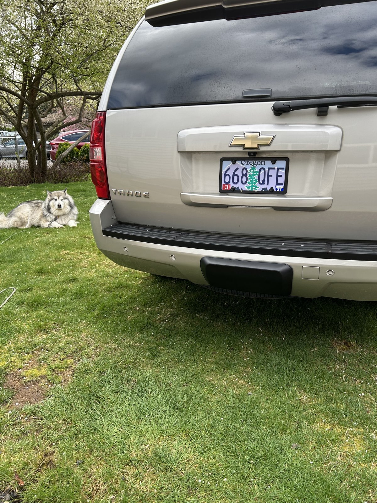

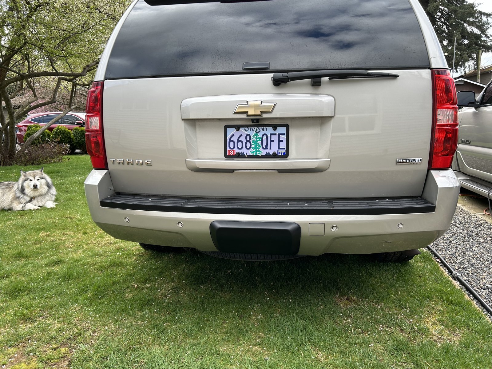

Figured out how to install the hitch cover. There’s 2 styles depending on your bumper. Mine is the more rounded type that requires a bracket to be added at the top. Just waiting on paint from automotive touch up.

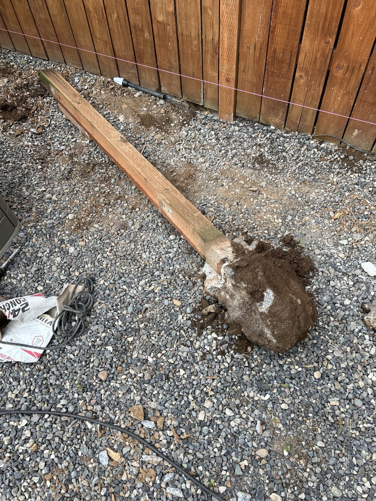

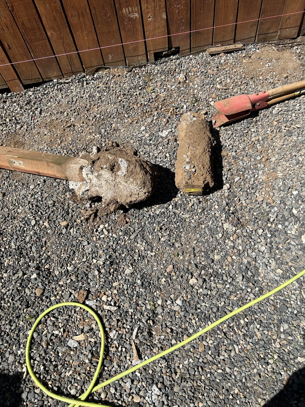

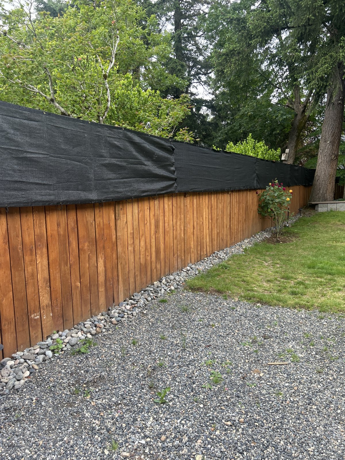

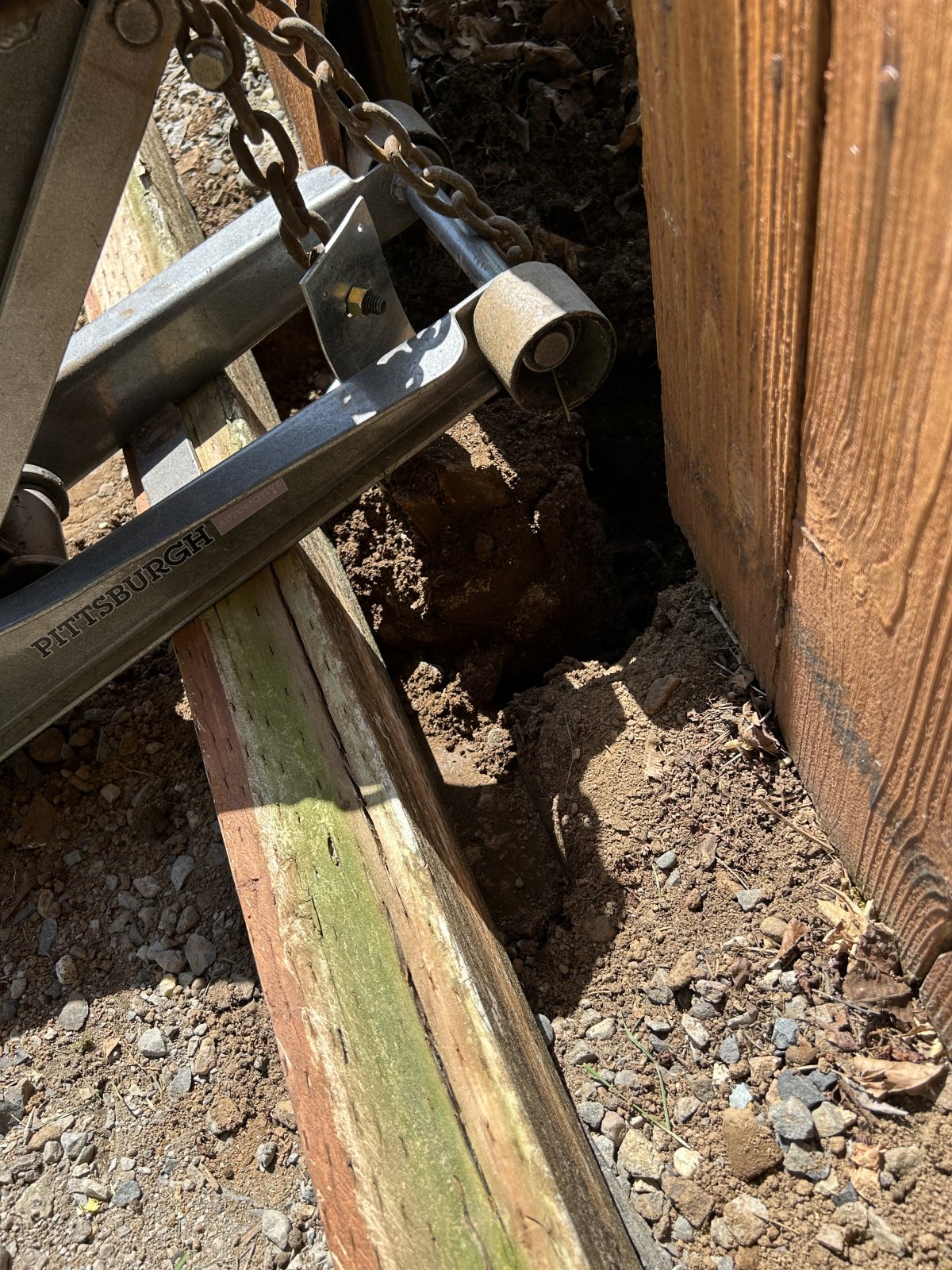

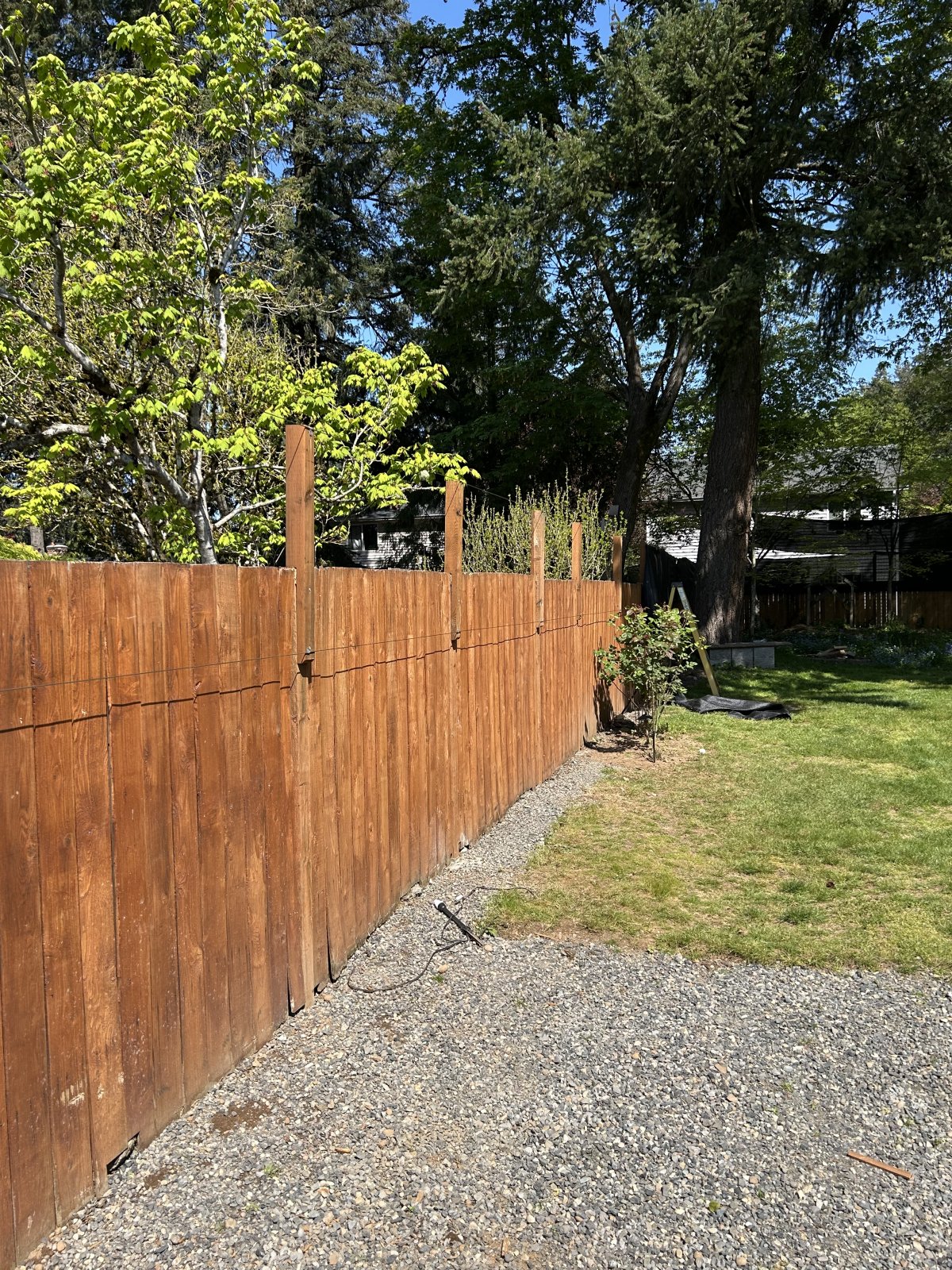

Not much happening with the trucks lately. Been busy with some outdoor backyard stuff. Some of my 6’ cedar fence rotted off at the concrete so I invented a way to use my floor jack, chain, and either concrete anchor drilled into the plug or a 12” long 1/2” lag bolt that I drilled into the rotten cut-off posts in order to lift the whole plugs of concrete out without digging and making a huge hole. Then I just had to use a post hole digger to make the holes a bit bigger for strength and reset the new posts in exactly the same location so the rest of the fence went right back the way it came apart. I did 11 posts.
That right there is a lot of work, but you've found a good way to make it easier! BTDT but not that way....
