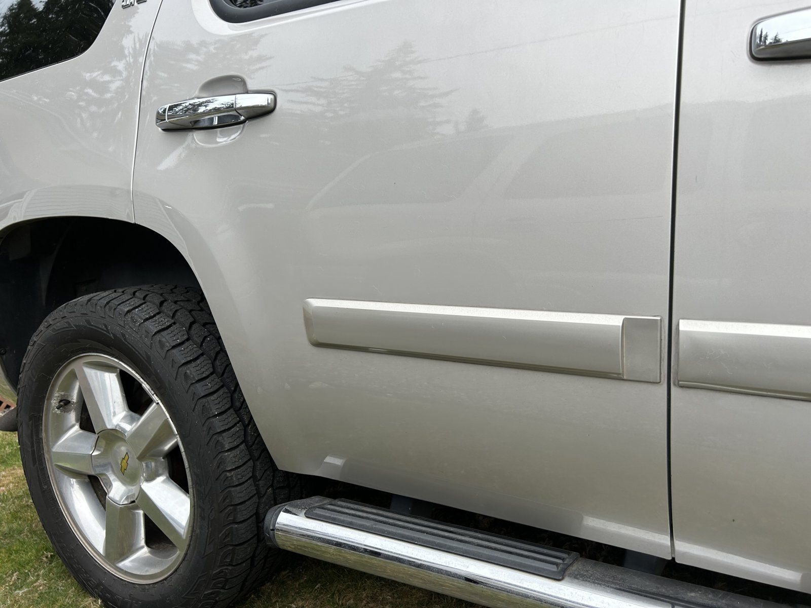

I believe 09 or 10 where the first years for the chrome trim on the side molding.
My '08 has it, that is what made me notice it. '09 was the first year to have the chrome along the rear bumper "step", I believe because that is when the bumpers changed.
52,956

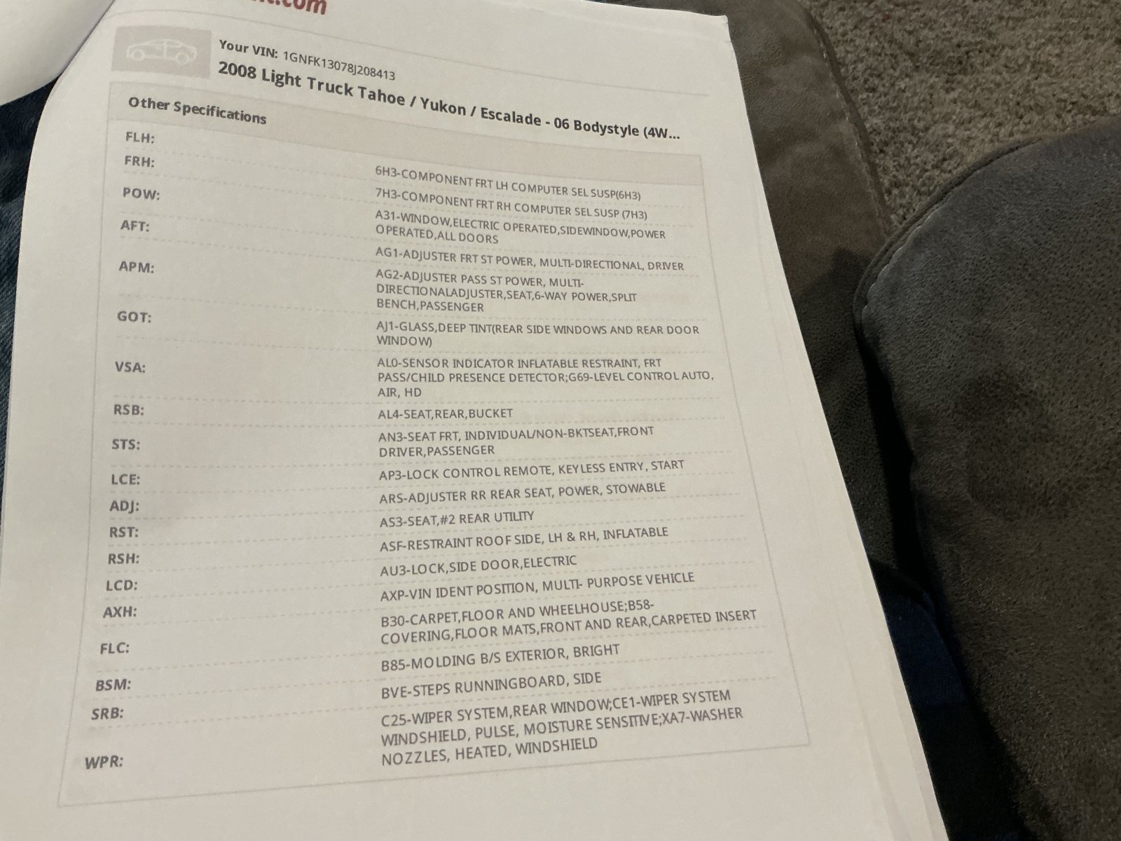

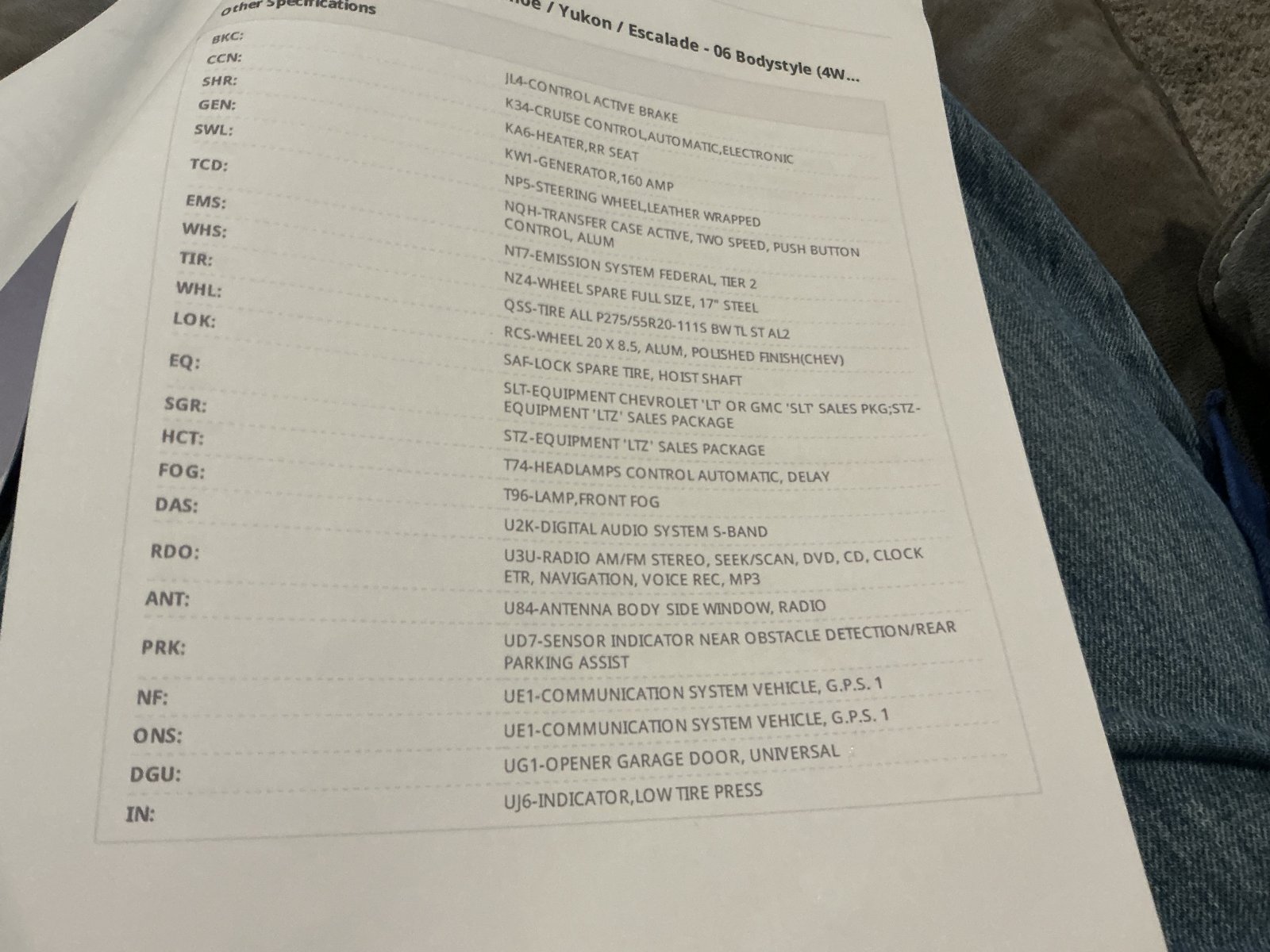

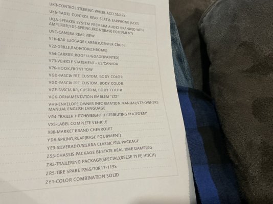

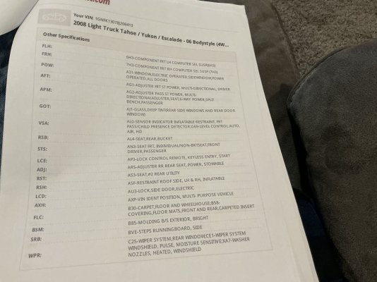

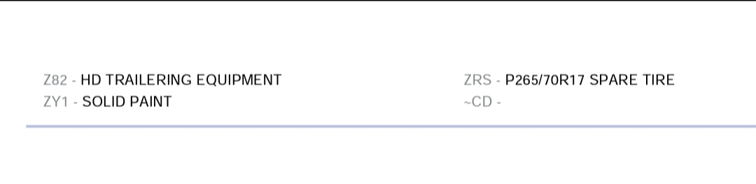

Here’s a few pics of the RPO codes in a printout from the free VIN decoder at GM Parts Giant. Maybe you can compare to see where the difference is. The first regarding exterior molding is B85, Molding B/S exterior, Bright. Then I see the first LTZ mention at SLT-LTZ sales package, then STZ- LTZ sales package, then there’s some fascia ones VGD and VGE fascia, custom body color, and then VGK- ornamentation emblem LTZ. Also curious what your running board RPO is-mines BVE- running board, side. Not sure if mine are factory or aftermarket.
Here is mine
52,956
I see the running boards are different- mines BVE side running boards, yours is BVU assist step. So yours are power assist? Yours also has only VGE body color rear fascia, mine has that plus VGD- fascia front custom body color which might be the side moldings. And yours has a chrome appearance package, mine doesn’t. There’s a few other differences. I’m sure they’re not all the same, depends on what the dealer ordered probably.

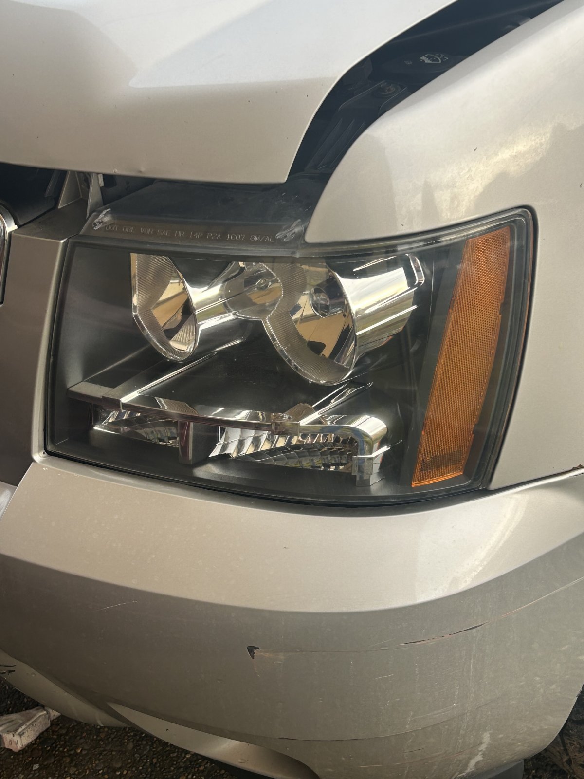

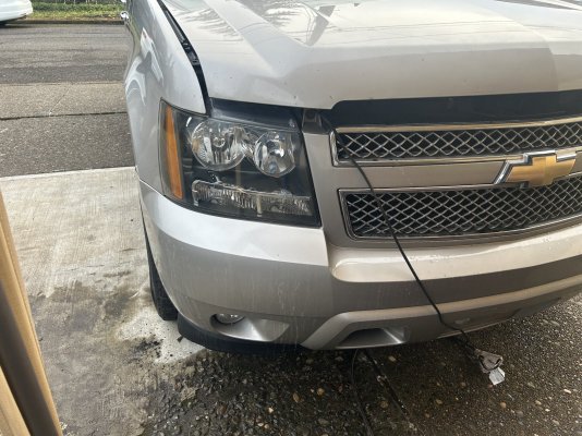

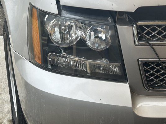

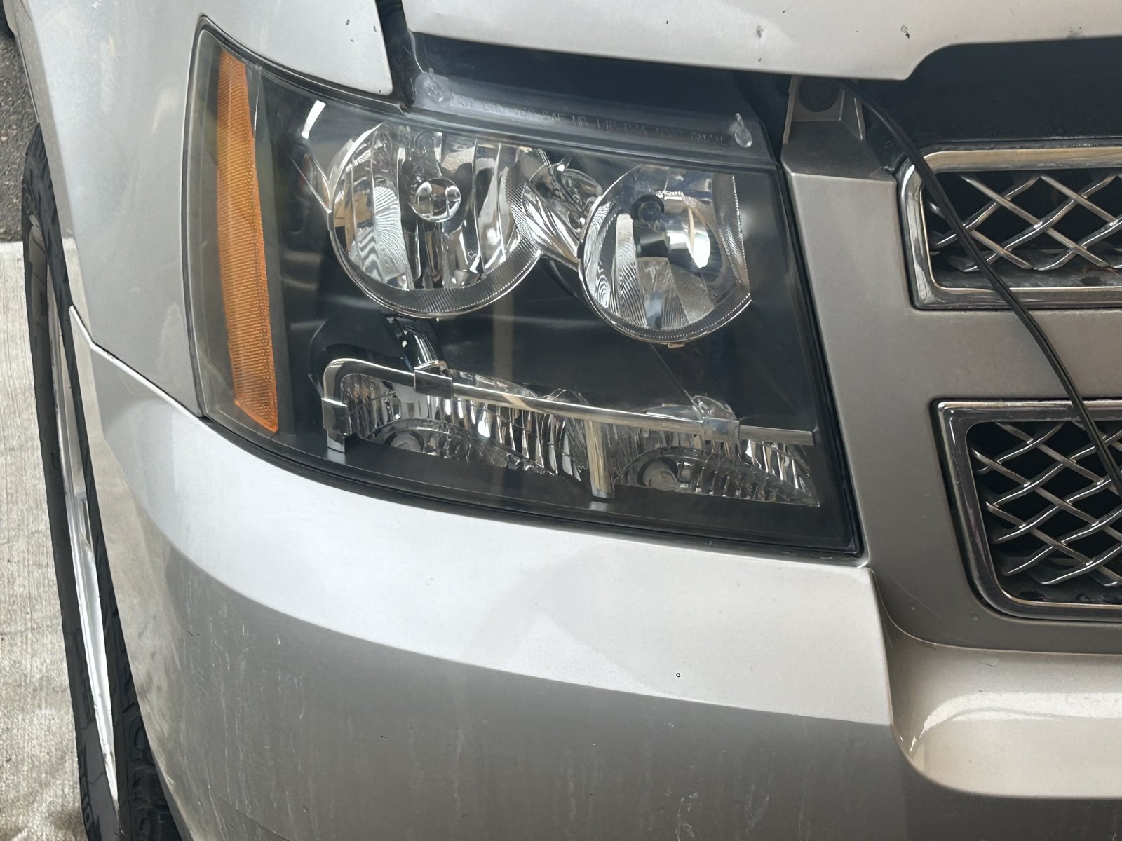

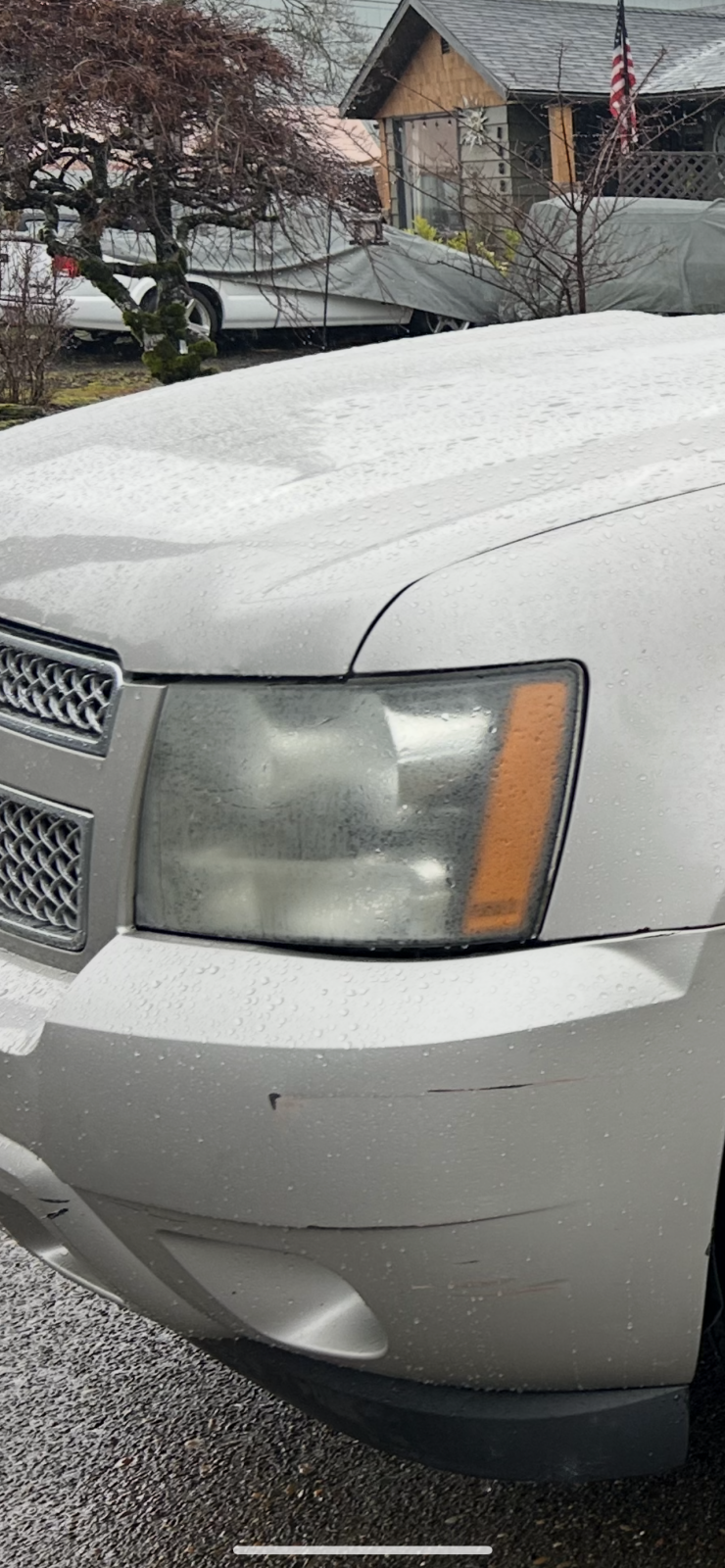

Used the Cerakote headlight restoration kit and I am as impressed with it as I was with the trim kits. These were so hazy I almost couldn’t see the interior of them. Very nice results. This is after drying for a few hours so it’s the final result.
Looks great! What kind of work is involved with that kit?
The kit has some oxidation removal towelettes first, then a quick wet sand with 2000 and then 3000 using a little round holder and then wipe the clear sealer on. Easy peasy.

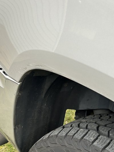

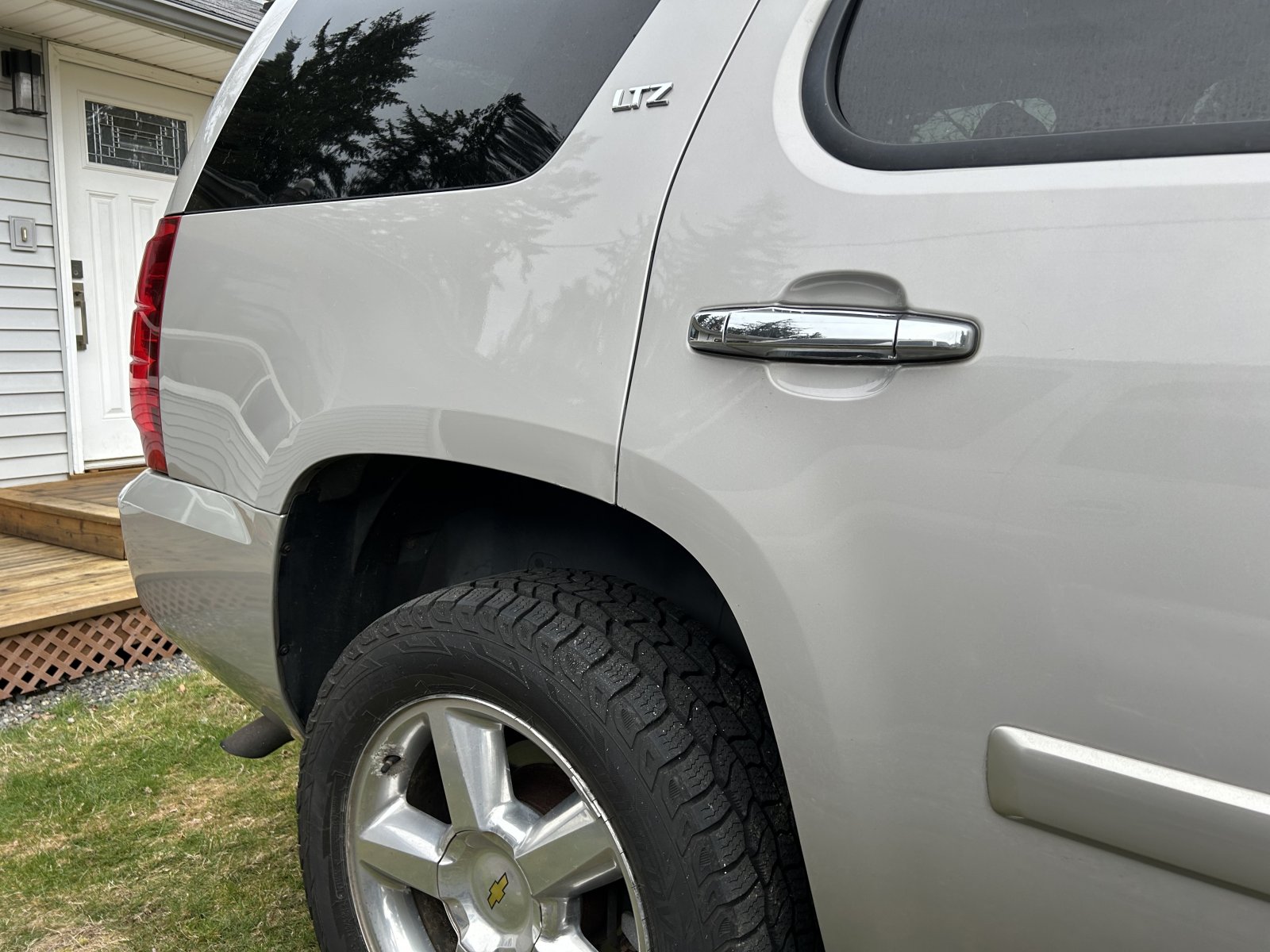

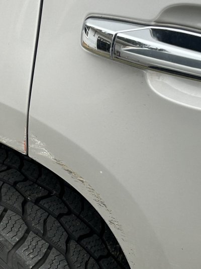

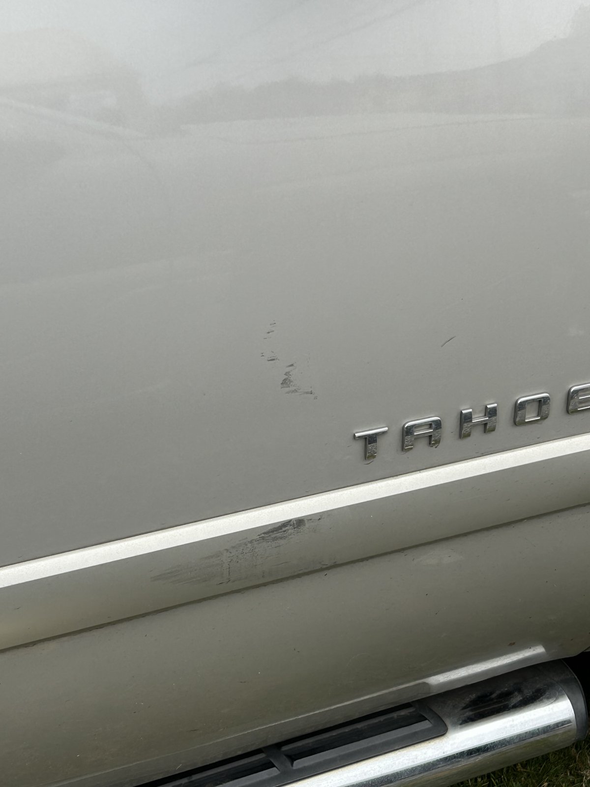

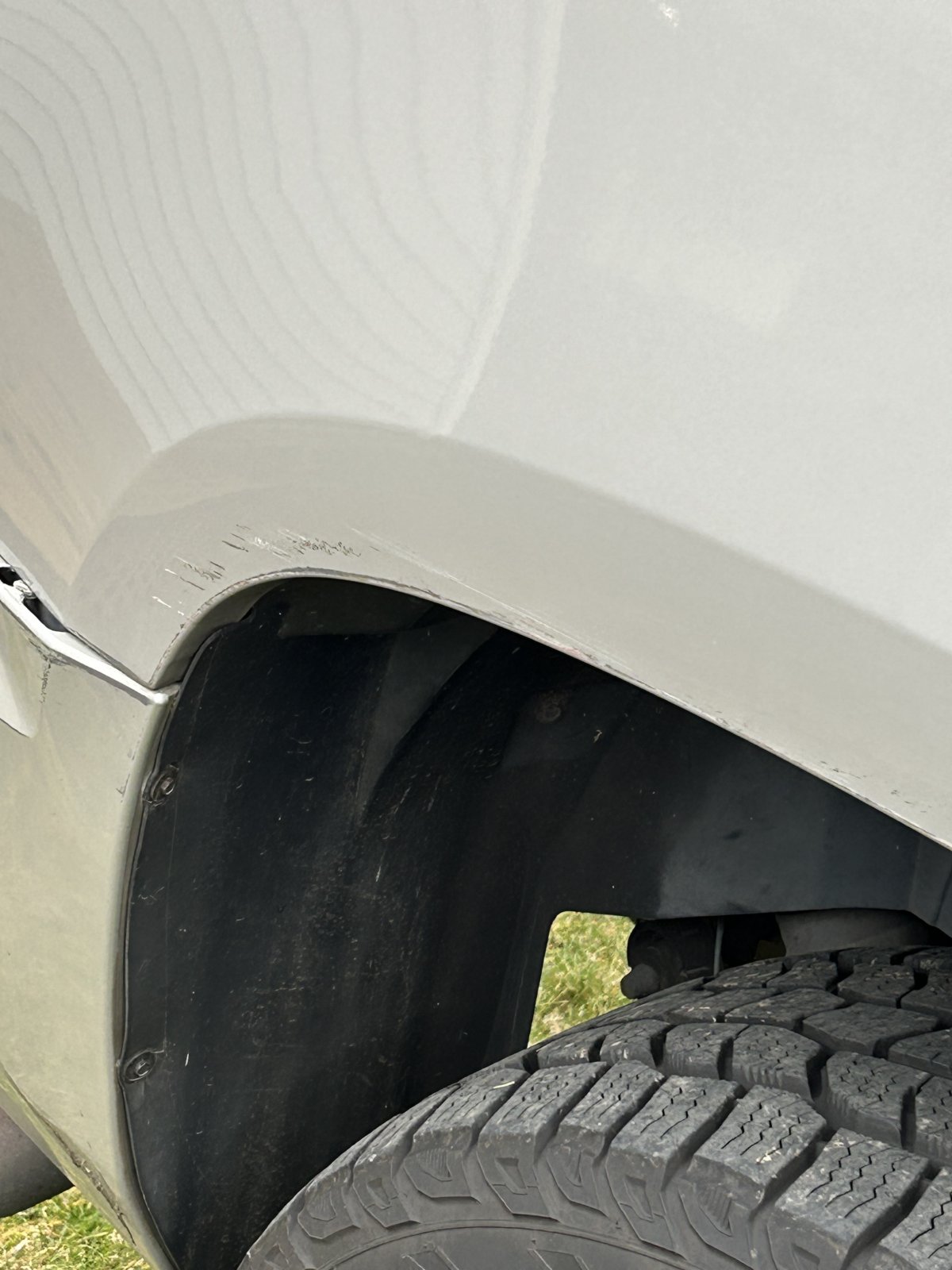

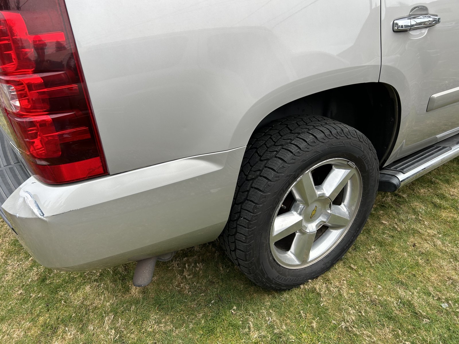

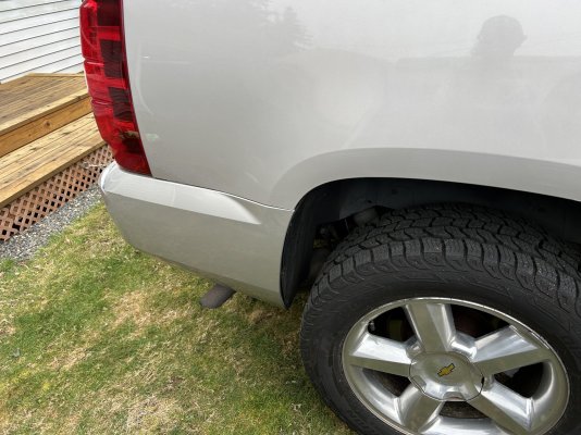

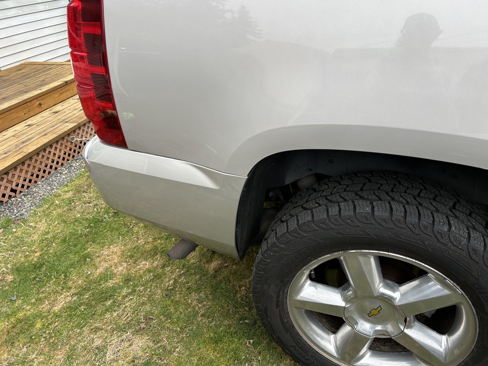

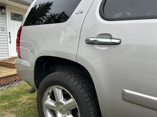

Today I buffed out the damage down the whole passenger side of the hoe and managed to get the rear bumper to snap back into the fender. It looks so much better. I will remove the whole bumper at some point and try the hot water trick to try and get the dent out. I also ordered a used OEM right tail light because it’s broken, as well as brackets for the running board so it’s not pushed in. I might try to find a replacement RB later. I just finished my last round of chemo yesterday so I’m taking it easy. I got a bunch of other stuff dialed in on it. I don’t care for all the memory stuff and finally figured out why the passenger mirror was getting all whacked out every time I put it in reverse or forward and the seat would go crazy. The PO had it set up real weird, like they never figured it out so they must have adjusted everything every time, there was no way it was usable like it was set. Also found out the stereo has Sirius XM so that’s a bonus. It was a good day. Before pics.

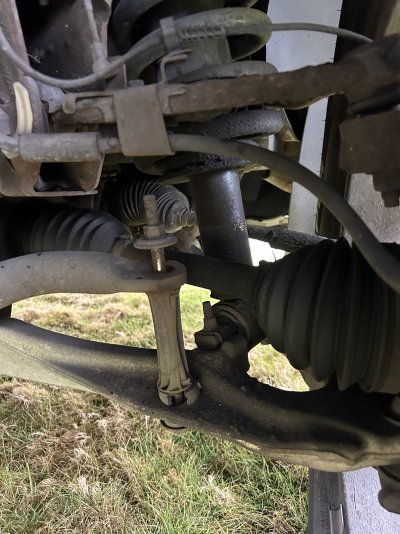

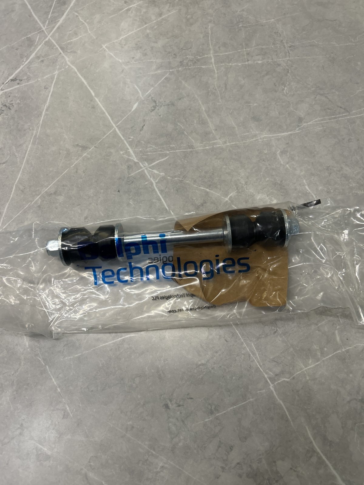

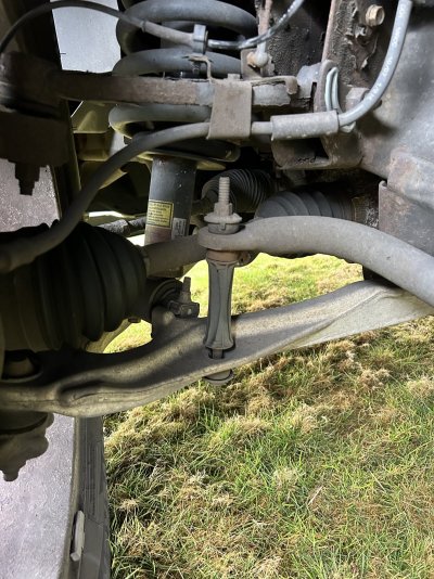

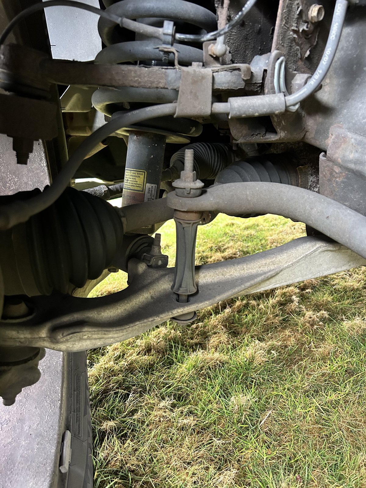

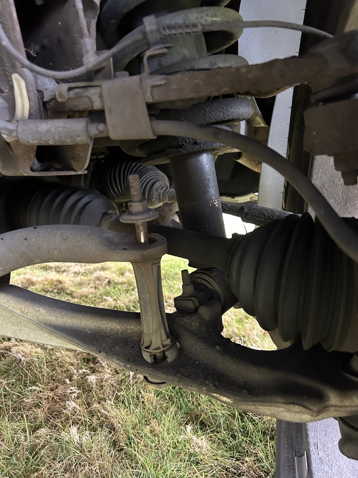

The Tahoe has some rattles going over bumps. I know the rear auto level system is shot; the air bags have huge holes in them and I’m sure the compressor is shot but that will have to wait. I remember the front end links are a bad design on the GMT900 so I took a look and of course they’re shot and the plastic parts have been hammered so there’s play and every time over a bump they’re banging. I ordered some Delphi that have metal sleeves that won’t wear out. I’ll get them on in a few days when it quits raining. I’d be willing to bet my rattles will be gone.

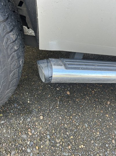

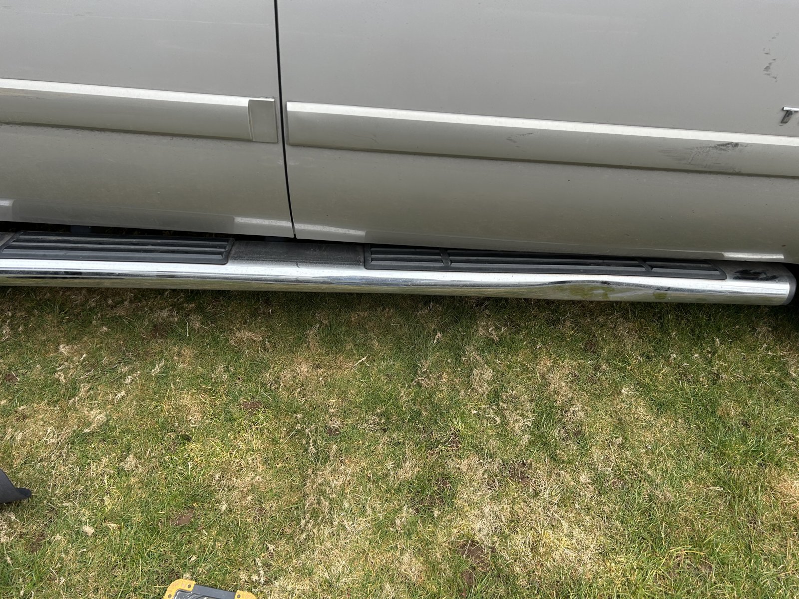

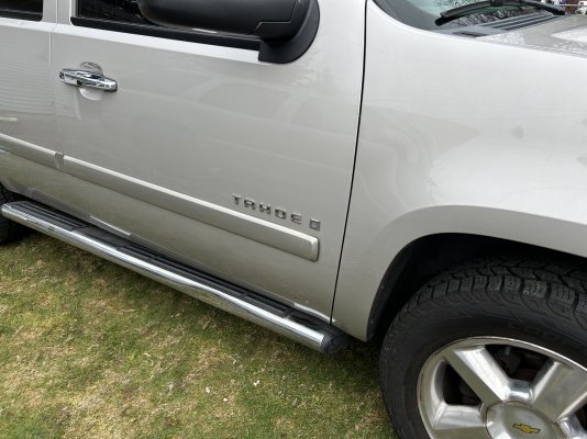

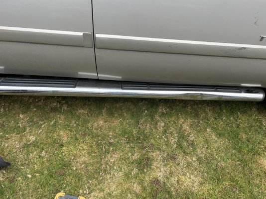

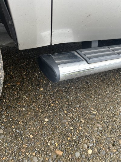

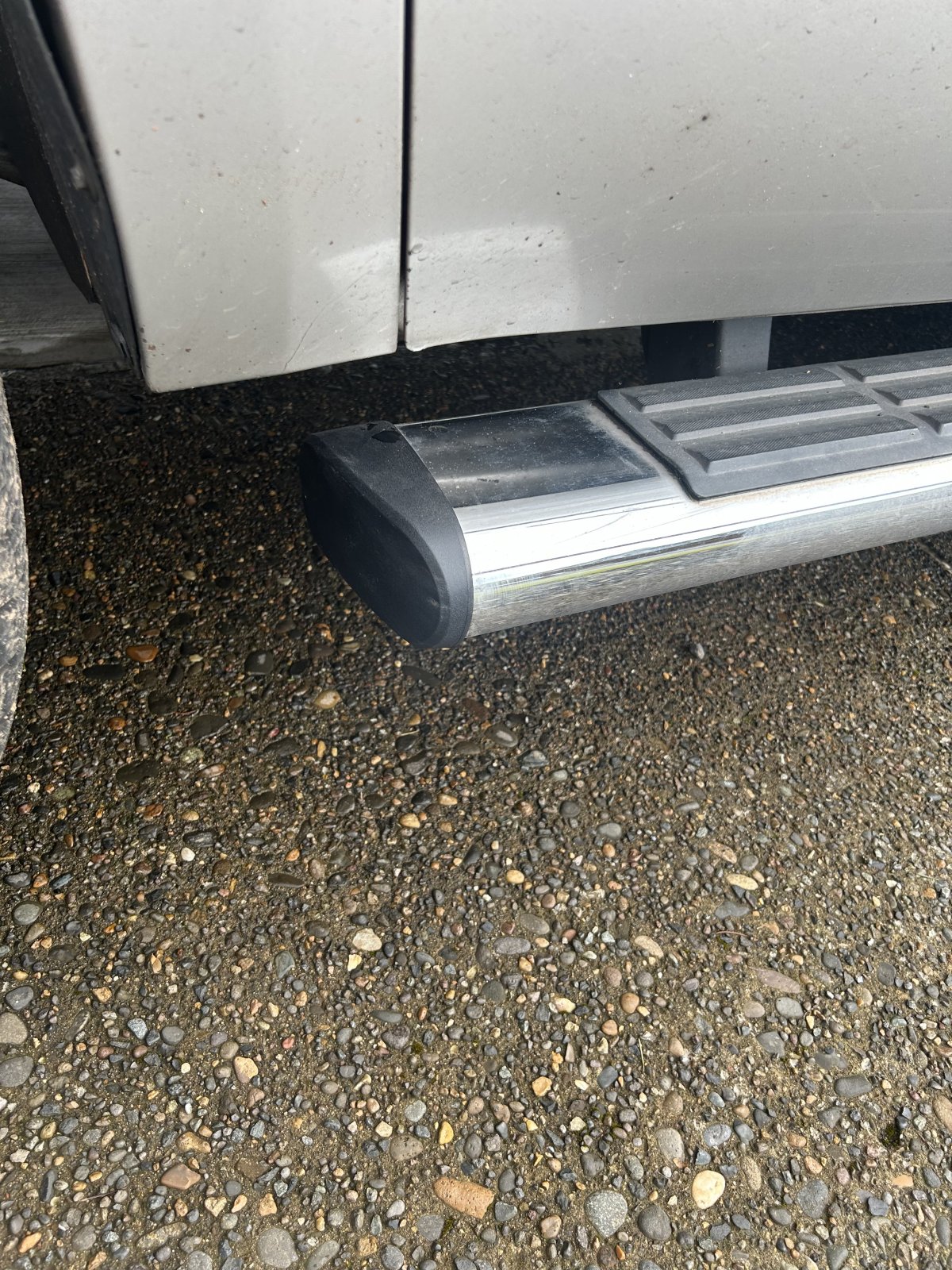

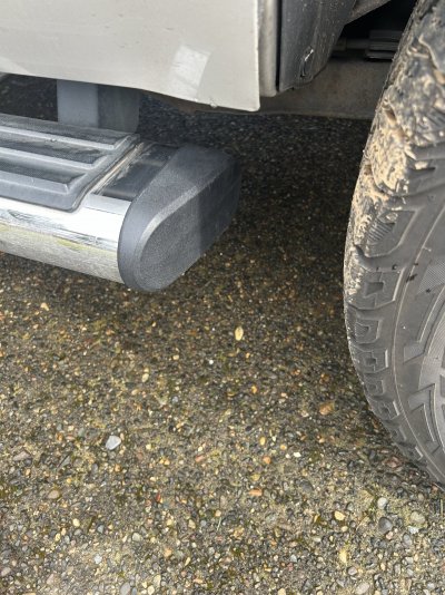

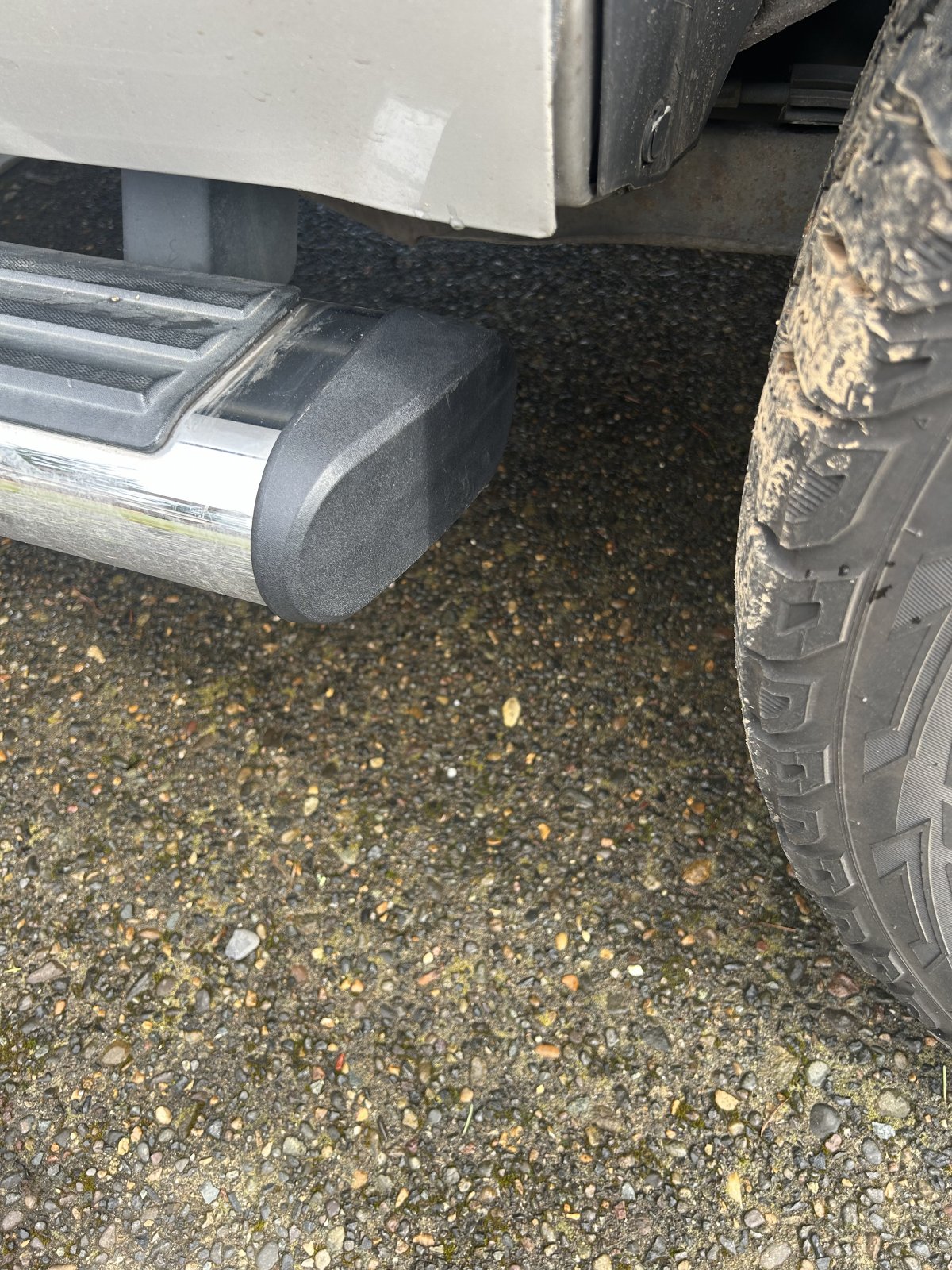

Today I did a bit of work on the Silverado and Tahoe. The hoes running boards were missing end caps and the ones that were on were all loose. It seems GM updated the design and I found them on Amazon somehow. I can’t even find these running boards online, much less a parts diagram. It was a chance they fit. They did so I replaced the driver side ones. I’ll order new passenger ones now that I know they fit. The old ones have bendy brackets with rivets on the bottom but nothing holds the tops in so when one gets stepped on it bends them down until they break off. I didn’t take a pic of the back of the new ones. They just tap on, there’s claw type brackets that hold on but won’t let go if you pull on them. They fit inside the tubes and grip. Kind of like they use on some of the other plastic parts, but bigger. They hold the top and bottom both.

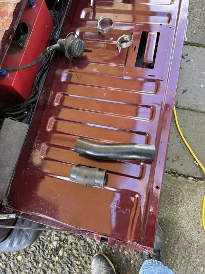

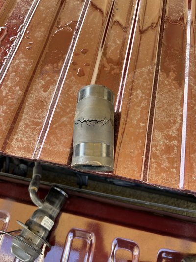

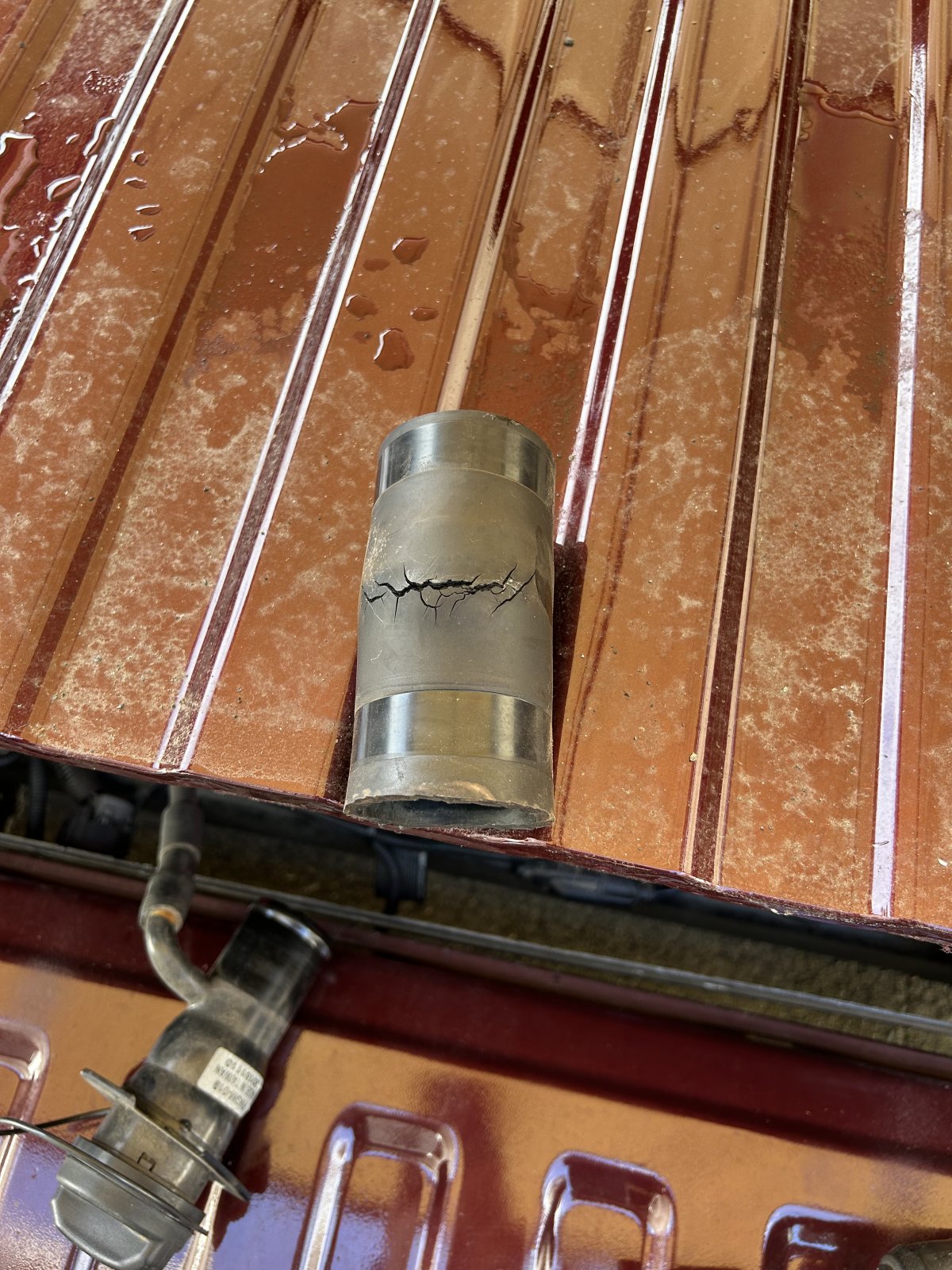

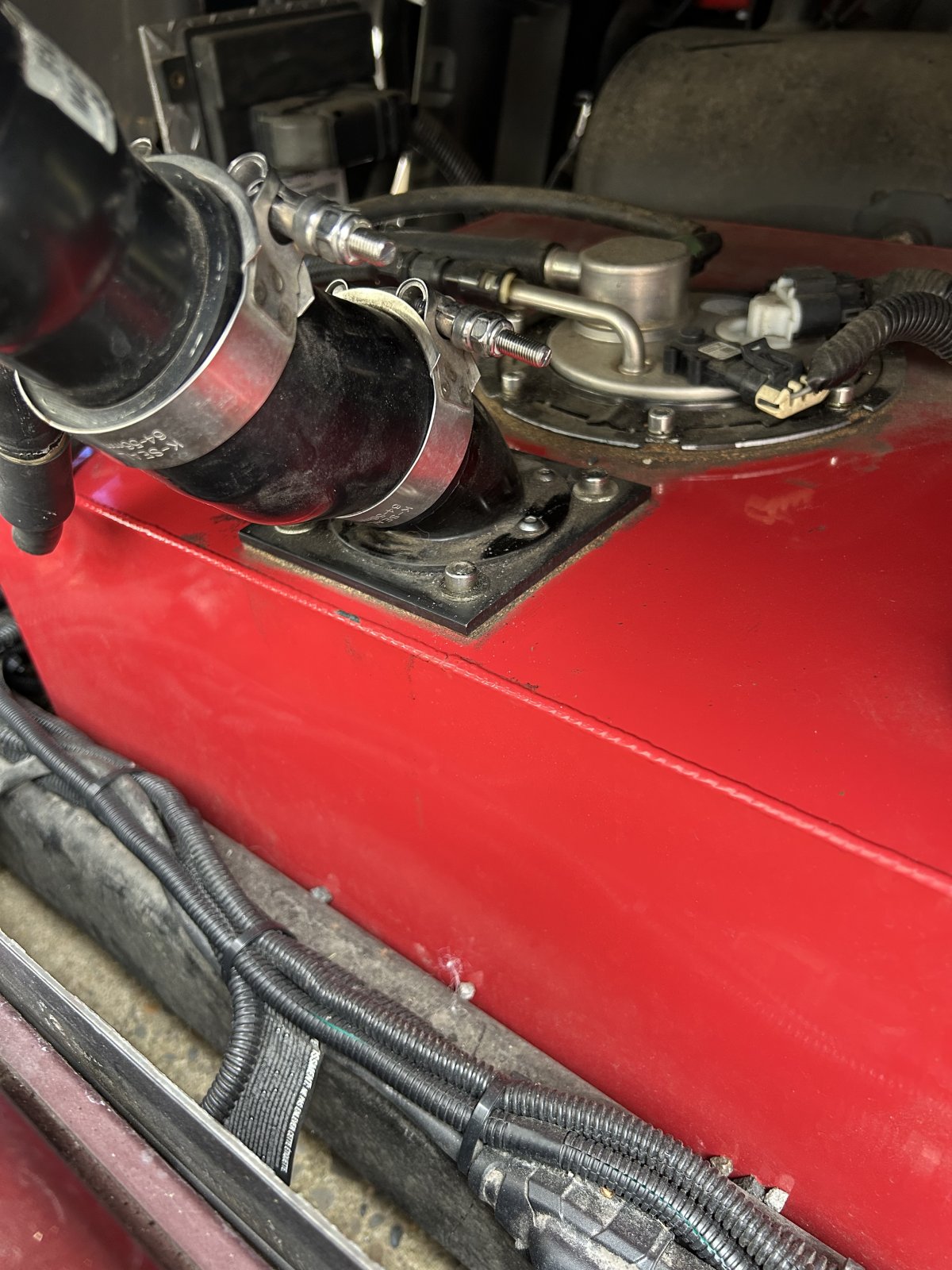

On the Silverado I replaced the fuel filler tube. The old one was cracked through on the bottom and I was getting an evap code plus I think gas was spilling when I filled it last. I found a long piece online that had the right bend and was the right diameter so I cut it to fit.
