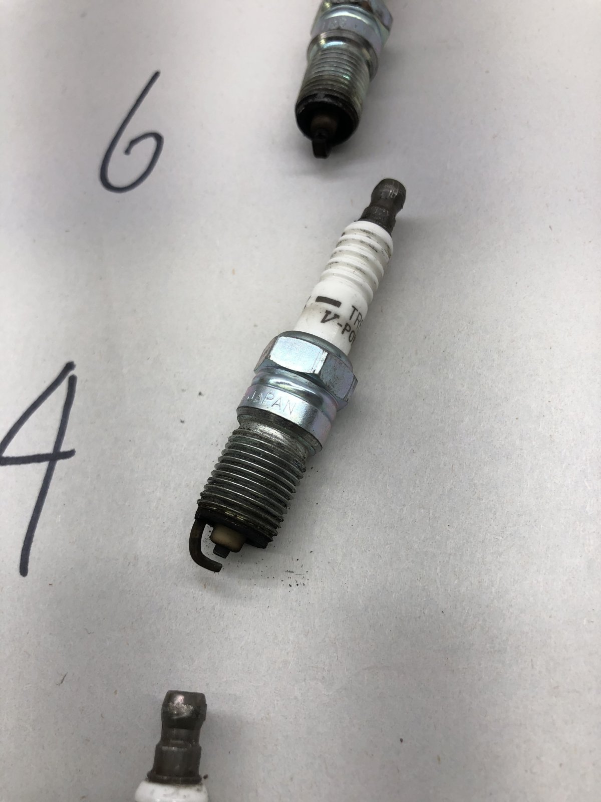

Yeah, that’s pretty much my last thing to check. So I looked in my records to see when the last time I changed the plugs. It said 2/9/20 at 169,150 miles I put in Rutheniums. That brought back memories of that failed experiment. And thank god for this build thread, because I was able to go back and read up on what was going on. The Beast hated those plugs, misfires like crazy so bad it would barely run. That was 14 months ago, and I ended up installing the same plugs that have worked great since installing the blower but don't last long- NGK TR6 copper. I'm going to install a fresh set. I tried to go see what my mileage is right now but I cant read the mileage in the daytime since I installed 2-3 layers of blue film over the PRNDL display which I now need to remove at least one layer of. I'm feeling more like it might be the same issue again- it likes the cheap copper plugs but they don't last long. Come to think of it, for the last couple months it's been hard to start at times, kinda runs a bit rough until I give it some throttle for a sec and then it's fine. So I'm feeling more and more like that might be it. It's raining for a couple days but I'll swap them in soon. Oh crap, I'll have to wait for the new wires. Oh well, no hurry. It still seems to run OK just throws the code. And I don't drive much anyway right now. Here's a link to where I changed them last time. Rutheniums were swapped back to TR6's.

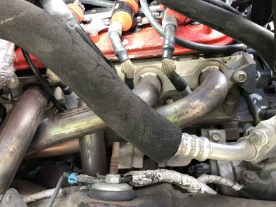

Well I replaced the plugs today along with 3 of the wires that needed replacement. Then I retorqued the SC bolts that I could get to easily, in the center which is the area of misfires, #4 & #5. I still see a lot of misfires on those two cylinders, not sure if it’s any better. I got the P0300 once after the plugs and before the torquing. I cleared it and went for a drive. Funny thing is, it’s always ran great- I can’t tell it’s misfiring. I did a few WOT pulls and drove around a bit and filled the tank. It didn’t throw the code. Sigh. It’s not over, I’m sure. It sucks to go through the hassle of replacing plugs and see no change. Oh well. I’ll just have to see. Plugs looked a bit fouled but not terrible. Included is a pic of plug #8 with decent access once I trimmed the evaporator heat shield.
