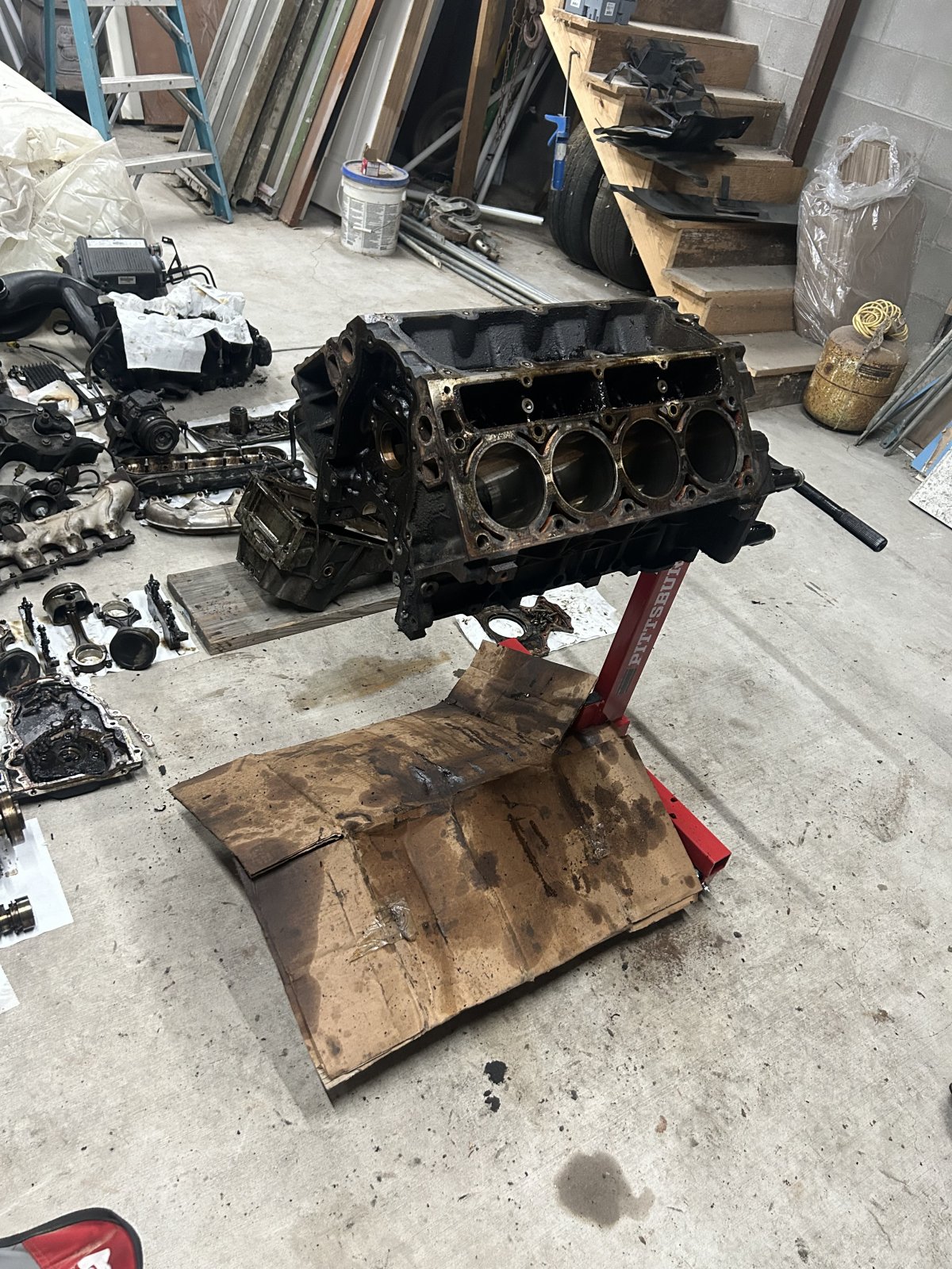

I’m finishing up unbolting the converter and some lines underneath and it will be ready to pull and mount on the stand!
The machine shop I’m using is backed up for about a month so this is good. I was checking those kits out and actually found a BTR kit that comes with Stage 2 v2 cam, beehive springs, 1 piece push rods, and valve seals for a good deal. I do have the 4l60e but I was thinking about just finding a low mileage junker 4l60e while I have the motor out.
Looks like your having fun and making progress. As far as trans, recommend perhaps '05-'06 for updates (4L65e). Might be a challenge locating "low mileage", but I've seen a few under 100k miles. My experience with the 4L60's life expectancy, even when well maintained is in the 150k-175k range. Adding fresh, additional HP will shorten that duration.

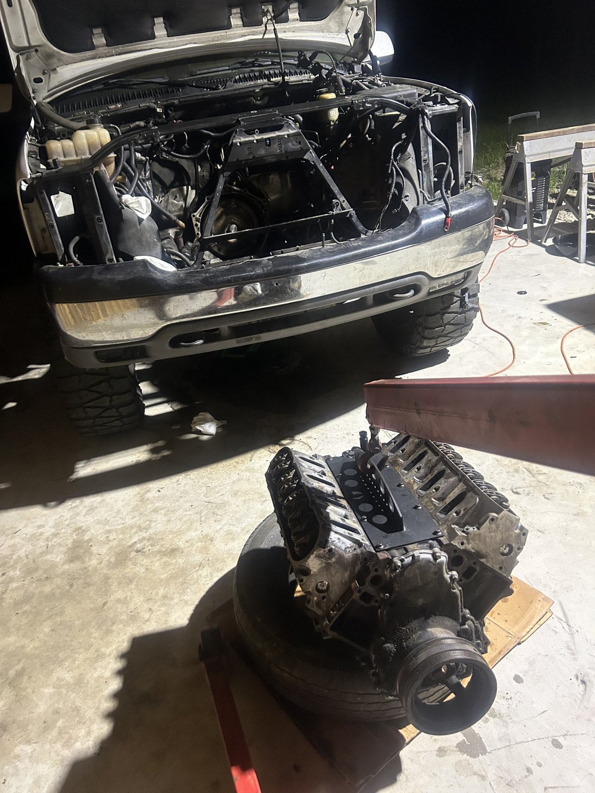

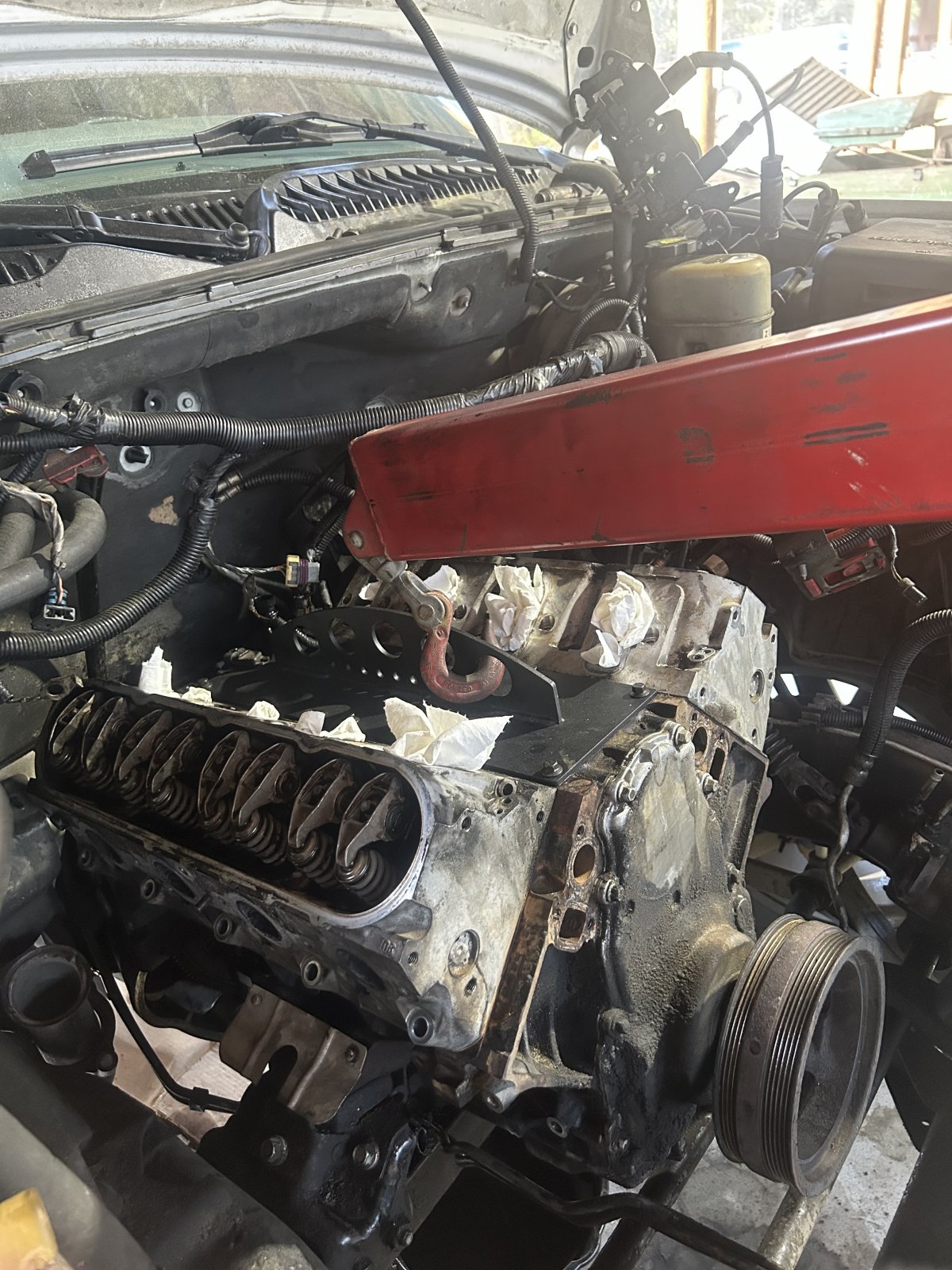

I finally got the motor out of ol girl tonight. I can’t tell you how many times I cussed at this thing not coming loose… it ended up being 1 final stud in the top back of the bell housing I missed.

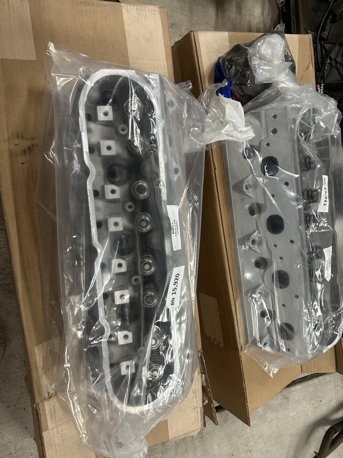

I finally found a set of remanned 862 heads that I will be replacing the valve springs, seats, retainers, rocker arms, rocker arm stands, etc.
My question is, what do I need to be able to fit 2” intake valves in those bad boys?

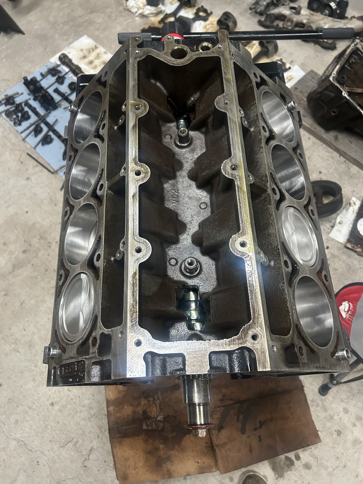

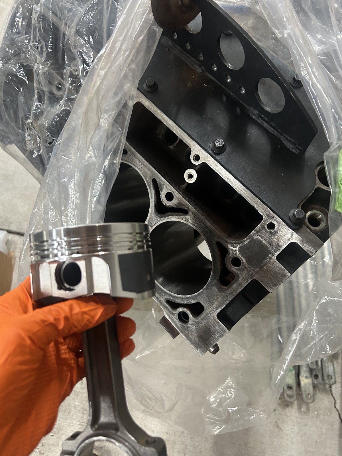

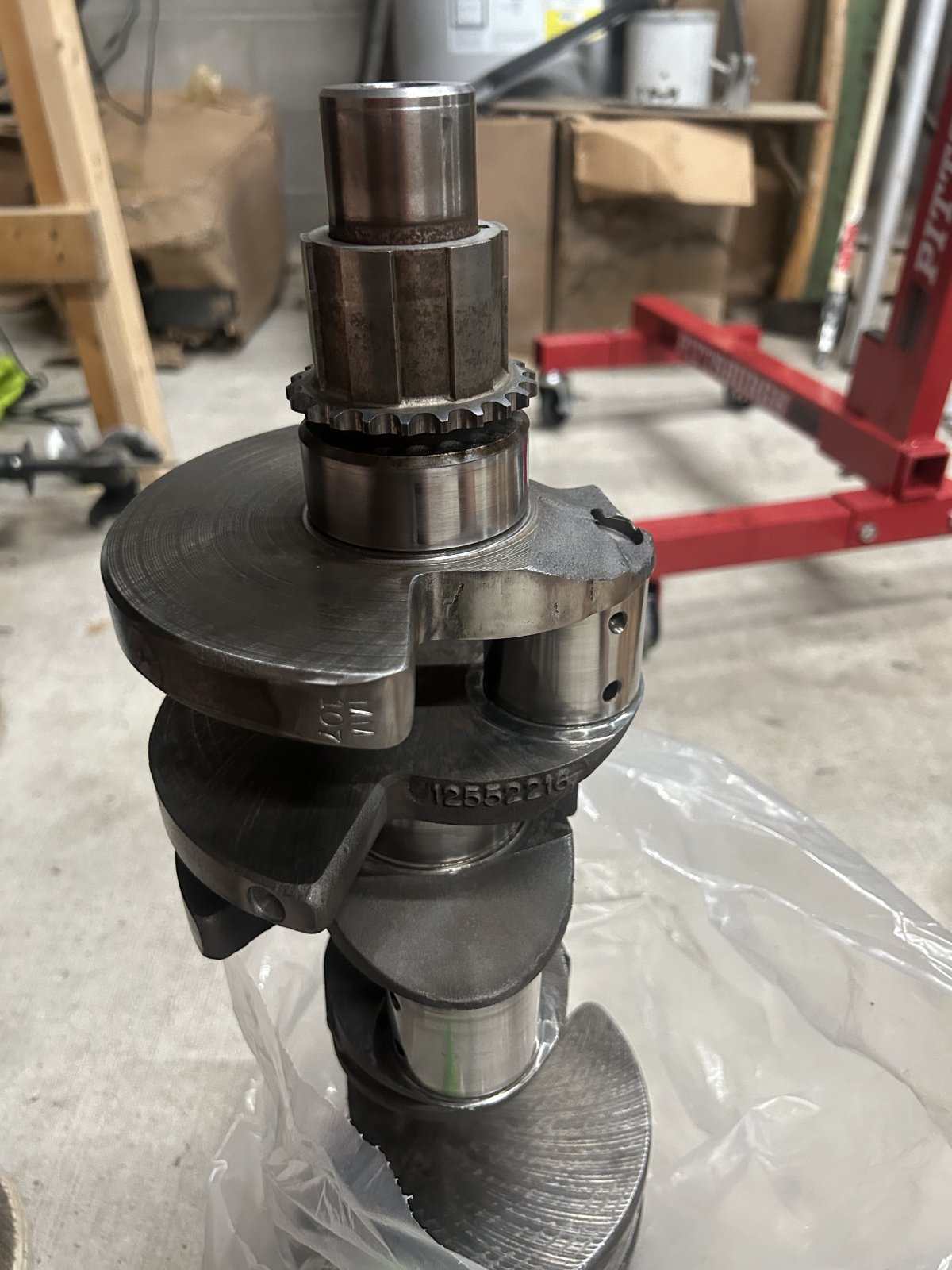

It’s been a minute since I updated this but I finally got my block and rotating assembly back from the machine shop. Here are some pictures of the work!
I recommend you get some plasti-gauge and an accurate torque wrench, take your time on test fitting of your rotating assembly, a quality ring compressor and rod bolt (rubber/silicon) caps for piston installation, and make sure you breathe and limit caffeine for when you're sliding that camshaft in . For me assembly has always been the fun part.
Oh yeah. The assembly is definitely going to be a blast! I actually just got my torque wrenches calibrated, bought a speedway adjustable ring compressor, valve spring compressor, feeler gauges, and some plasti-gauge. I'm still in the process of buying other misc. things while the engine is still out.
Sorry I missed this post. Unless you are going to put some manual work into the heads to unshrowd the valves after installing larger ones, don't. A larger valve gets pretty close to the chamber wall, and can actually flow less then stock valves. And the small bore of the 5.3 block doesn't help matters. Plus, opening the chamber drops compression, even by a minute amount. Look up the stock LS heads comparison test. A 5.3 with a BTR cam and all the stock cathedral port heads. The 706/862 did better than all the others with the bigger valves. Including the 241 with the 2.00 inch intake valves. The best stock head for a sub 400 hp 4.8/5.3 is the 706/862.
Thank you for the advice! I actually decided against doing the valves and just doing springs/seals/and CHE trunnions.

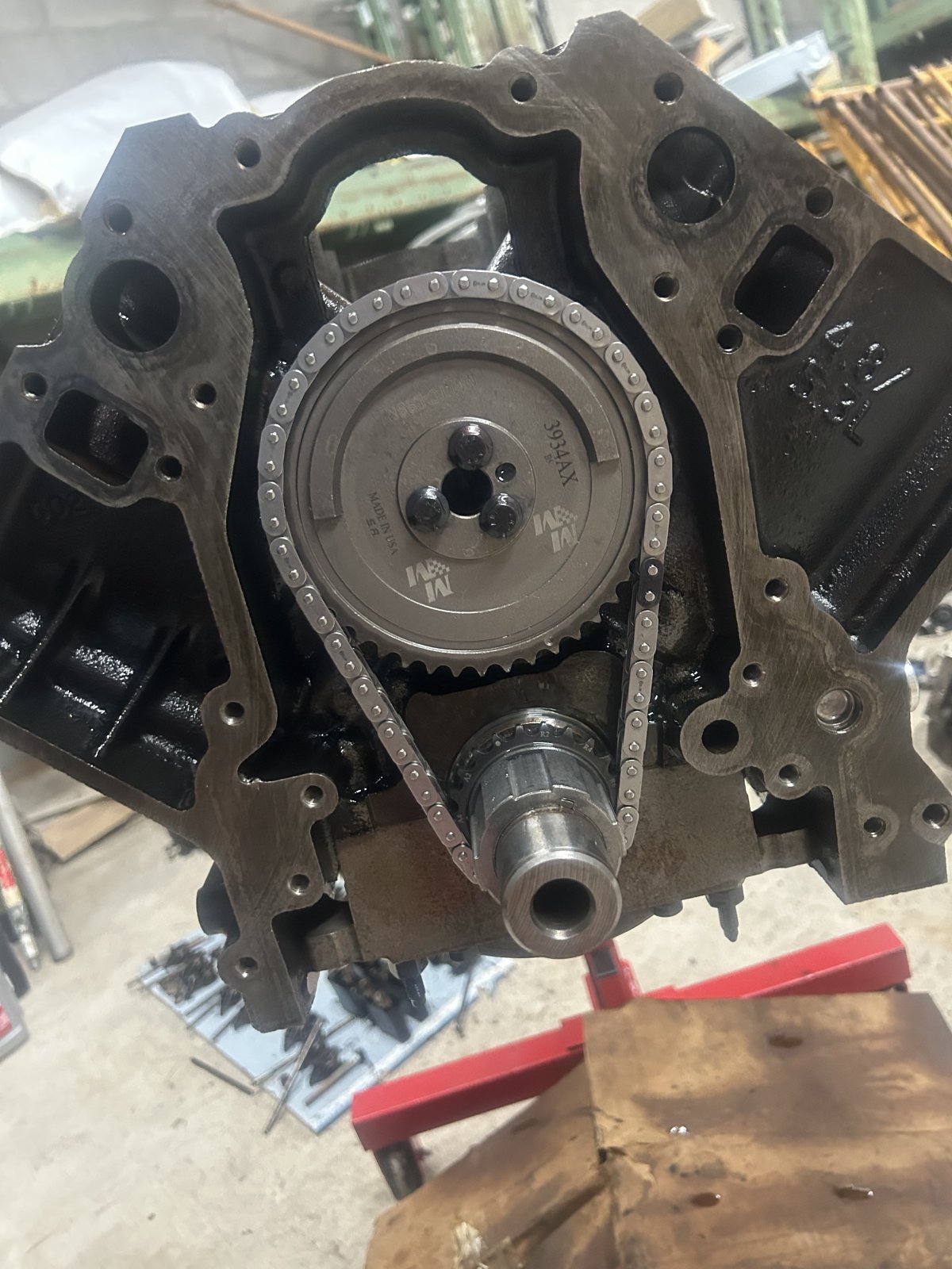

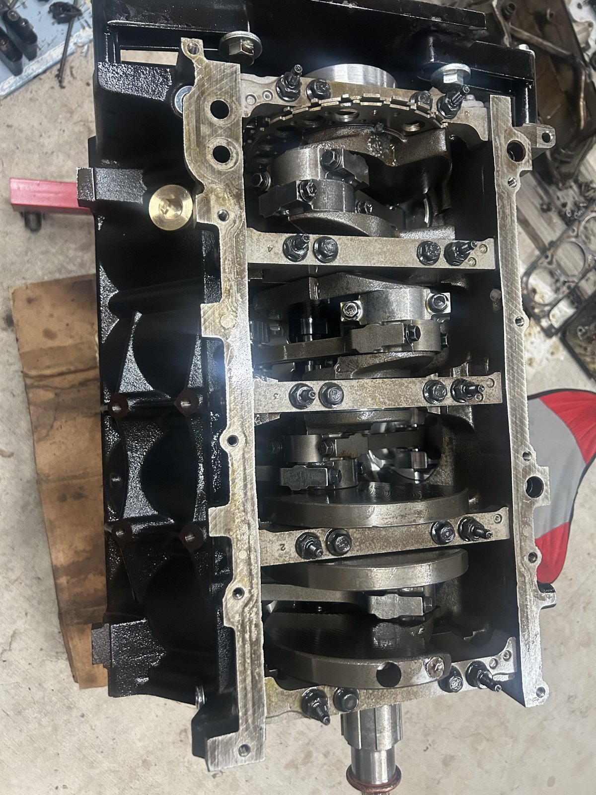

Here is yet another update, I finally got around to putting the rotating assembly and cam together. Next up is the timing set, just waiting on a tool to get the crank timing sprocket off.
