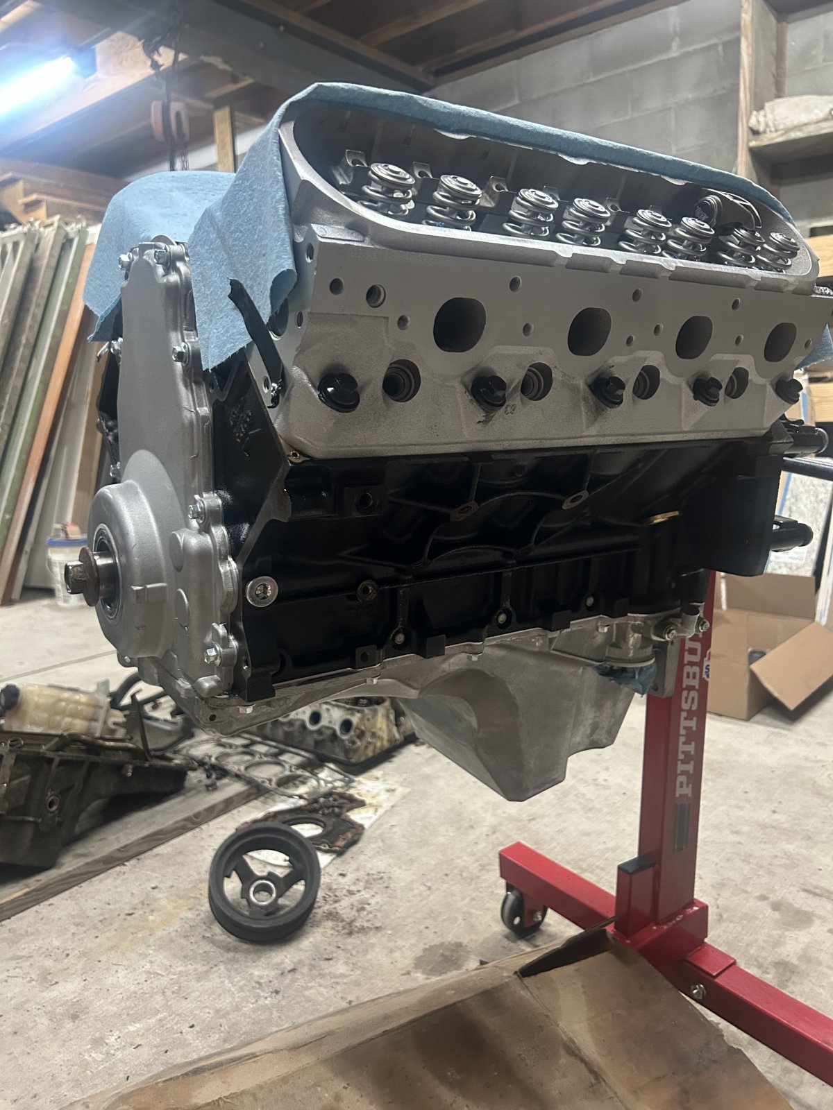

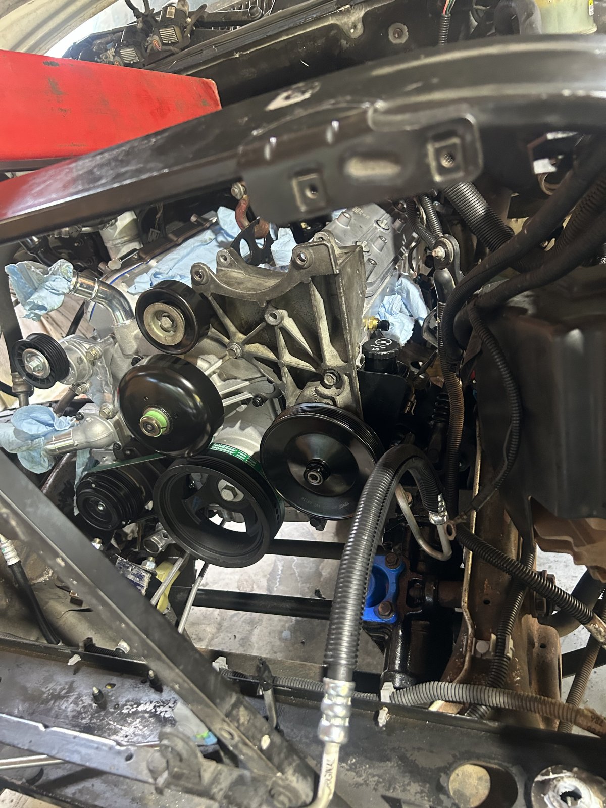

I am still making progress on the build. The heads are finally on!

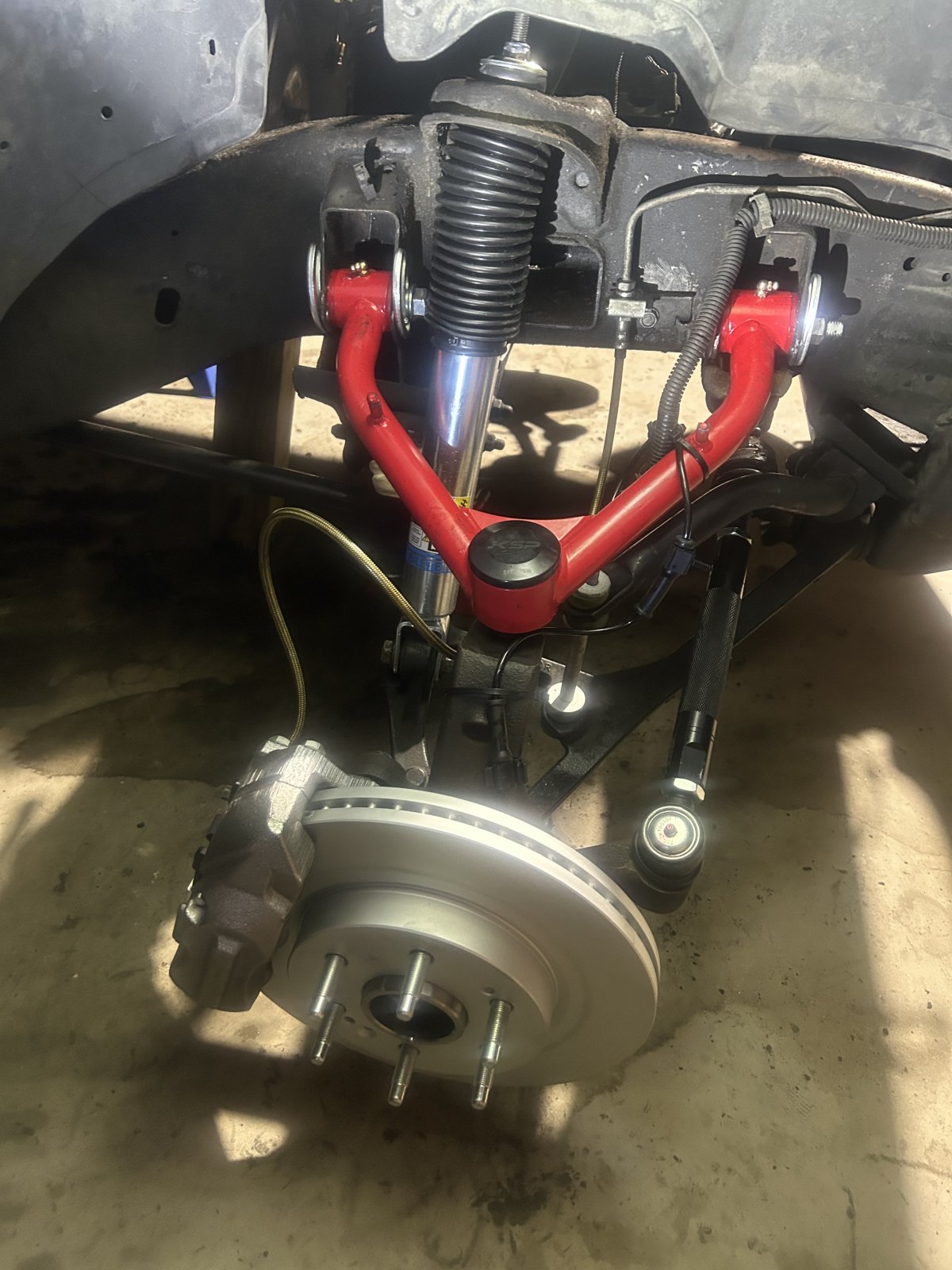

I finally got a pair of the updated valve covers, new sensors all around, and even a harmonic balancer. I am also currently rebuilding the front end suspension, and repairing the A/C and heat in the Yukon.

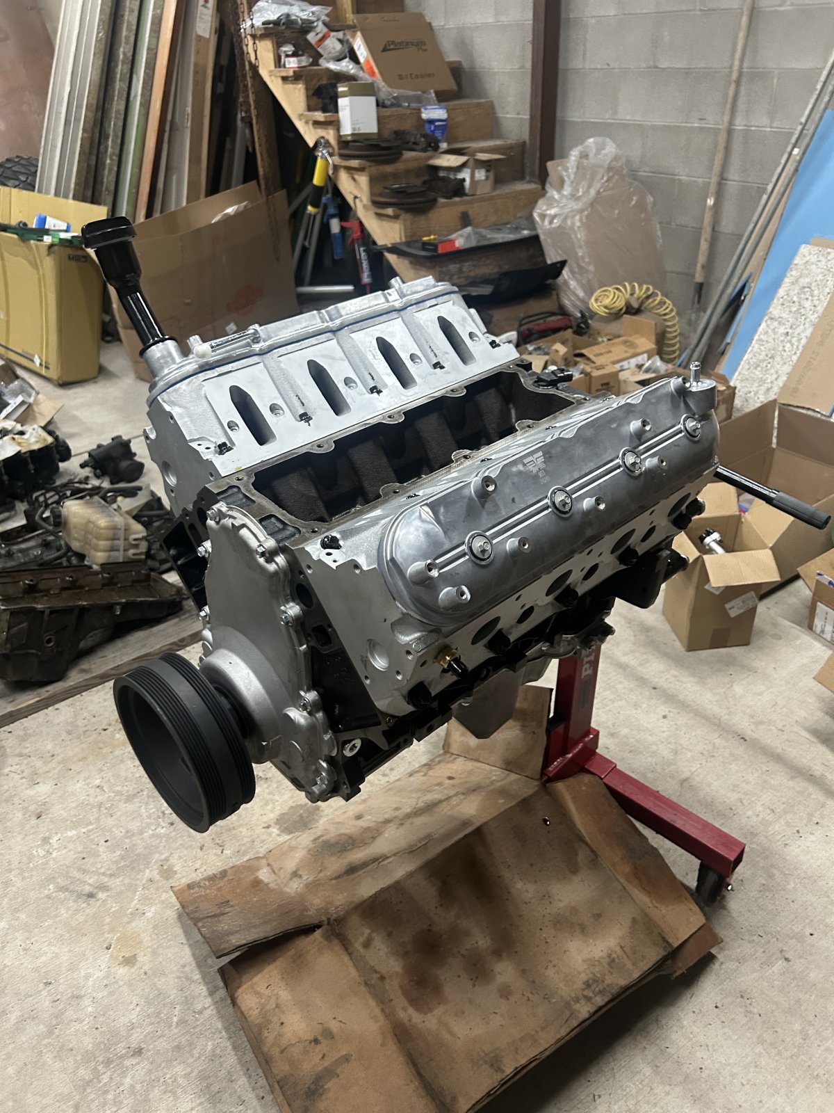

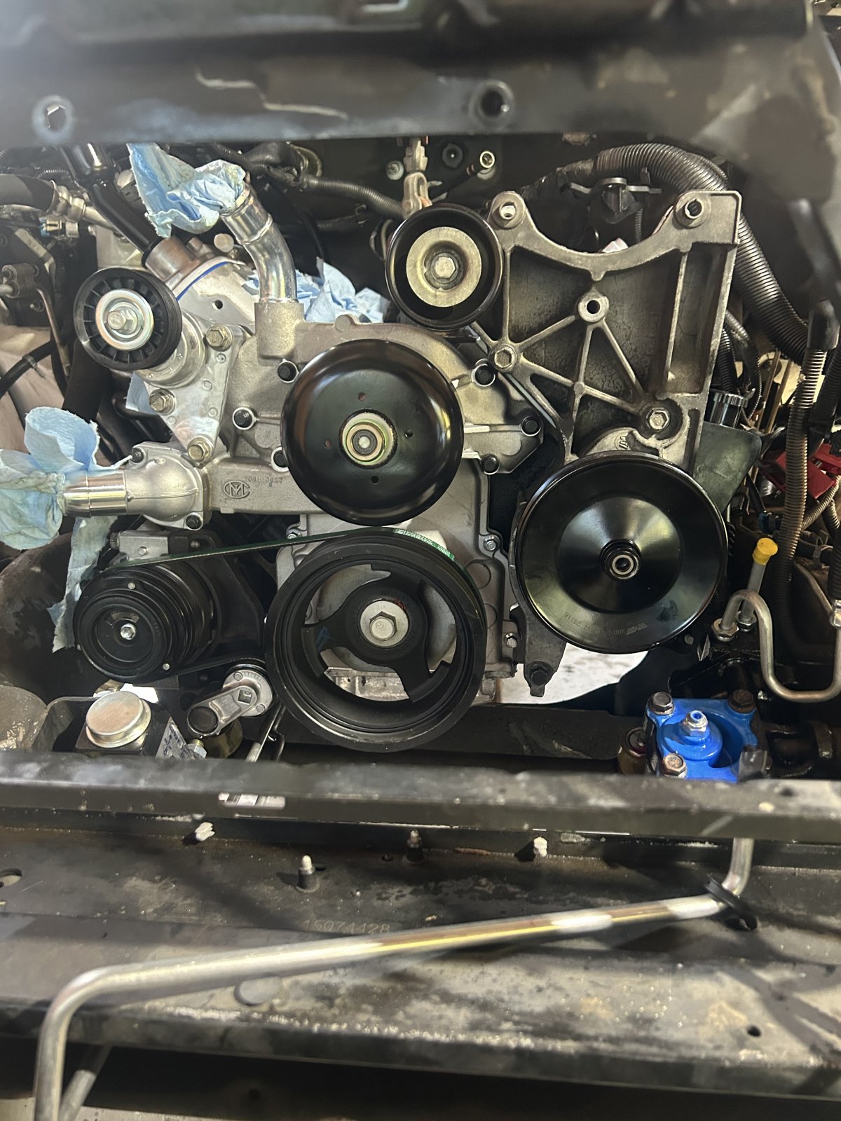

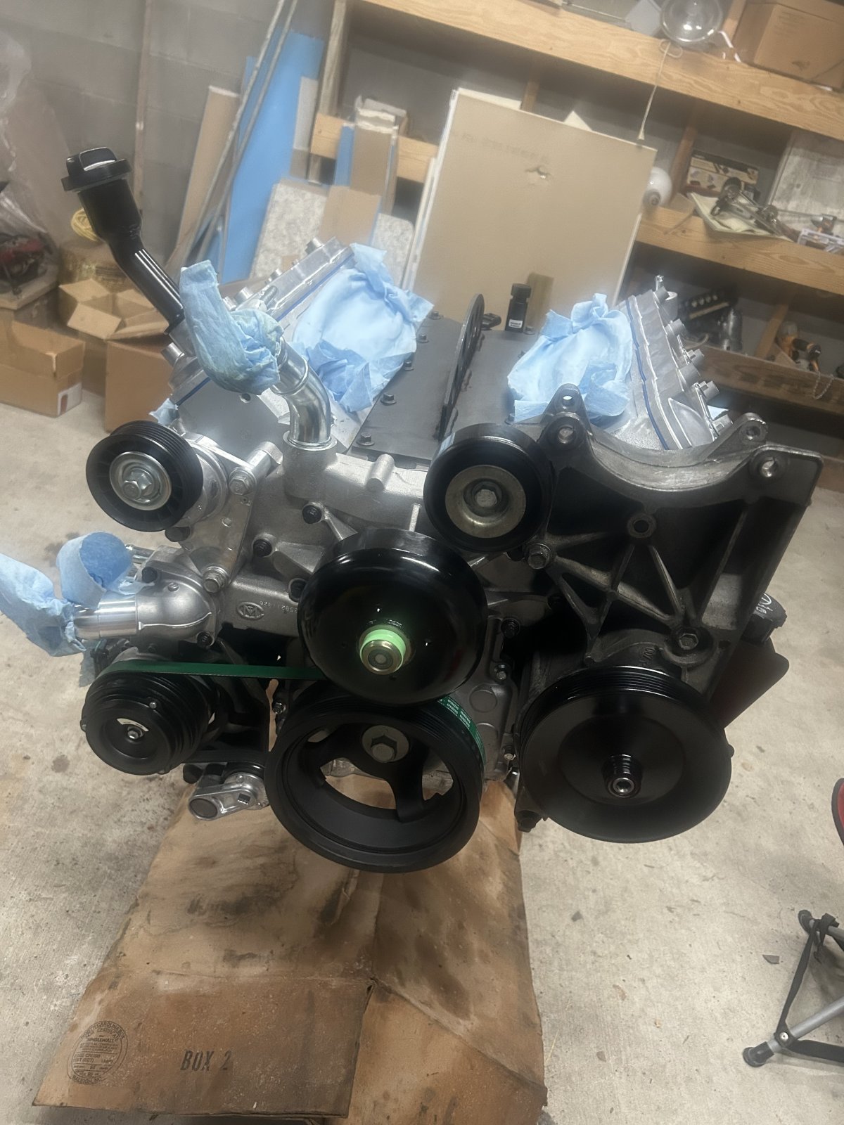

I got the block sat on the mounts today. Now onto the fun part… wiring harness hook up!

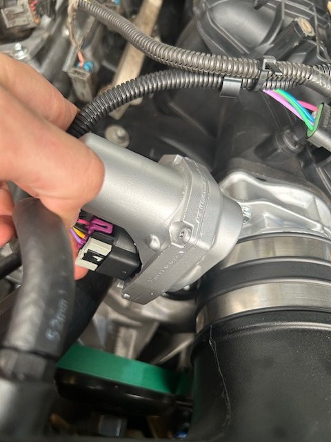

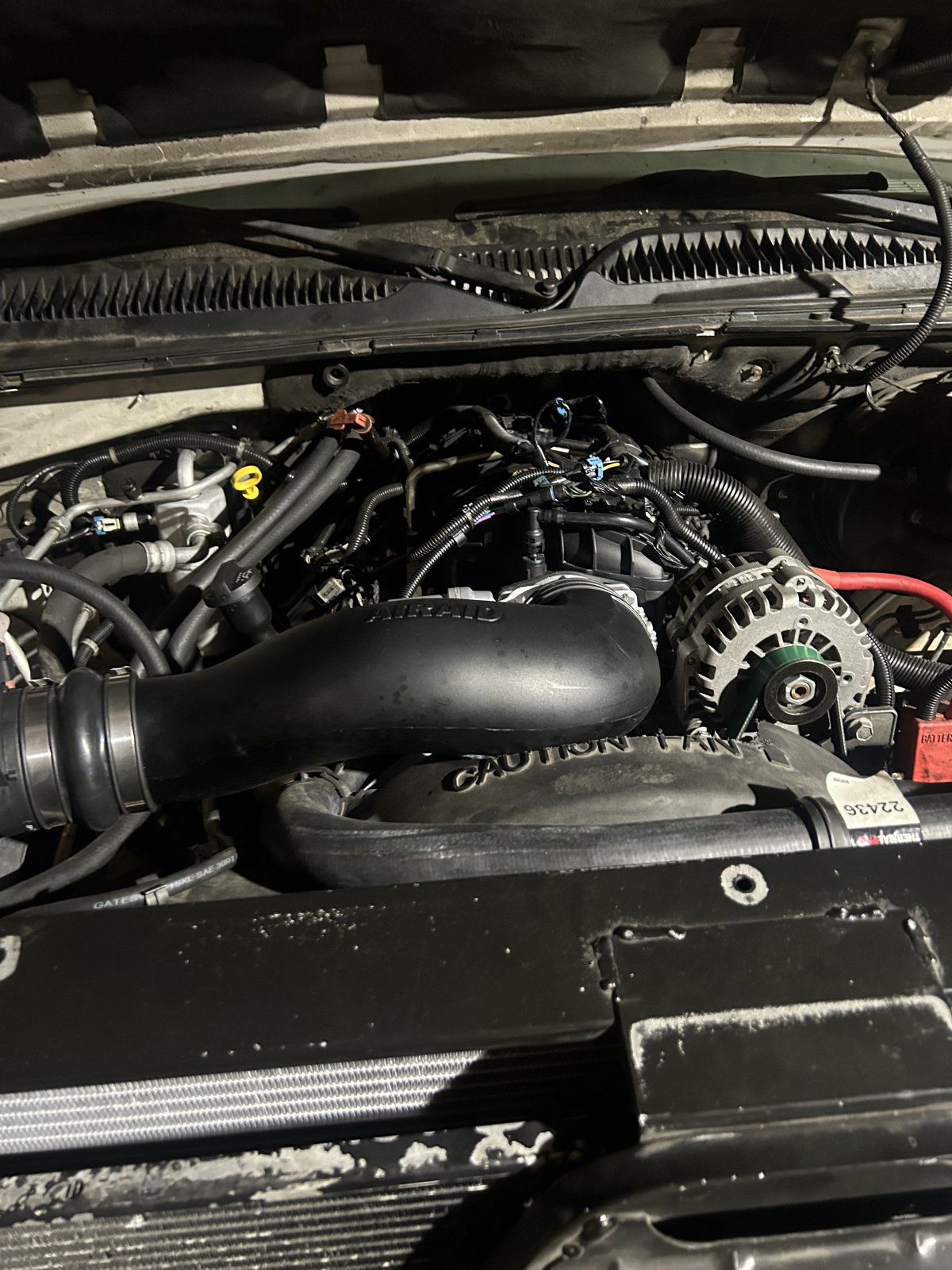

I finally got my throttle body hooked up. I had a hard time finding any information on this. For anyone that sees this in the future, if you have an early 00-02 DBW truck/SUV. You DON’T need an X-Link or LS3 TB, use the LS2 DBW TB and an adapter. It’s way cheaper and achieves the same thing.
Here is a couple pics of my “expert” fabrication skills to get the TB and Air Intake Hose to work, without hitting the clutch fan. Also waiting on my O2 sensors and Hose Coupler to finish connecting to the Air Box.

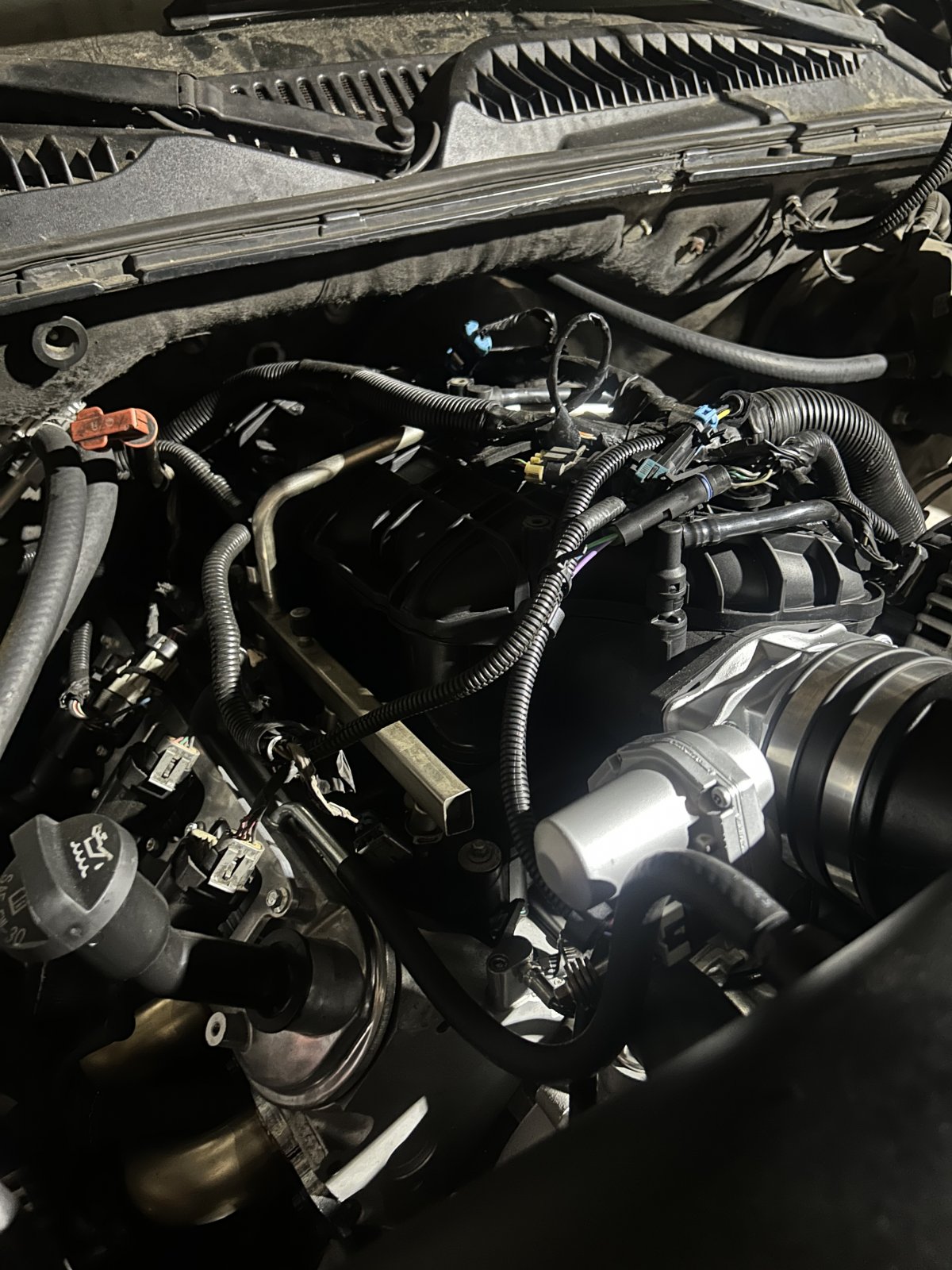

Another update boys,
I got my intake hose hooked up and O2 Sensors in. I got my hands on a MPVI2 and was able to change some things around to be able to get the Yukon running half way decent. This is all brand new to me but using HPTuners hasn't been rocket science by no means. I also managed to recharge the A/C so it's blowing nice and cold. Here is a video of me driving it around to do some break-in mileage before the first oil change.

In your comment about the throttle body, are you saying that there is a 4 bolt throttle body for use on a newer style NNBS/TBSS intake manifold that also has the same plug end as a Gen 3 truck intake throttle body? It's my understanding that the reason for the X-Link is to mate the newer 4 bolt throttle body plug connector to the Gen 3 truck intake plug connector. I don't remember off the top which is which....but one is 6 wires and the other is 8 wires.
What vehicle LS2 throttle body did you use? Car or truck LS2? What adapter are you referencing and what is the purpose of the adapter....Is it to bolt to the intake, or for the wiring 6-8 wire adaptation? Thanks

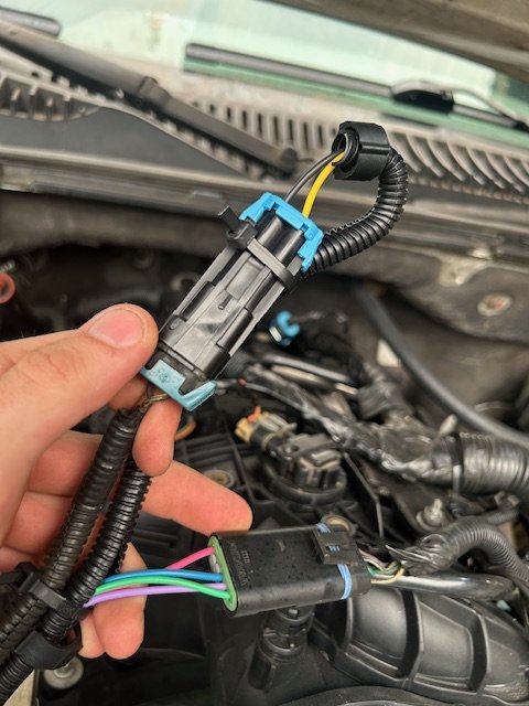

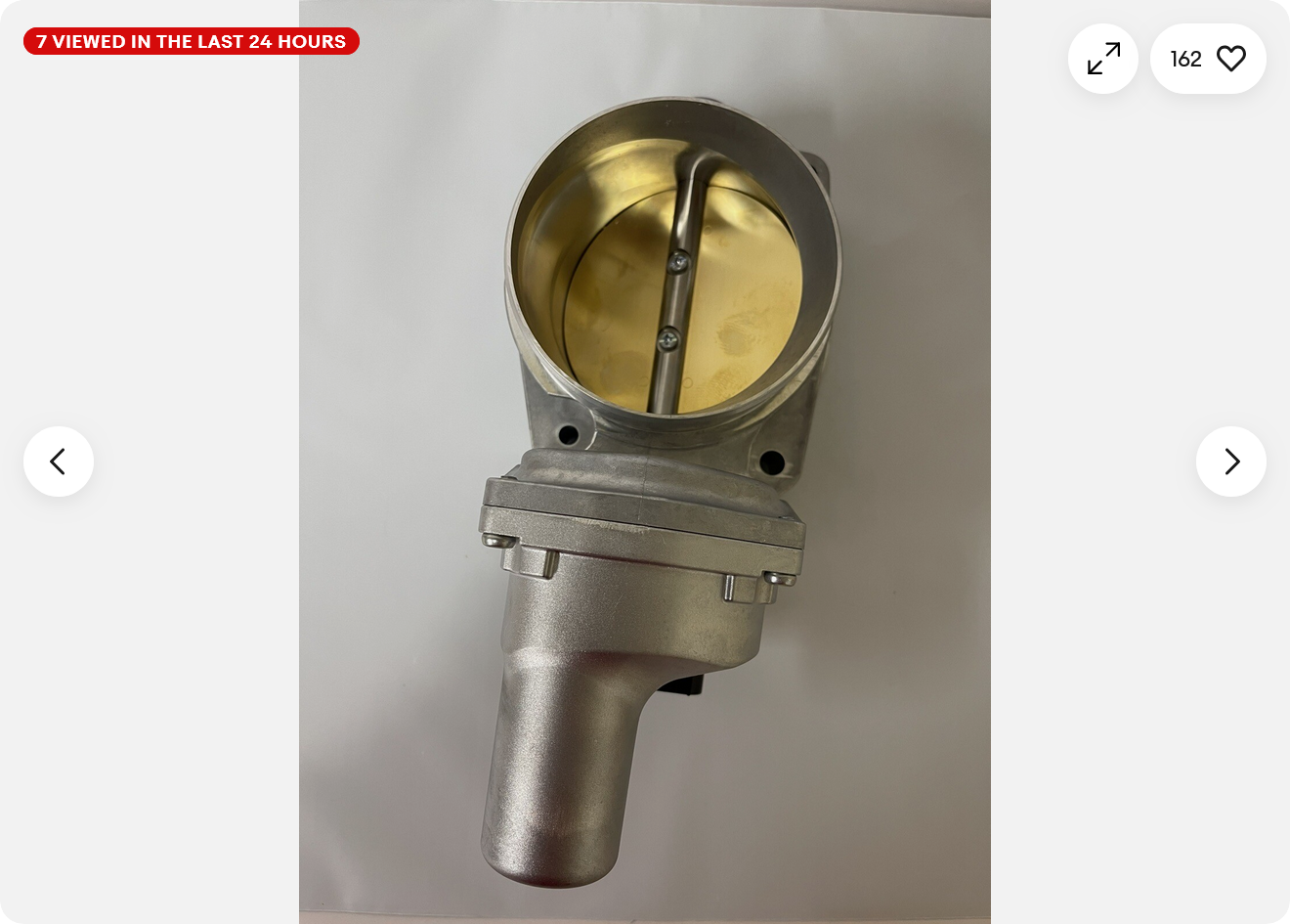

So I took some pictures of everything for ya and I'll try to explain this in the least autistic way possible. I originally was going to run an LS3 throttle body and an X-Link to accomplish the 90mm TB & GMT900/TBSS intake swap.
Screenshot 2025-09-07 at 19-26-08 GM 19420707 _ 12605109 Factory Gold Blade LS3_LS7 90mm Throt...png

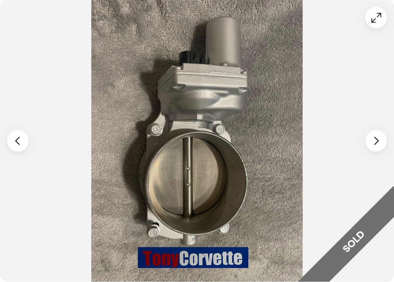

BUT, the problem is the 99-02 and 03-07 vehicles DBW TB's are different. On 99-02 vehicles with a DBW system, has 3 connectors (6 wire) while 03-07 DBW only has 1 connector (8 wire). I got lucky to end up with the 3 connectors (6 wire). I ended up having to get a silver-blade LS2 DBW TB (mine is out of a C6 Corvette).
Screenshot 2025-09-07 at 19-26-28 LS2 Throttle Body Silver Blade GM OEM GTO Corvette 90mm eBay.png
I also got this adapter from: Warr Performance that works specifically with the LS2 DBW TB's and the 99-02 vehicles. Here is the way I wired it up on my yukon:
I hope this helps if you are running into the same issue!
