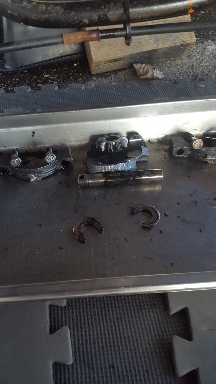

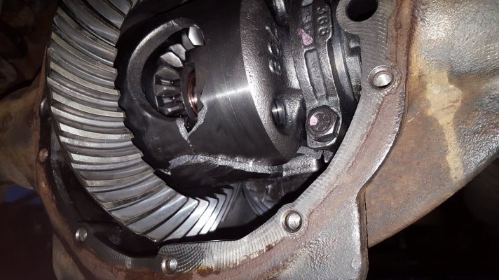

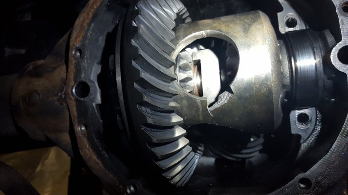

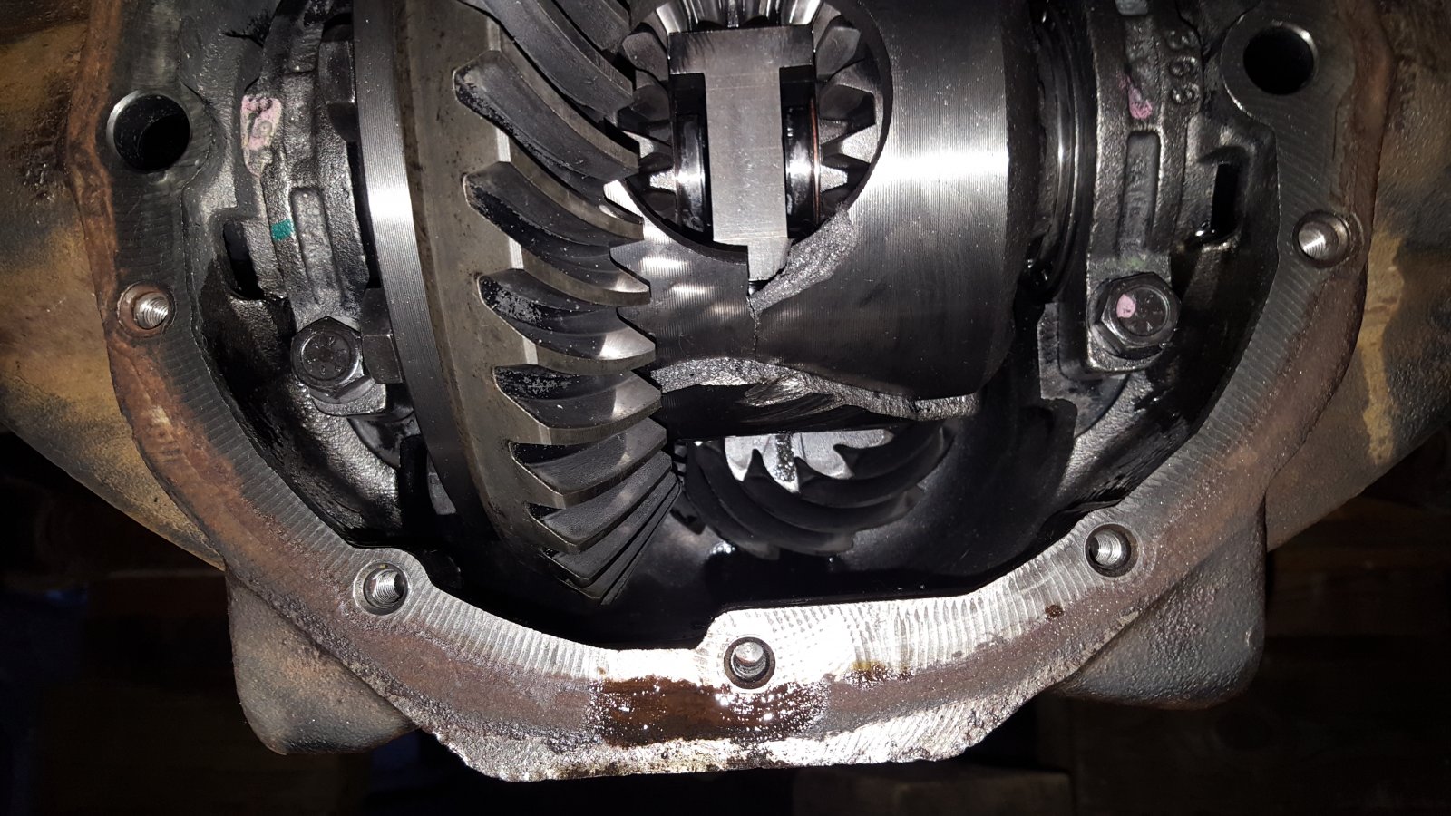

Hello, My foot and my G80 got into a fight this morning at the bottom of my driveway. G80 Carrier Case is pretty much shattered in place. A chunk of it along with one spider gear came out with the big chrome pin. I've spent about 3hrs now trying to get the C-clips off the axles.
For some reason I can't get the axles on either side to move inward the short distance needed to pull them off?? It looks like they're tight against the block in the middle already? But I can't see any splines on the outside of the clips. Could the tension from shattered carrier and spiders be preventing them from moving inward? Am I being to gentle?
Any guidance be much appreciated

presuming you took the calipers off and the pin out? I would try rotating it a little while pushing on the axle
Watched that one earlier, I hope I feel all happy go skippy like that music by the end of the weekend. Also hope I'm able to spin mine around by hand on the ring by end of weekend, currently requires bar through lugs
Yes sir, brakes off. Pin is out. Gonna try ratchet strap and smaller(size) magnet in the morn. Too cold out there now

if worse comes to worse, might try a stick of wood and a dead blow or mallet on the axle ends
use the wood so nothing gets damaged on the axle, may end up having to do axle seals though, not sure
I would get a helper, kid, wife, gf, neighbor, bf lol never know these days
maybe start easy with that process, axles are about $150-200 each don't need to add fuel to the fire

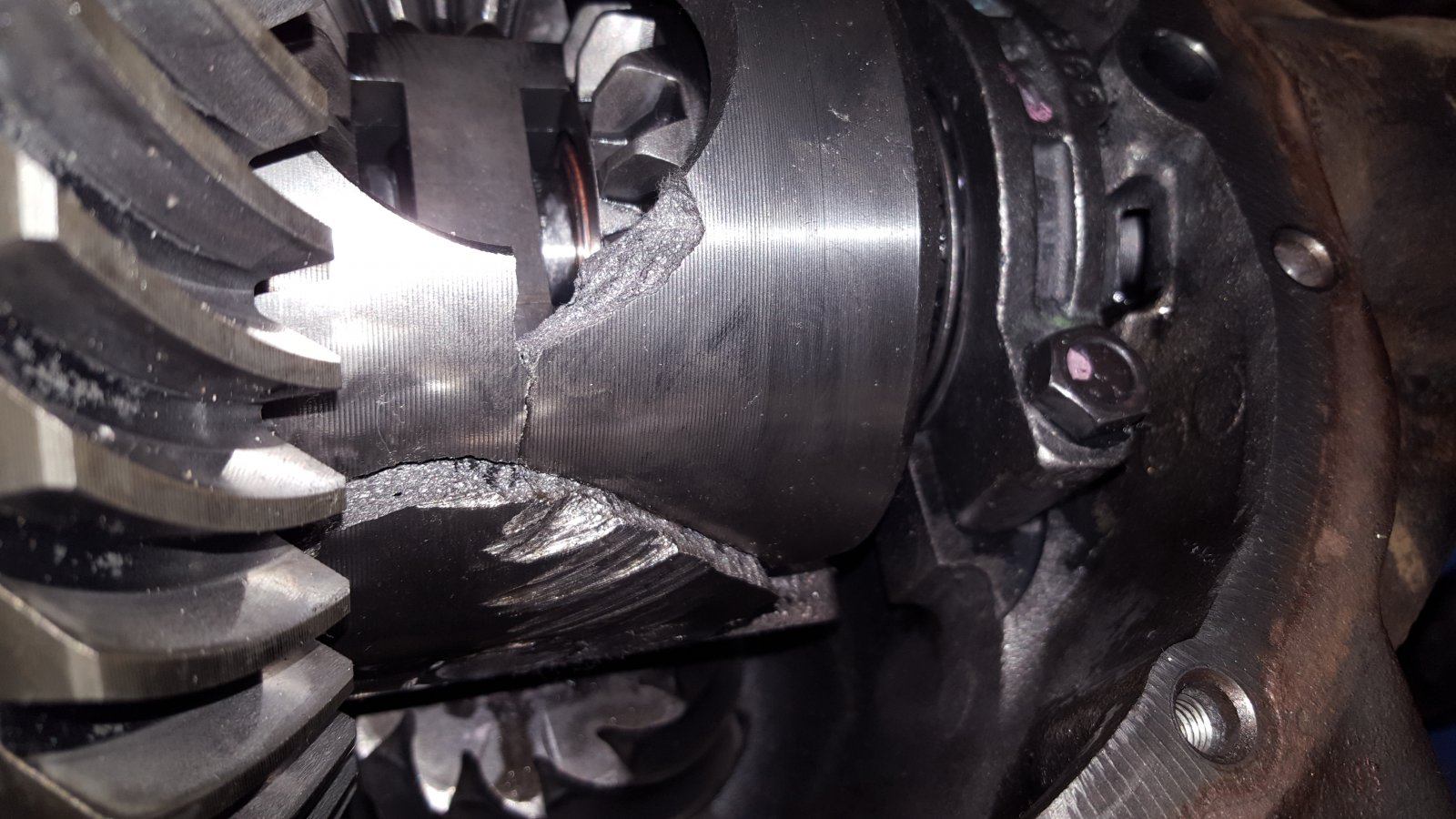

Looks to me like the carrier has squished together ever so slightly and is not allowing access to the clips. I would try to get a pry bar in the crack of the carrier and see if can pry outward from the crack and then push/bang the axle in to remove clips. Again, IMO.
IMO, that sounds like an excellent opinion. Thanks, I was trying to be as gentle as possible to avoid axle button and/or R&P damage. Temps are skyrocketing to the upper 20's over next hour so I'm about to go back at it

Using my 20/20 hindsight (because God knows my current eyesight is no longer 20/20) I was able to see the pattern of different people from completely different facets of my life telling me I was too ******* _____(insert noun of choice here), and it helped me realize that I needed to dial it back a little. Especially on things that are of value to me and those around me that are affected by that thing. Not $$ value because $$'s aren't valuable to me (personally rather have that high quality paper and ink they're made with so I could write important things down and know they could go through the washer/dryer 10x and my great great nieces/nephews would still be able to read them).
To put it in the simplest of metaphors: I finally realized that crushing the cooler because it doesn't close/seal properly is not ok. Especially when Im the one who loaded the cooler and it's the first night of a summer camping trip lol
Alright I'm goin back in... will post results.

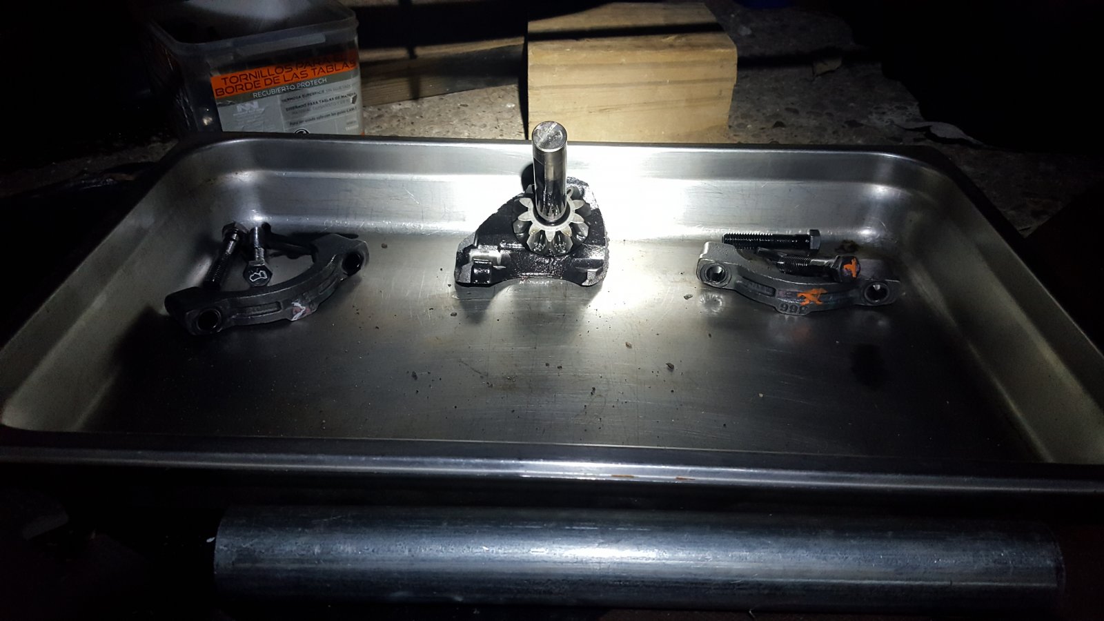

took about a 6" chunk of 4 X 6 with a 5/8 hole drilled right along one edge to fit the lug pattern, and 3-4 mild body blows from a 16lb sledge. I could see the splines showing on the outside of clips before my shoulders were past the license plate
Thank you all
gonna assess housing and axles for damages and make a pro/con list for Helical Carrier -vs- 14 bolt 3.42 G80 w/25k miles?
