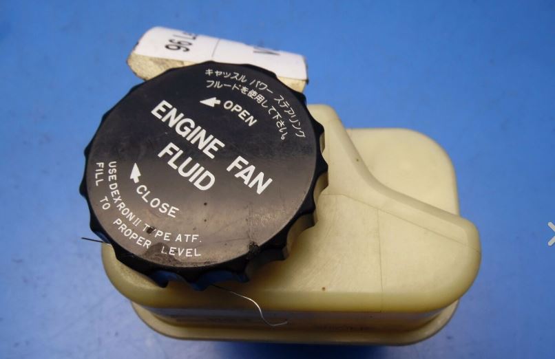

Needs more Engine Fan Fluid!
my does it with remote COLD start.. Perfectly normal if you are that worried keep an eye on the temp gauge should be a 1-2mm passed the middle.
it had been about 100F outside the passed few days.. mine stays at 15Volts (14.8 but rounds up to 15volts)
that is includes the dual A/C system ON
but it is a High Voltage Direct Current to 12+VDC step down. 185amps
i can check tomorrow it's going to be like 97F
Doh, engine fan fluid, how could I have missed that!

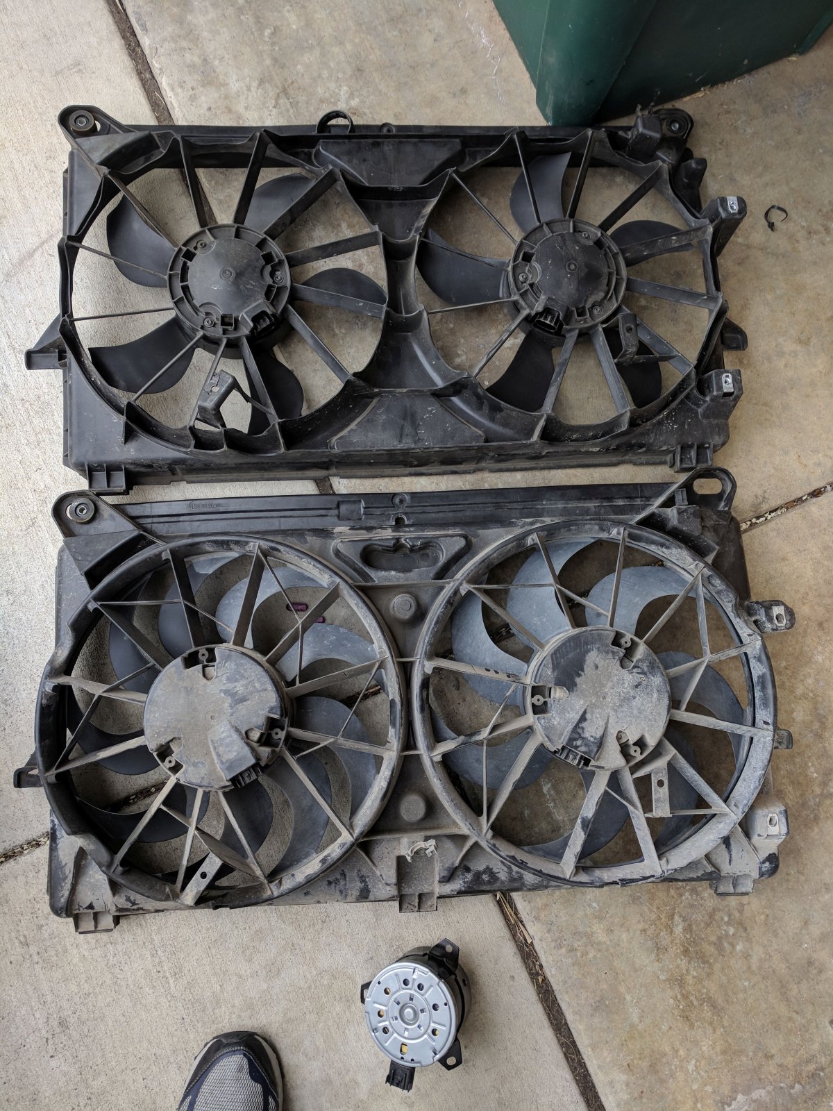

Anyone know if the fan motor can be changed without taking the radiator fan shroud assembly out? Trying to determine if the fan motor can be accessed from the aft of the radiator shroud. Thanks!
30,478
47,822
nope, the shroud is pretty easy to take out anyway, take off the intake housing and push the radiator hose back by hand it comes right out
edit: I would say "maybe" you could do it but it's going to be a real ***** compared to just taking the shroud out, there is 3 pressure clips and I think 3 screws (not sure it's been a minute since I did mine), then you have to clearance to get the fan and motor out, then put it back in and put it back together.

it may be possible depending on which fans you have, on mine the original motors screwed in from the backside, on the k5l you have take the blade off from the front (pressure clip) then the motors are screwed in from the front behind the fan blade, (see photo)

Mine are the 5 bladed ones like in your picture. I will try that first since it would be easy, will wait until Monday night though.
