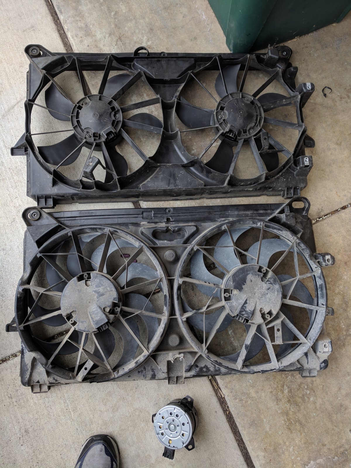

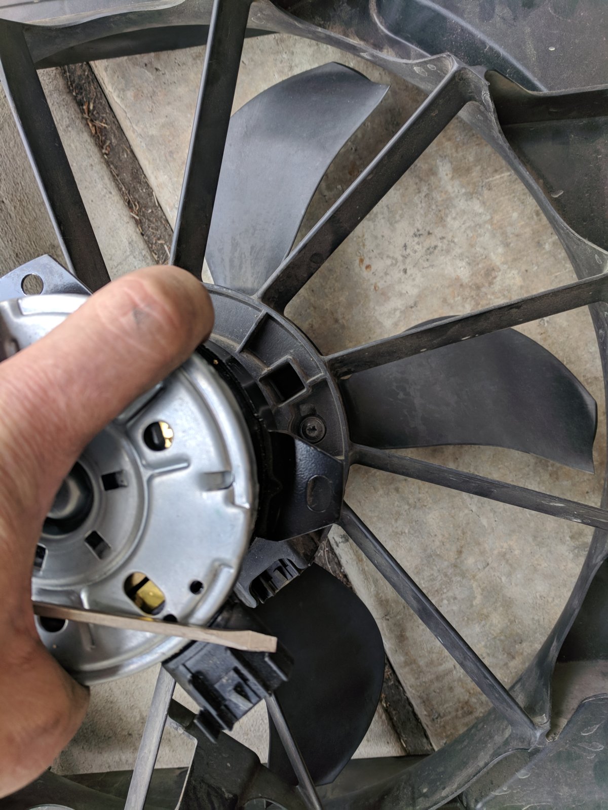

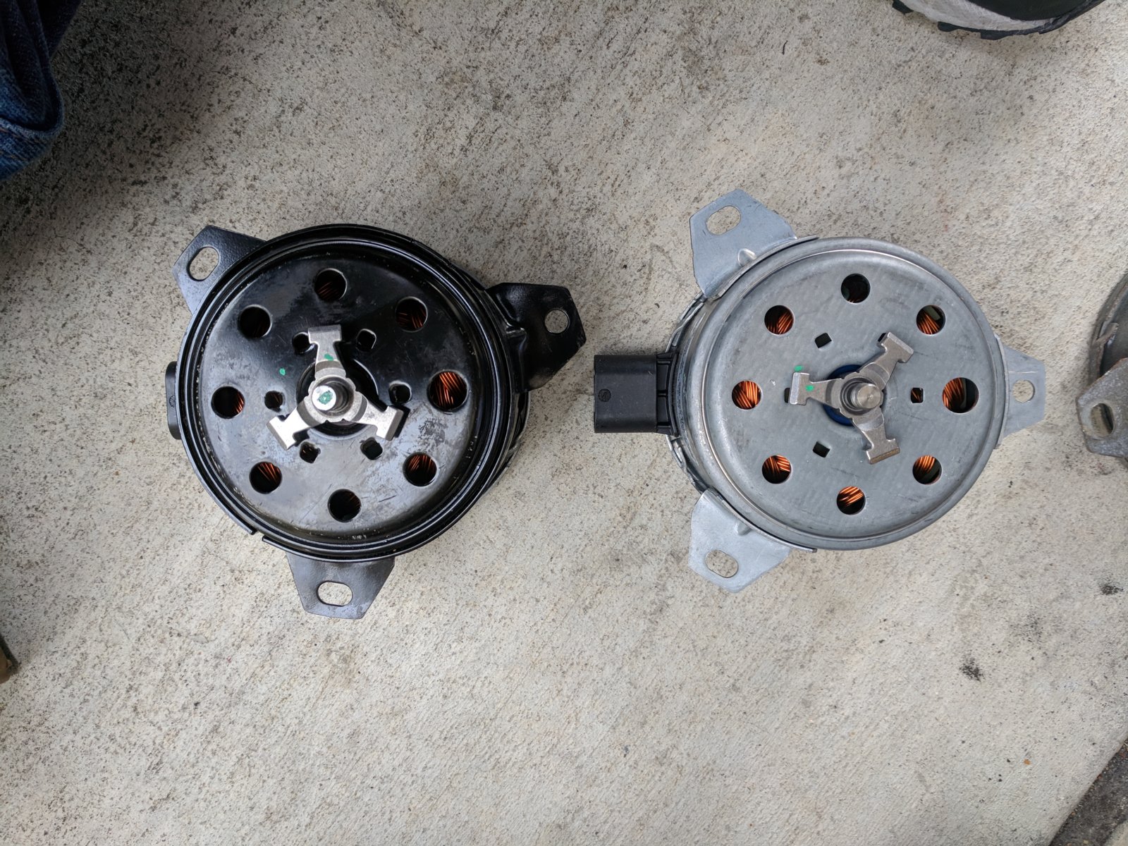

ok, well the 700 watt motors for the 7/9 blade fan housings do not fit the 5 blade fan housings, also the left/right motors are different size and mount differently.
the 7/9 blade motors bolt up from the inside and 5 blade motors bolt up from the outside
the 7/9 blade fans are approx 1/2" bigger than the 5 blade fans
the 7/9 blade motors are heavier also
so overall I decided to go with bigger 7/9 blade system and put in the new motors there nice and quiet!

Quite a difference I'd say! I suspect that the main benefit will be in the duty cycle, they'll run less often and allow the drivetrain to work harder in hotter conditions. Same setup on the 2500s too. Probably good for the battery(s) as well!
