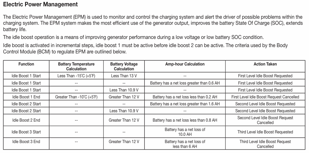

As others are saying, the RVC system charges the battery as needed...
Supposedly tends to keep the battery charged to ~80% from what I've heard? (For battery longevity?)
Below is from '08 wiring digrams, no guarantee '07 is identical...
If eventually you do need an alternator, the 165A will drop right in, and later model 220A alts also drop right in.

next time you see it down real low just turn some stuff on headlights, defroster, seat heater or cooler, etc
that should make it switch modes within a few minutes, if that does not work then there could be a problem. the type of problem really depends and takes a bit of investigating.
already been down this road.
The RVC modes also really depend on how you drive. for me it almost never goes into "economy" mode
