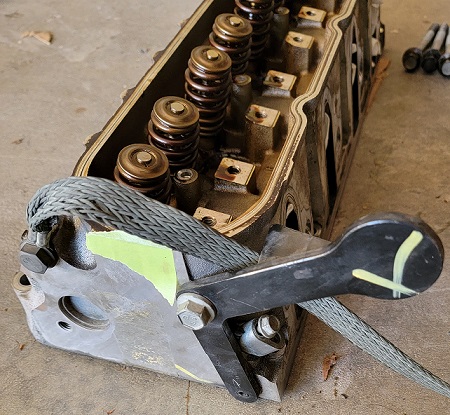

hey guys, work has commenced and it is torn down to the point it needs to be to start the cleaning then the reassy.
the only question i have at this point is, what the hell is this black, in the way thing and do i need it?
Moderator
16,620
34,397
People's Republic of Colorado
In the event of a front end collision it's meant to keep the fuel rail from breaking off on the firewall. Fire prevention.

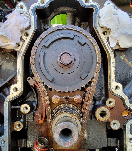

onwards and upwards, i come to the second question with second guessing
so this single piece of plastic thats not touching the chain at all-
is the only thing thats supposed to go there to replace this cute little OG setup that gently nuzzled against it?
That's been driving me nuts too, thanks for the education @Fless .

Well on the fuel line bracket, I figured it was there just keep stuff "in place", maybe
during assembly or something... I did Not put mine back on when I had the heads off..
On the timing chain, Yes that's it.. The plastic rubbing type eventually wears off
and spits shit into the engine... But yours looks "loose" (the chain) to me...
If I were this far on yours I'd put a new OE chain on for sure. Doesn't have to be
a GM brand, but just an oe replacement
To add, the LS2 "bowtie" chain tension is just to keep it from Whipping when
accel or decel, not to keep "slack" out of it like the orig
yea i should replace it. i dont know why i didnt pre order it with my other shit. that and i dont look forward to pulling/ installing a new crank sprocket. im sure thats not gonna be a pain in the ass.
it was all just a dry run anyway cause i was concerned with the end difference between the one bolt stock cam and sprocket and the new 3 bolt L33 cam and sprocket.
the old cam had a longer "nose" on it, between where the sprocket mounts and the first bearing journal. i measured the thrust plates, cams, and sprockets. luckly they both have the same gap of, what it appears to me and my old mics is a gap between the sprocket and first journal of .175 with both new and old plates being .160.
i might be off a little cause the last time i had my mics cal'ed was 4 years ago but im ok with both of them having the same measurements after going between the two 3 times.

I'm pretty sure that if you go with just the stock chain, you can just replace the chain itself..
You would not need to remove the lower sprocket.. Just the upper cam sprocket which you've done already
im just goin by ol' man-well here, and hes sayin "timing chains must be replaced as a set. never put a new chain on old sprockets."
I'm really the same, but on these gen 4 engines I guess the sprockets are really robust..
Do some more research... That gear shouldn't be that hard to remove either.. You've done
all the hard work already
When I did my cam/lifters/head work... I had a new oil pump and chain all ready but I just
didn't want to drop the oil pan (on my back).. And my tensioner and chain looked really good
and oil pressures always rock solid. So I didn't. Did this this spring w 115k. I'm 2nd owner
