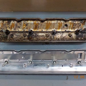

Improved driver's side rocker cover. GM PN#: 12642655? - improved...how, exactly? ive read less oil consumption but, is there something else i need to do for this, as in, an extra item or step or just slap this hoe on and send it?
With the original design, the port in the baffle was in such a position that oil flicking up off the rocker at higher RPM bullseyed straight into the port, filling the baffle with more liquid oil than what could drain out before being sucked up by the vaccum hose of the PCV system. The relocated hole prevents such a high volume of liquid oil from filling up behind the baffle so the PCV system just gets more oil mist than straight up liquid oil. It's absolutely a worthy investment. This and a catch can should be standard on any LS engine.

and finally-
Valve cover driverside – GM# 12570427
Top is original oil sucker
Bottom is new improved
