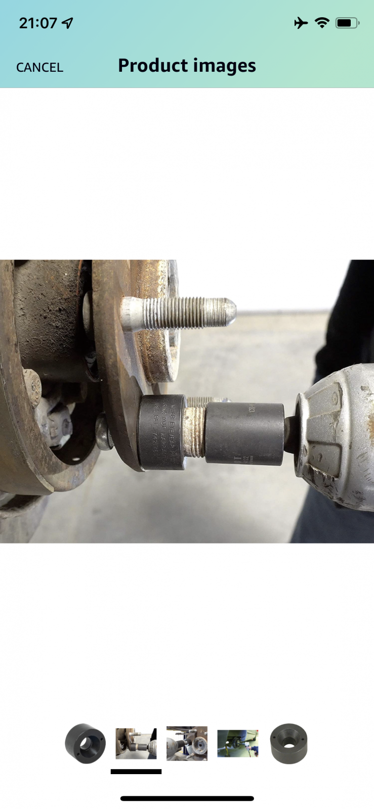

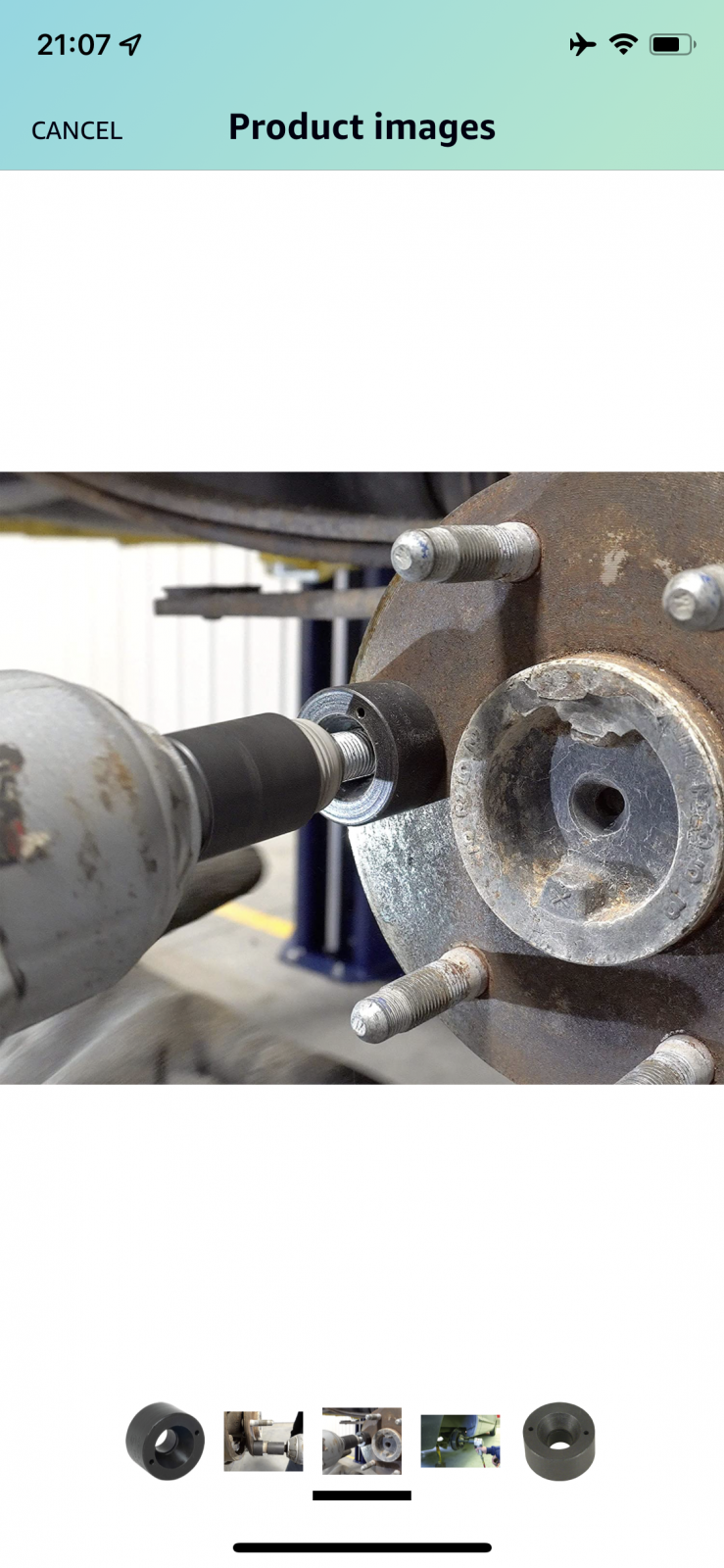

I saw the auto parts (NAPA, O'Reilly, Autozone, etc.) all listed a specific tool for stud install.
some kind of spacer with a conical indent to mate up with the lug nut. The back side is flat to go against the axle/hub flange. It looks like it makes the pressure even, so as to not damage threads on the stud.
Seems like it would be OK. That might allow the studs to be installed without beating on them.
You still have to knock the old ones out, so maybe back to the idea of something substantial to back up the flange and use the hammer to get the studs out and new ones installed.

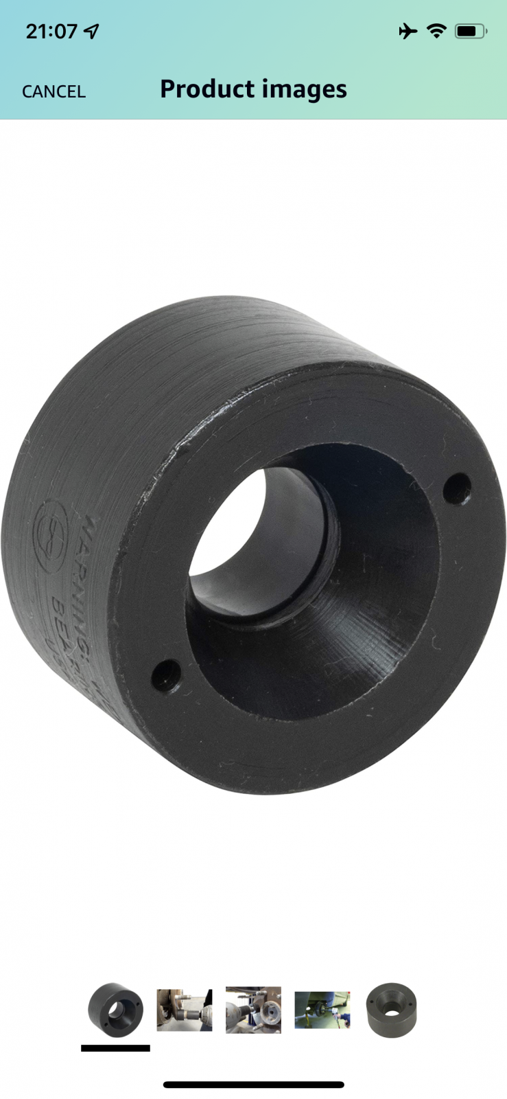

Is this the type you saw?
I have this one and was going to use it to install the new lug studs, which are slightly longer to accommodate the 10mm spacers I’d like to install.
I don’t want wheel adapters, which seem like they have more fail points than slightly longer studs and spacers.
