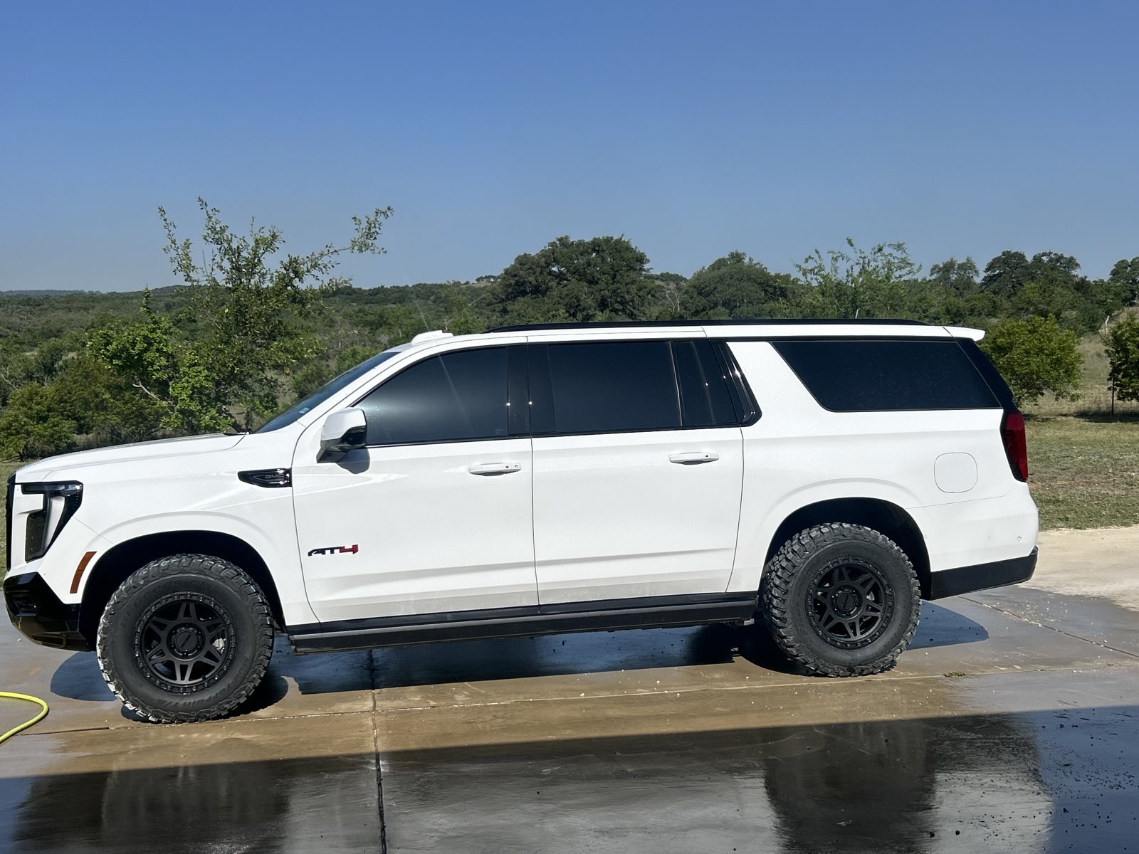

ordered some cheaps from Amazon. Tested 3MM and 5mm. 5’s look better and provide full clearance. Will put me at +13 offset overall. Sent cheaps back and ordered some both hub and wheel centric customs.
J
Ja1034
Apr 16, 2025
33
22
Finally got them on. Ended up with 6MM spacers so essentially changed it to +12 offset. Wife loves it, so that’s all that matters.
