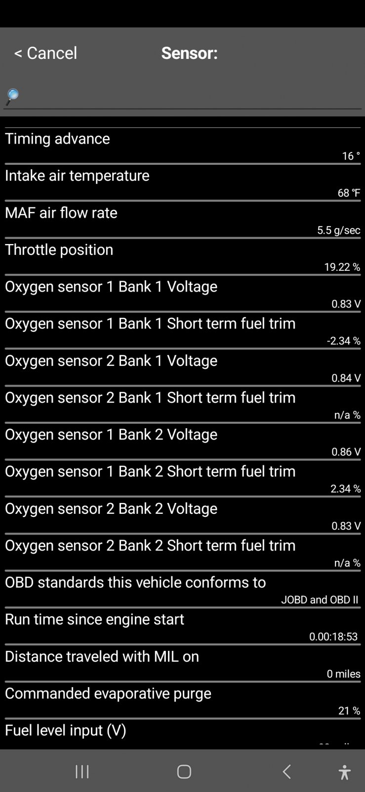

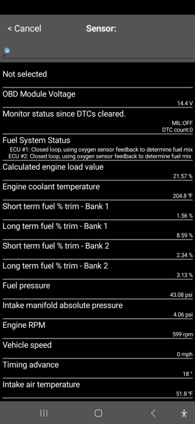

See attached data. Trims don't change much at 1500 or 2k rpm. Even though the sensors on bank 2 sensor 1 and 2 are either brand new, or replaced last year. I think I'm going to swap out the Upstream sensors this weekend and see if the code follows the sensor. And if that doesn't work I guess I'm going to be buying a better scanner with injector capabilities. Currently just using a cheap Bluetooth OBD scanner and the "car scanner pro" app. But I have had my eye on some Harbor Freight upgraded scanners. Anyone have any good suggestions? Maybe something that can actually tell me what injectors are doing.
Also for this weekend would be pulling all of the spark plugs and doing a compression check on each cylinder. Maybe I have low compression in one of the cylinders on the bank two side. Even though there's no misfire data.

The only thing that stands out in the screen shots is the sum of the short- and long-term fuel trims for Bank 1; everything else seems okay. Being that close to 10 deserves a closer look at some point, but is likely not related to the current code on Bank 2. (Bank 1: dirty injector? Verify all the intake bolts are tight to spec?)

yeah adding 10% fuel to bank one seems a bit high. usually that's closer to +/-5.
not that that helps you much. but yeah, maybe it doesn't like the split. if you swap sensors be interesting to see what it does.
I believe you can add pids to car scanner app if you can find your injector ms pid. it's usually only bank 1 vs band 2 thing. not all 8. the refresh rate is to slow for that to be much help anyways

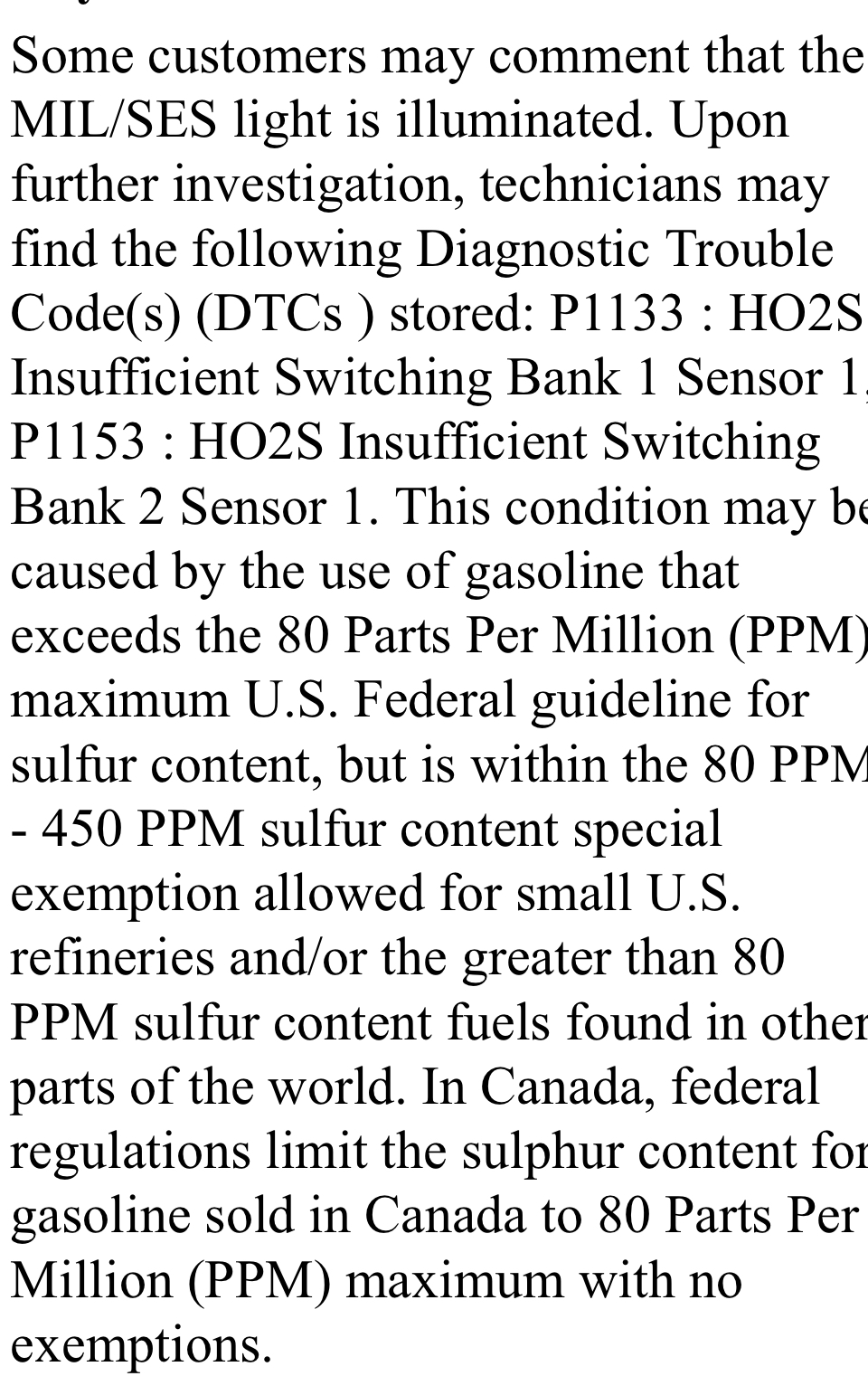

TL;DR: The issue was the TSB reprogramming (not the O2 sensors). When I replaced the part a year ago, I likely installed "new old stock" that premature failed. The second replacement was maybe "new stock," which the ECU read differently? Maybe they aren't exactly the same? Either that or my car is running worse now for some other reason (old cats, worn injectors?) and that was tripping the code just over the unprogrammed ECU levels? Not sure exactly but at least getting the ECU updated, fixed the issue, not another O2 sensor. I am tempted to put the old (from a month ago) 02 sensor back in, but just assume not to mess with it at this point to prove anything to myself.

  • Returned the car the next morning and pointed out (again) the TSB for this issue, and gave a full written list of all my previous repairs or tests that were noted above that were related. I also printed out the TSB and gave it to them as I was concerned they had ignored me on that topic the first time.
  • This time, I pushed for the ECU reprogramming at no charge—minimal effort/cost for them. They agreed, reprogrammed the ECU, and.... it worked. After a drive cycle, the car passed emissions (Utah only requires CEL off and readiness checks).

anyone have the tsb to read?
was reflash part of the tsb?

Wholly Ship! Small refinery exception for allowing greater amounts of sulphur than permitted in gasoline?!?!? Thus triggering a check engine light!!
I’m going to have my ECM reflashed even though this TSB says it’s specific to 08.

I don’t think the gas here in Utah is 80 ppm sulfur based on the article link found below, and this doesn’t seem to be a “small refinery” issue. The state has made significant efforts to clean up Salt Lake City’s winter air. From the sounds of the TSB, it seems the dealership just adjusted the ECU limits to allow up to 450 ppm sulfur before triggering a code.
This might mean it’ll be much longer before I see Catalytic Converter or P1153 codes again, which is good in some ways. However, the downside is that my car may not be helping the inversion/pollution here in SLC. That said, it’s “legal,” and I only drive about 4K miles per year. I usually fill up at a Sinclair station near my house, so my gas should be well below the old 80 ppm sulfur limit based on the article at the bottom.
