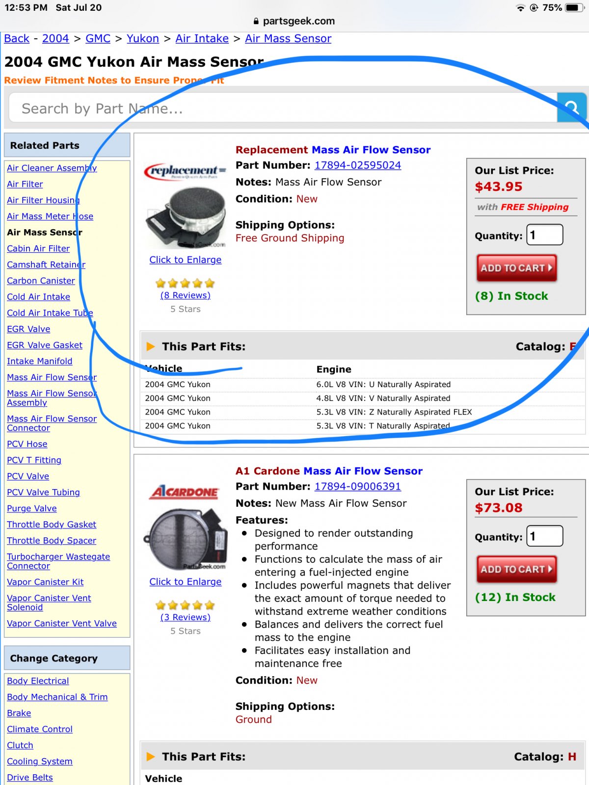

The replacement MAF was from parts geek. I guess maybe cheap could cause me the problem?

For sure but what I forgot to mention is what Dub said about resetting the ecm. If I’m not mistaken the old codes just went away when you put the old MAF back on. For sure cheap can cause problems especially on a fairly inexpensive part to start with.
