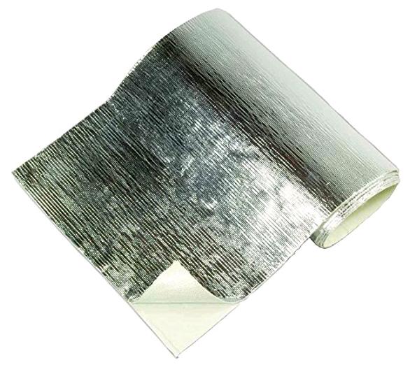

I would wrap the fuel lines, up near the engine/transmission, including the fuel rails with a heat reflecting wrap, like the foil backed fiberglass stick on wrap for starters.
This is a very simple thing to do and should rule out vapor lock as the issue.

puckhead
May 1, 2009
3,146
65
CO
I got something like that, just not as wide. That one looks as tad thicker too but I think they are all pretty similar.
You can buy a smaller piece as a starter heat shield. I have used it before and it does a great job.
It is basically the fiberglass header wrap with a foil backer to reflect the heat.
