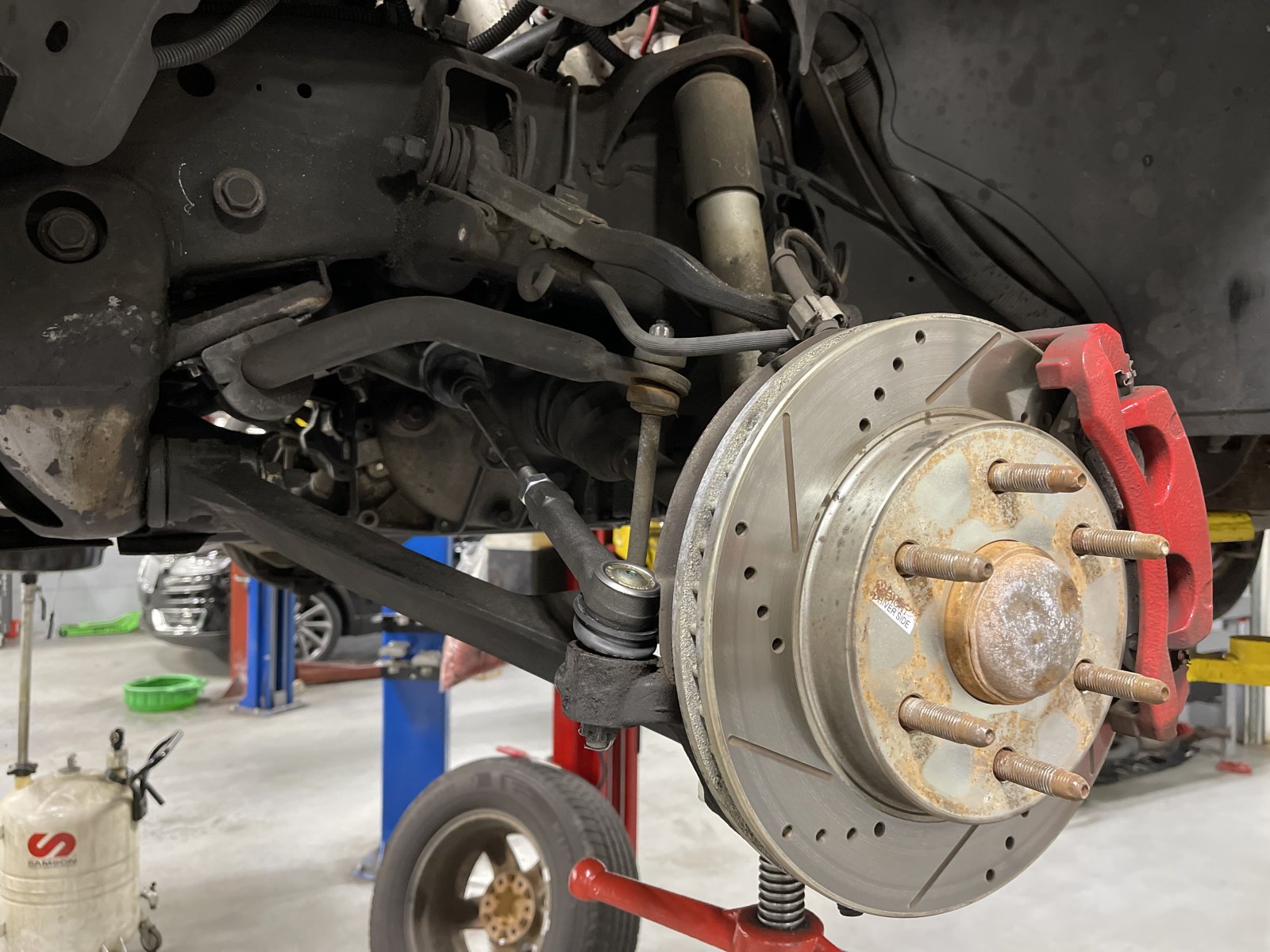

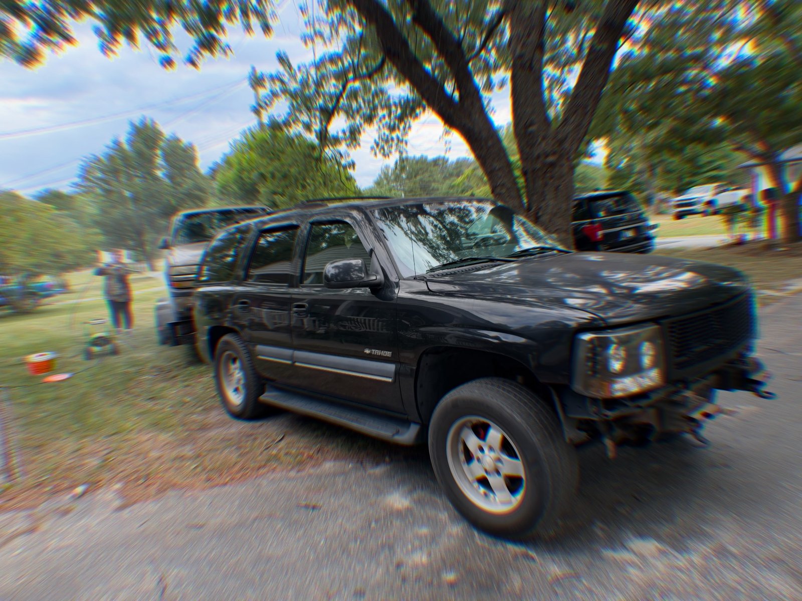

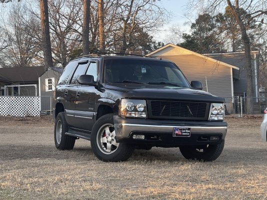

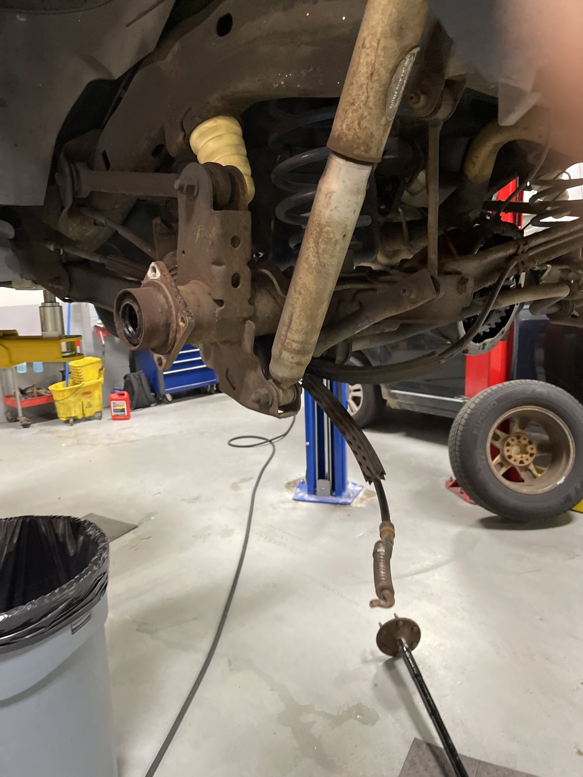

Hello, I have a 2002 Chevy Tahoe 4wd, which has a 2” lift along with Bilstien shocks, unknown what springs. I also have upgraded brakes from PowerStop, which are meant for lifted vehicles and for towing. I tow a 7x16ft trailer regularly picking up scrap and occasionally towing vehicles. I’ve noticed when it is loaded down it squats pretty heavily, I was wondering what I should do to help reduce the squat and unnecessary stress on my drivetrain and suspension. I’ve included some pictures of my truck, one showing the squat, front suspension, a random picture of the rear while doing repairs, and a normal picture.

Well for starters, you're squatting so bad because the truck is missing a couple hundred pounds with the front bumper removed.
The 2 inch lift also contributes to the squat.
Your truck originally came with Nivomat self-adjusting shocks out back (ZW7 paired with G65). Judging by those photos, they're long gone. If memory serves, the springs paired with the Nivomats are much softer than a Z71 or plain ZW7 setup. Those use the Dorman 81069 or something like GM 25783733 or ACDelco 45H2164/19255624.
Yea I’m sure some of it is because of me not having my front bumper on, however even with the bumper on it still squats pretty heavily. I’m looking to get a new off-road bumper eventually, but currently I’m painting my current bumper because the trim piece after I replaced my bumper didn’t match the color of my truck. I didn’t think the lift would have any impact on my towing. Yea the old owners decided they wanted to lift the truck and change the suspension. Well it looks like I’m replacing my springs. Thanks for the advice
