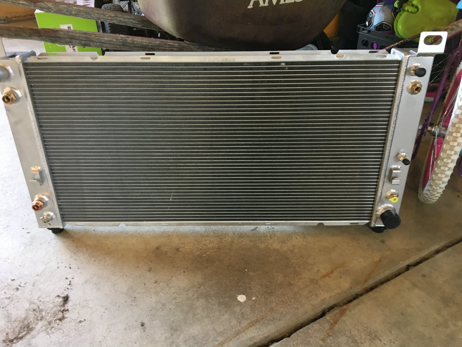

Alright! Looks like a new radiator fixed the issue, fingers crossed! Install was fairly easy. I drove it hard up the pass and didn't budge over 210. I took some pictures and will attach them below.
Here's the new one, it is the one that is linked a few posts back. Seems to be pretty decent. Welds are good and it is a 3 core radiator with transmission and oil cooler hookups.

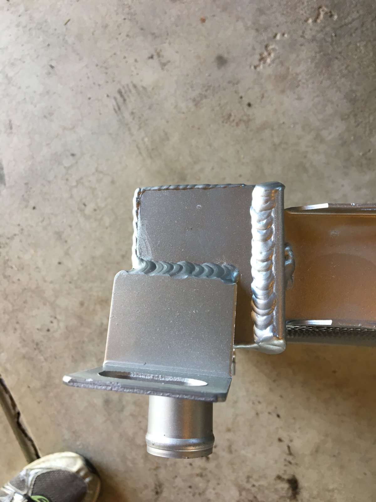

This picture shows the mounting brackets. They are a bit crooked and mounted too far out in my opinion. It made the install a little tough, I had to use a hammer over a cloth to get it to fit all the way in but it worked.
Next is a side by side of how much bigger the new one is compared to the old one. It fits nicely but the fan sticks out about an eight of an inch further than it should, its not really noticeable though. I also didn't notice anything wrong with my old radiator, no damage or anything like that.
Overall I think it was a good swap out for a budget option if you can't afford the Mishimoto.
