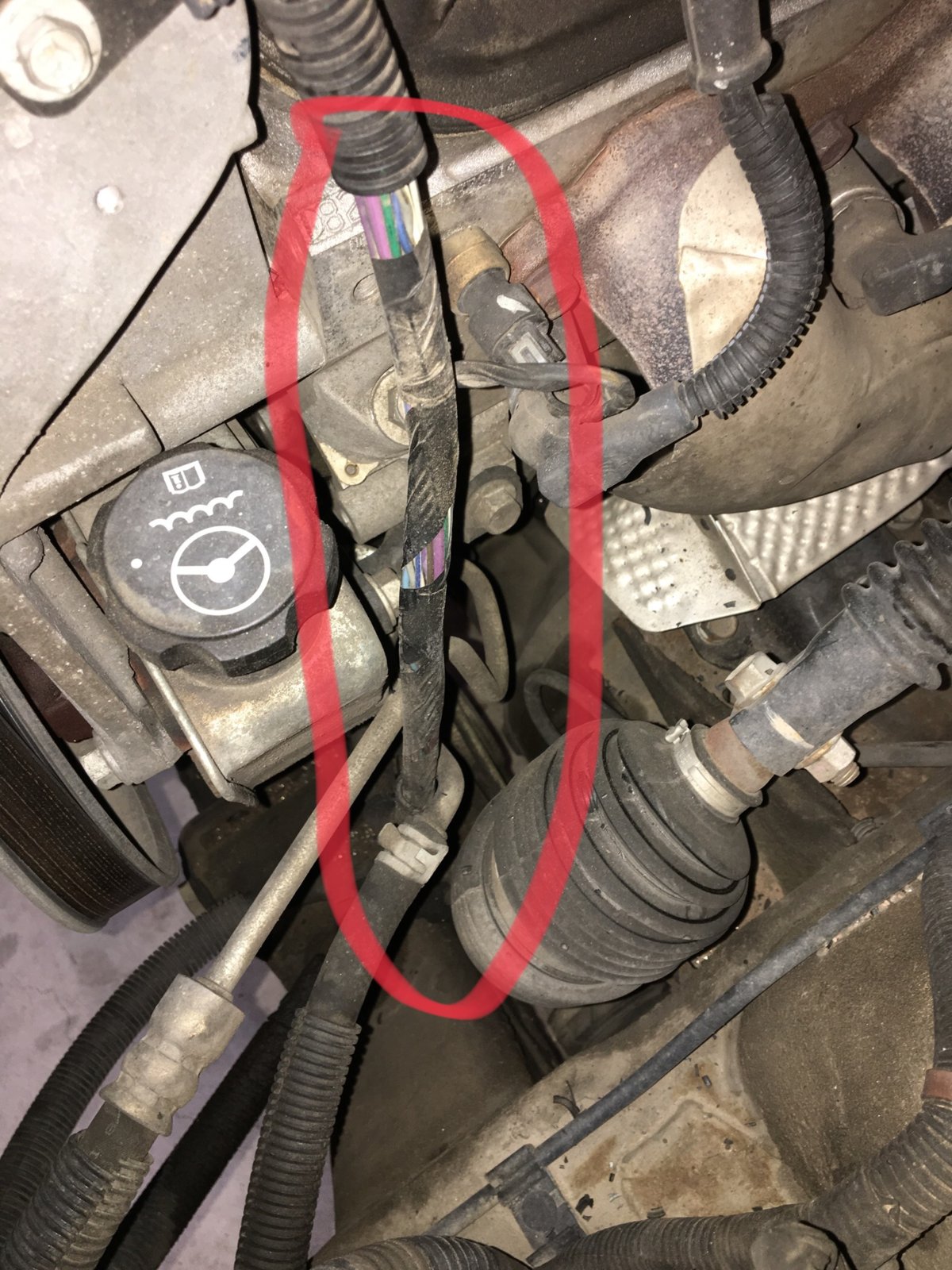

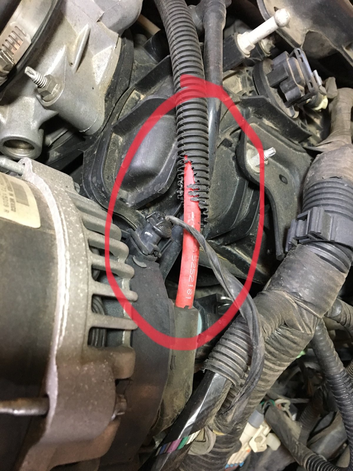

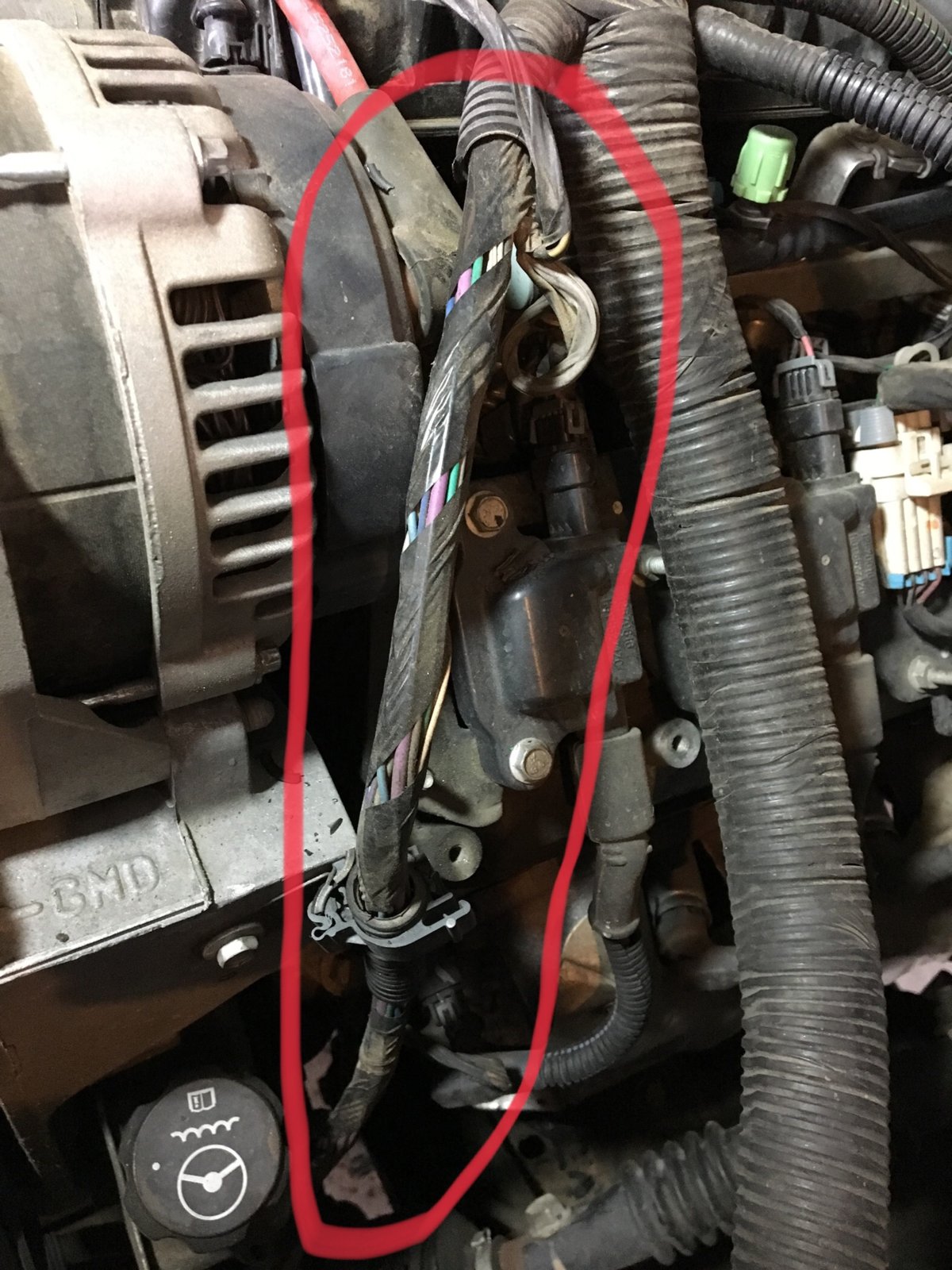

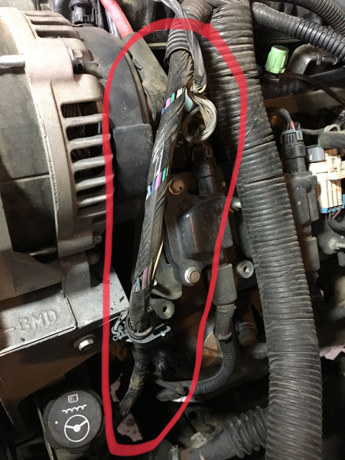

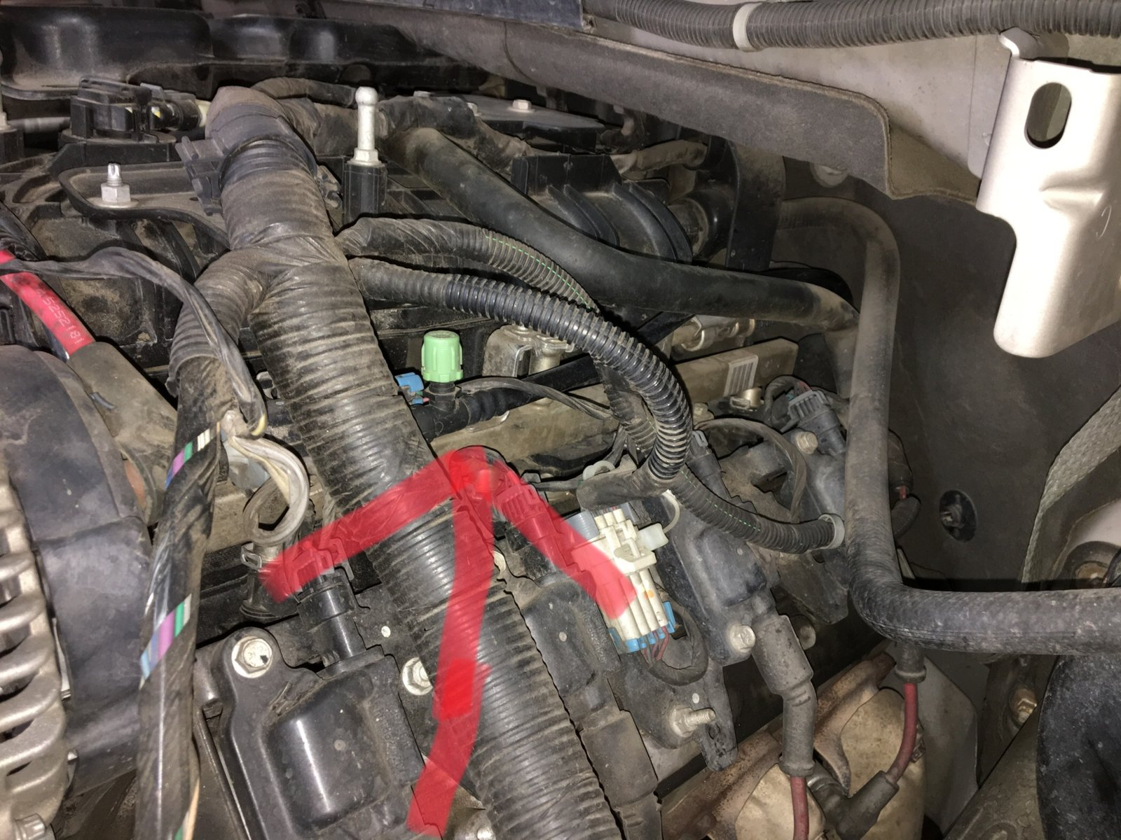

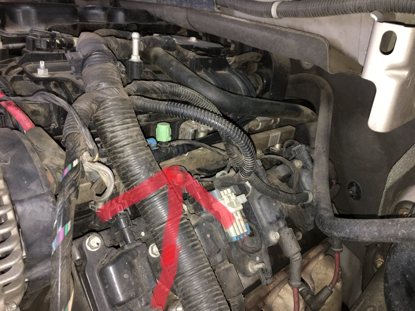

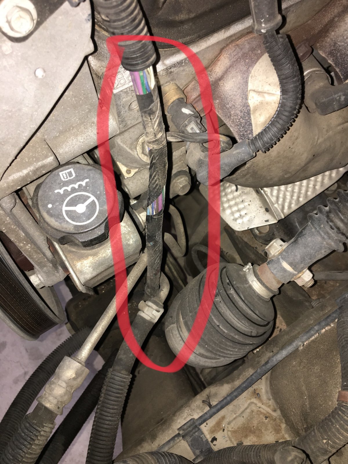

I am in the process of wrapping my fuel lines right now. I attached a picture of the fuel line, just want to make sure I'm doing the right one. It also looks like there is a metal crossover to the other side of the motor. Is this correct?
Also noticed that some wire loom in the area behind the alternator was brittle and crumbled when I touched it is one that looks a bit melted. I recently replaced the alternator but could it overheat to the point of vapor lock?
Also noticed that some wire loom in the area behind the alternator was brittle and crumbled when I touched it is one that looks a bit melted. I recently replaced the alternator but could it overheat to the point of vapor lock? View attachment 201776 View attachment 201777 View attachment 201778 View attachment 201779
The bottom photo is the fuel injection fuel rail which does need to be wrapped. The fuel line runs from the fuel rail down the backside of the engine and over the transmission and also needs to be wrapped.
