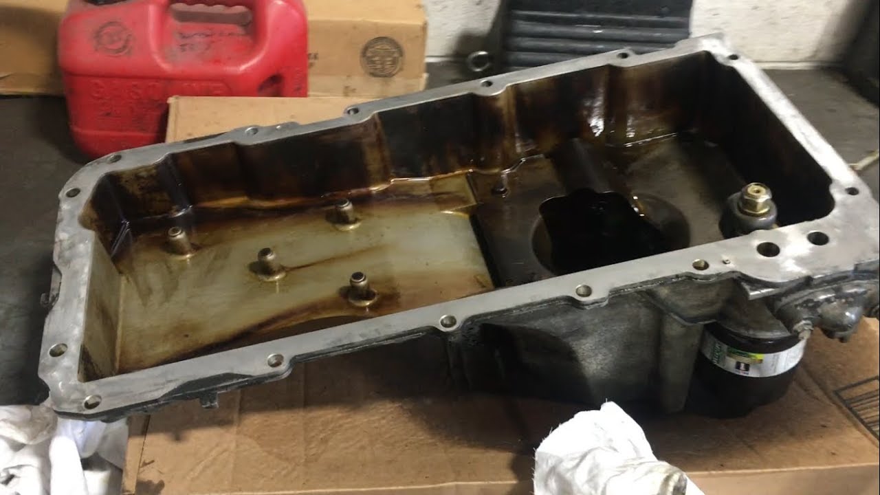

OK, dropped the oil pan.
The pickup tube O ring looks just fine.
Some sludge, but not much in the pan.
The pickup tube is not clogged at all.
Really, everything there looks ok for 190,000.
So? It MUST be the oil pump?
What else COULD it be?
Either high pressure relief valve stuck open, or pump failure.

Another option is you could have incurred a failure in your oil pan gasket. It has some passages cut into it which are sealed off by the gasket. If that suffers a failure and begins leaking internally, you'll end up with low oil pressure.
OK, I am not finding any information on this, but it has me curious as there was some oil pan gasket leak going on....
SnowDrifter
Sep 5, 2016
2,483
2,896
Sasquatch Country
The way the lubrication system is plumbed in these, sends unfiltered oil down through the pan into the filter, then back up, through the pan again, to be distributed through the engine. These passages see full oil pressure .
The gasket has some integrated O-rings but once in a blue moon they can blow out if the pan shifts, was damaged, defective part, or if there was an error during installation.
