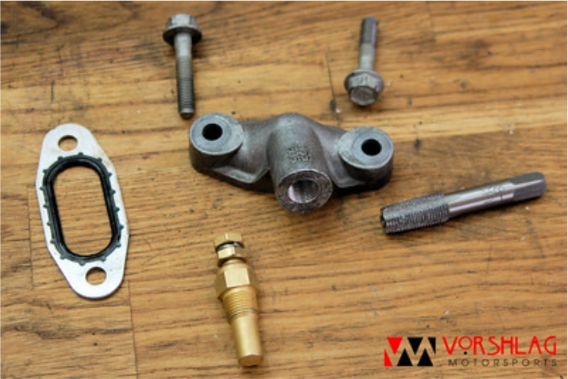

The oil pressure sender is back there on the 5.7L LS1 thats in my 2002 Corvette :(. They fail on these cars too.

I didn't realize they made so many relocating kits. I honestly might buy one next time something goes out haha.
this is off something factory that put the sensor down above the filter. some reason I thought it was a c5. maybe not.
