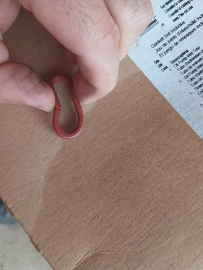

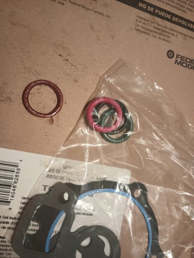

Yes, different sizes for pickup tube O-ring. Best is to remove it and look at the pickup tube. 40 psi oil pressure is excellent, but probably a good idea to replace the o-ring. Here's the o-ring from my 06 Suburban LQ4 engine at 262k. Oil pressure was also 40 psi at idle, but the o-ring was definitely on its way out.
I hope this helps.

And apparently there are 3 different size O-rings for the pickup tube. When I ordered mine 2-3 weeks ago I ordered a new pickup tube just to be sure the screen on the old one wasn't clogged with debris. You can order them together from rockauto.com at a very reasonable price.
