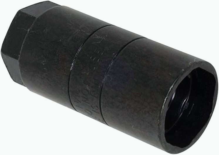

There's a special socket for the sender, one that will fit between it and the intake. Some people have had success with a regular socket, though.
It's not too bad a job with the right combination of extensions and a flex head ratchet.
I actually got this one on Amazon some years ago when I was contemplating replacing it.
Lisle 13250 Oil Pressure Switch Socket​

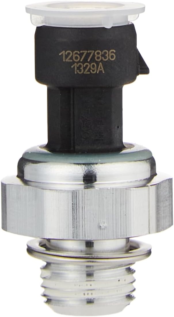

Done. Works great! About the same psi range as old sensor. I used a 1/2" short swivel and 6 inch extension with the Lisle socket which fits the sensor perfectly. I would say buy it because its easy to deform the aluminum housing during installation . Everything was done by feel. Took me 15 min including removing engine cover and bracket. When removing the electrical connector i noticed it was was dry but the sensor was able to rotate and seal was broken. I used brake cleaner to clear sensor area of dirt. I used contact cleaner for the connector.

A google search shows the torque is around 22 pound feet. I noticed that Briggs and Stratton spark plugs that use a similar crush washer are 20 ft lbs. I would go with 20. According to sources, thread sealant is mandatory for no leaks. The sensor above has white sealant pre-applied from the factory. Loctite does make slow cure white thread sealant. Sounds similar to pipe dope used with NPT fittings. It is not the same as thread locker.
