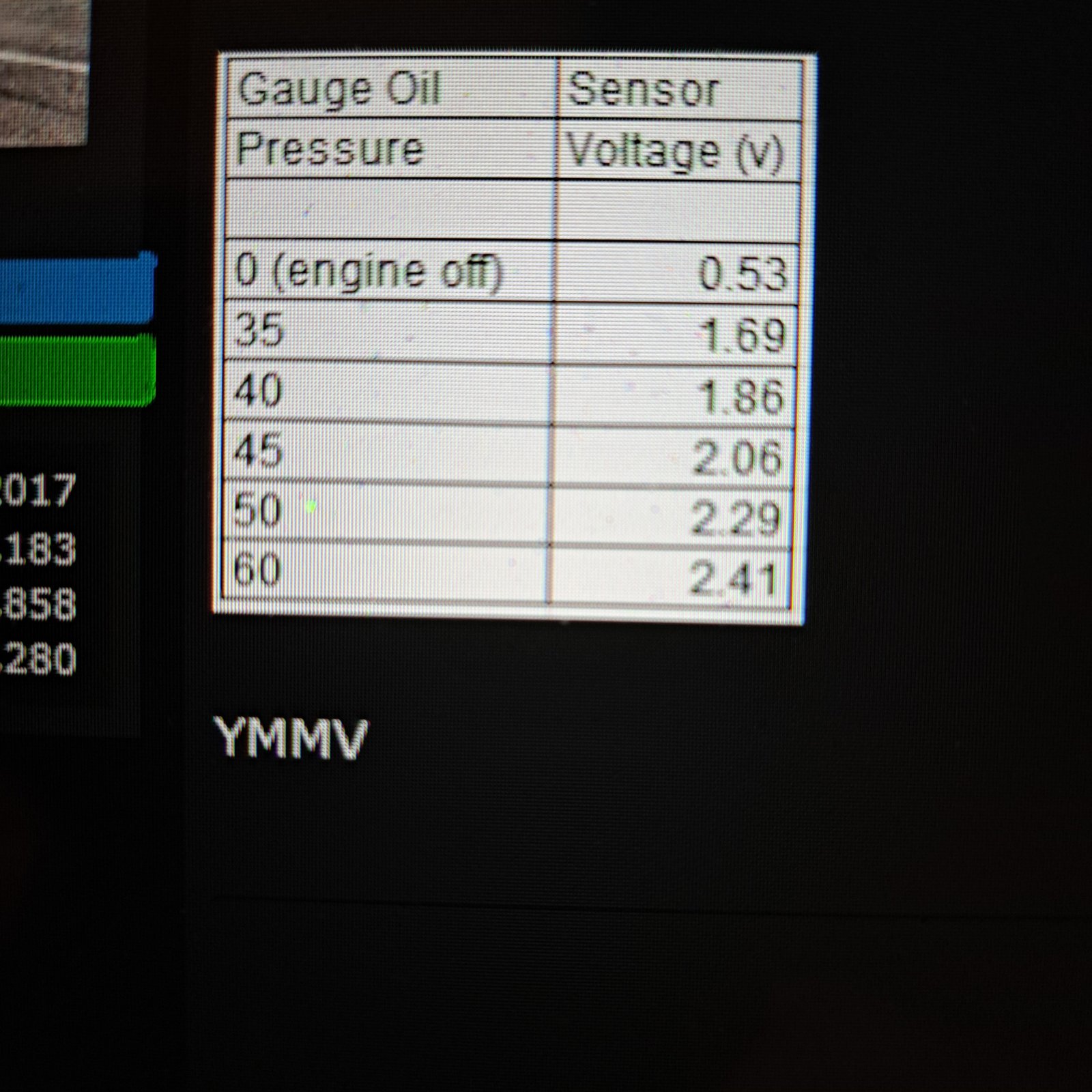

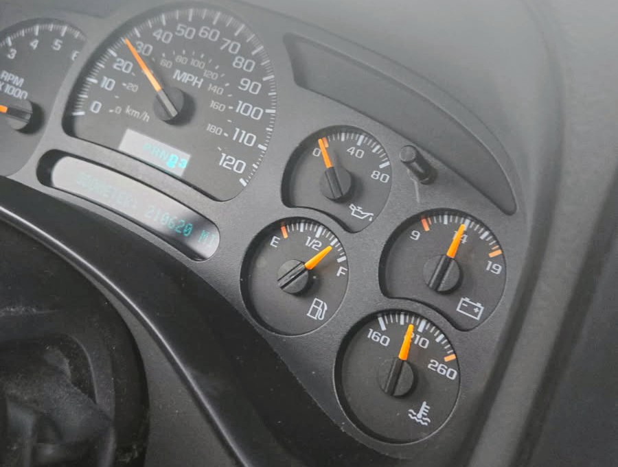

Are we able to upload or attach videos?
Anyway here is a screenshot. Still not working. Will check stepper motors next.
Moderator
16,639
34,442
People's Republic of Colorado
TYF can't host videos, so upload it to YouTube or your choice of hosts, and post a link here.
I'm pretty sure a bi-directional scanner can do a gauge sweep test, if you have access to one.
