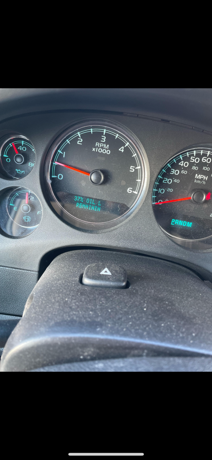

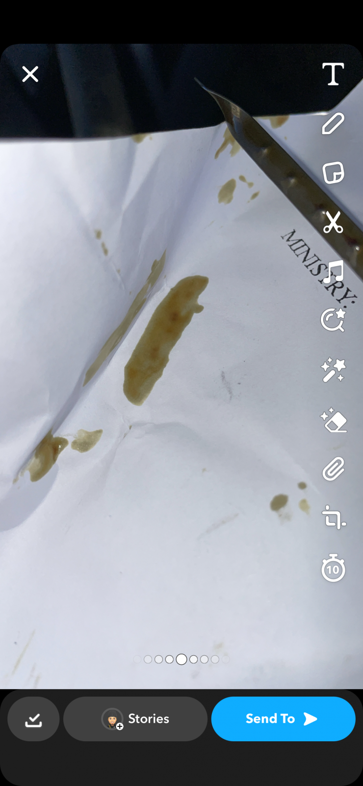

Not sure why the text didn’t upload but:
Oil life seems a bit low for only 1749 miles since last change. (2014 Tahoe)
Changed it at 168,832 miles. 2014 Tahoe 5.3 v8 doesn’t burn or leak oil. I can’t recall oil I used but iit was a decent synthetic brand and I used the right weight and all that. Added the right amount etc. typical oil change. Not to hard can’t really mess it up.
Anyways: for in town driving would this much oil life be acceptable for 1749 miles? I don’t ever travel. Just driving to work and stuff like that. And sometimes I let it idle for a bit to warm up. Maybe 5-10 min. My oil PSI is good too. And inspection on it recently

It used 63% that quickly? When do you normally change the oil? By the monitor (if so what %), or by mileage?
Is it possible the monitor didn't reset and now you are just seeing lower than before? I usually change mine at 5k, which is somewhere around the 40-50% oil life left per the truck. I occasionally forget to reset it, but don't really use it other than a check point.
If you did reset it, then my assumption is that lots of short trips with idle time in cold weather could cause that. There are all kinds of inputs that go into the calculation. The oil looks decent from what I can see.

@iboughtatahoe23 That "oil life monitor" is just a timer, it doesn't actually mean anything.
As long as you can see your dipstick through the oil you are good, if the oil is so dark on the dipsticks that you can't see it then its time to replace it.

I did reset the oil life gauge bc it was at 40% when I changed it last in August and there’s no way it used only 3% in 5-6 months.
Mileage is 170 K and it’s only been five months since I changed the oil and I’ve only put on less than 2K miles. Only factors I can think of is cold weather in the last few months, idling, high miles. Idk.
I changed it at 40% life last time to.
I bought it at 165k in February 23’ had fresh oil done that following march and changed again for 2nd time this last august at 168832 from 165k miles the first time and this time around I have oil life at 37% now in January and only have 1700 miles on the second oil change
Yes to answer your question I do do a lot of short trips and idling and it is really cold here about 20° on average and been dipping below freezing lately. But my oil doesn’t look like 37% oil life?

Do you have remote start? If so, how much are you using it? You're not putting miles on it, but the motor is still running.

Short trips and lack of full warmups will contribute to decreased oil life. I'm not sure what the oil life monitor uses to calculate the percentage, but I would think it would take some of that into consideration. Otherwise it's useless.
Curiosity got the better of me and I found this on another forum:
The GM OLM calculates an OCI based on idle time, engine revolutions, oil temp, coolant temp, ambient temp, oil pressure, and some other things. If it overheats, the OLM immediately goes to zero, upon reaching 260F.
Since the 2010s, GM also started including hard limits into the OLM: most GM cars from the past 10 years or so will have a max OCI of 7500 miles or one year, except the Volt, which has a max OCI of 2 years and no mileage limit. The hard limits probably started when GM introduced dexos oils, after they had some problems with the HFV6 timing chains from long OCI suggestions.
Older pre-dexos GM cars with the OLM didn't have any hard limits programmed into the computer, but suggested not to exceed a year or 12k.

The oil looks fine though. I’m confused guys. Less than 2k miles on the oil and yall say change it? Only thing I can think of is half idling and other half is due to restarts. I try not to let it idle. It is very cold where I am from in northeastern South Dakota
